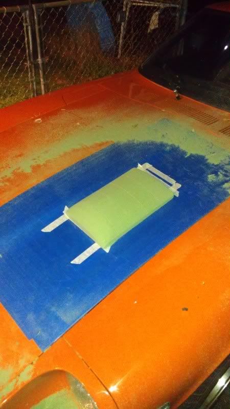

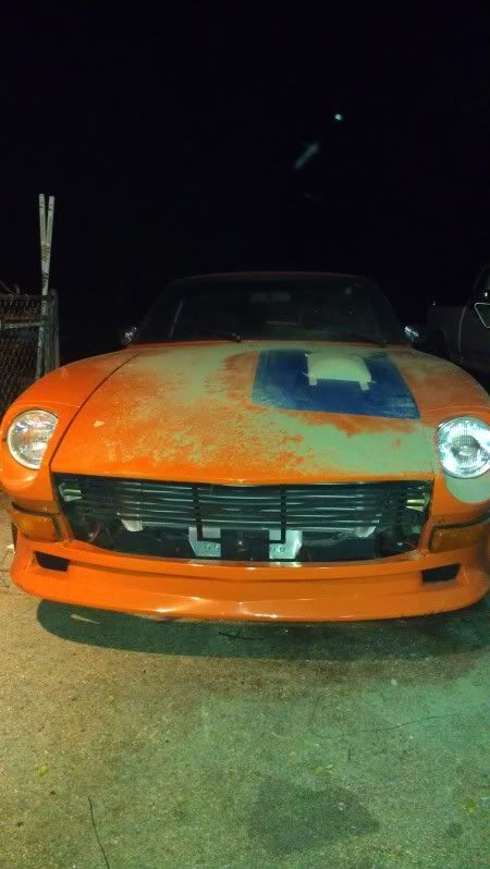

Xnke Posted April 15, 2013 Author Share Posted April 15, 2013 Exhaust manifold is in the machine shop today. There will be hood clearance issues; fortunately they align precisely where I intended to chop holes in the hood and put in vents at a later date. So the vent on the driver's side will get moved up. I will have a minor adventure in fiberglassing, if it looks like crap, well, it'll look like crap. But it'll go like stink, too! Quote Link to comment Share on other sites More sharing options...

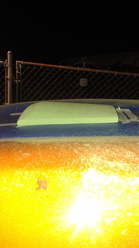

Xnke Posted April 23, 2013 Author Share Posted April 23, 2013 (edited) Ugh, this is worse than bondo dust.Maybe it won't look so bad. Edited April 23, 2013 by Xnke Quote Link to comment Share on other sites More sharing options...

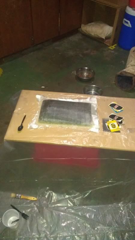

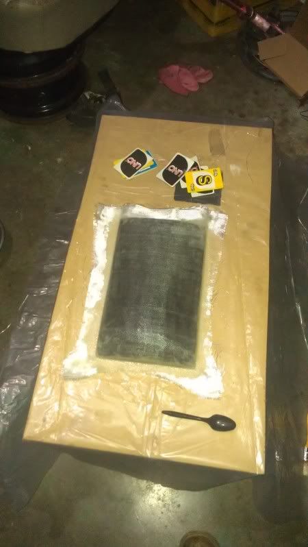

Xnke Posted April 26, 2013 Author Share Posted April 26, 2013 First session of layup. 3 layers of 5.75oz cloth, in Famowood Glaze-coat tabletop epoxy. Only downside to using epoxy is that it has a 24hr cure time.But it is less brittle, a little stronger, and it was readily available. It also doesn't attack foam, doesn't stick to packing tape, and I am well practiced at mixing it.I am working on a vacuum bagging method tonight, to put down the two layers of chopmat that will get sandwiched between another two layers of glass cloth. I had some bubbles between layer 1 and 2, had to go back an fix those. (easy with epoxy, not so easy with polyester resin...) Quote Link to comment Share on other sites More sharing options...
