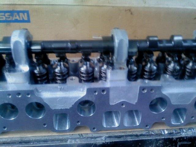

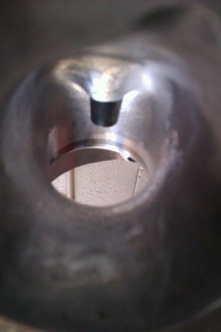

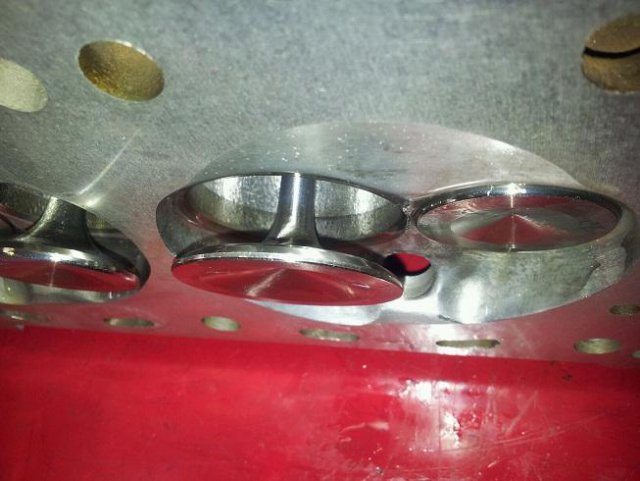

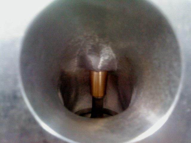

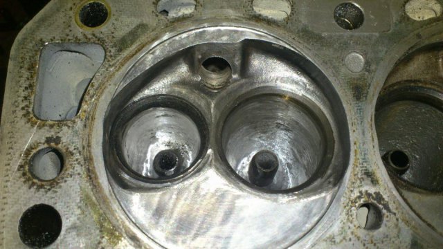

here is one picture i smoothen the valve area and intake runner.
its not ready needs a bit polishing and valve job... but should i do more for combustion chamber?
