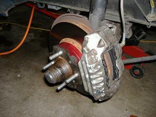

duragg Posted December 30, 2012 Share Posted December 30, 2012 Each rim will be so different. My new S12w swap needed the inner curve of the caliper shaved with a grinder to clear the hub. Wasn't much, and they are free. Tire choices really suck in 15". Basically stops at 225/50x15. Quote Link to comment Share on other sites More sharing options...

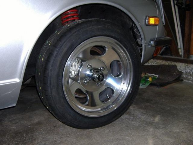

duragg Posted January 4, 2013 Share Posted January 4, 2013 Got my S12w installed last night. For sport I checked and my 14x6.5 "turbine" wheel fit fine. The hub area JUST licks at a caliper fin so I zipped that fin down with a grindr. Quote Link to comment Share on other sites More sharing options...

duragg Posted January 6, 2013 Share Posted January 6, 2013 That was mighty nice of you. This is a great forum! Looking forward to meeting that duragg guy someday. Well, sigh.. you know I only have tires on 2 of my 15x10s at the moment... The 15x10s rub slightly on the caliper as well. I will take a picture tonight of the caliper material removed. I suspect there is plenty of meat on the outside as I didn't perforate yet. Tj Quote Link to comment Share on other sites More sharing options...
