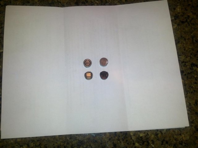

JCan Posted January 14, 2013 Author Share Posted January 14, 2013 Update. I reduced the valve gap to 0.006/0.008" intake/Exhaust. and restarted the engine with no change. Next, I removed the cam followers and lash pads. I noticed the lash pads I removed completely flat on the bottom (as opposed to the stock lash pads which have rather long walls and seem to cuddle the valve. I also noted the lash pads (top side) did not have the groove on either side and the cam follower wore two small lines on either side of the middle of the lash pad. The lash pads measured 0.155" thick. see pictures: Left pictures are the stock lash pads right pictures are the isky lash pads that were installed on my head. Quote Link to comment Share on other sites More sharing options...

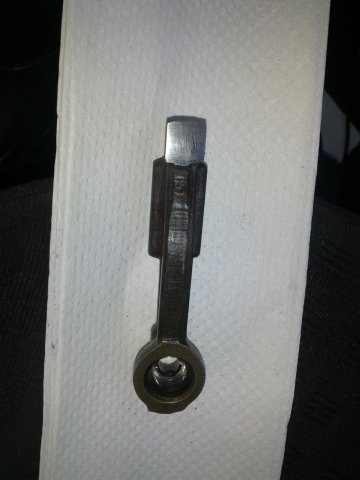

PMC raceengines Posted January 14, 2013 Share Posted January 14, 2013 take a pic off the rocker tip for me please Quote Link to comment Share on other sites More sharing options...
JCan Posted January 14, 2013 Author Share Posted January 14, 2013 Seems like the rocker arms are only touching the lash pads at the sides... right? Quote Link to comment Share on other sites More sharing options...
PMC raceengines Posted January 14, 2013 Share Posted January 14, 2013 Yes there not flat , i would have them re surffaced , its not dear get isky to do them or any cam shop , id say your valve clearance is not what you think as the rocker only has point contact , have them done and it will be quiet Quote Link to comment Share on other sites More sharing options...

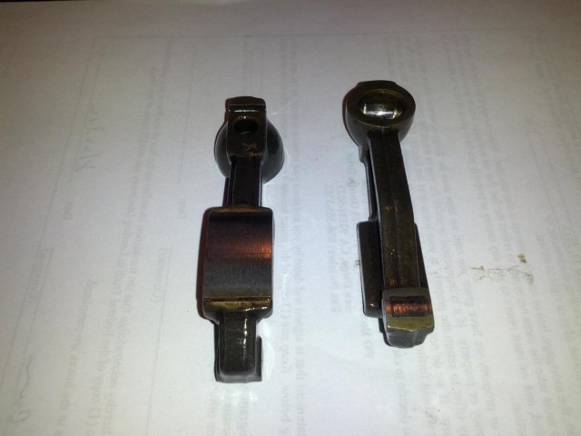

JCan Posted January 15, 2013 Author Share Posted January 15, 2013 Update! I took the rocker arms to the head builder and showed him the tappet wear and the matching rocker arm wear. He was of the opinion that this was not the problem but did grind the rocker arms so that they would naturally touch the center of the lash pad instead of the edges as shown above. (picture of modified rocker arm, orig rocker arm, and lash pads -attached). We're pealing the onion here... First steps, reinstall cam lash pads and rocker arms. Blue (sharpie marker on the pad where the rocker arm comes in contact with the cam) rocker arms and check each rocker arm / cam surface to ensure the arm is properly mating to the cam. While I am doing this be sure to check the rocker arm is pushing the valve in the proper place. Next, with the engine cold, gap both intake and exhaust valves at 0.008" Next, start the engine, let it warm up, turn it off and regap intake and exhaust valves at 0.008 intake and 0.010 exhaust Start engine and see if it is quieter. If I still have a problem, I have located an old valve cover and I am going to cut the top off, mount it to the head and run the engine to see if I can tell which valve is making the tapping noise. Next steps if the noise persists, is to swap my beautifully rebuilt P90 head with squish to a N42 head ... sigh... Jim Quote Link to comment Share on other sites More sharing options...

Xnke Posted January 15, 2013 Share Posted January 15, 2013 Any lash pad thicker than 0.120" is usually a flat-bottom lash pad. That's completely normal. Does the tapping sound track crank speed, cam speed, or valve speed? Quote Link to comment Share on other sites More sharing options...

JCan Posted January 15, 2013 Author Share Posted January 15, 2013 Good news! Car is working!!! little to no head noise! Alright, what caused the issue. Rocker arm to cam gap was not correct. Why? Remember the lash pad marks? one on each side of the lash pad with nothing touching the center of the pad. What would happen if the planes defined by the cam lobe/rocker arm was not parallel with the lash pad/rocker arm plane? If the rocker arm was soft, it would cause the rocker arm to twist until the two planes are parallel? I believe this was my problem. Once I had the portion of the rocker arm that touches the lash pad ground down do that it touches the lash pad on one spot and in the center of the lash pad, I could accurately adjust the valves. (note: during adjustment prior, the rocker arms seemed to rock, now they are steady) I re-assembled the head, and was careful to gap the exhaust/intake at 0.010"/0.008" respectively. Started the car, and warmed up the engine (the engine was a bit quieter, however it was still loud). once the fan kicked on, I turned off the engine and re-gapped the valves. Started the engine and WOW it is running quietly now! YEA! Thanks very much for everyone who took the time to help me on this thread.!!! Jim Quote Link to comment Share on other sites More sharing options...
