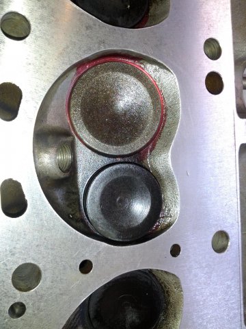

I made a mistake!  When I was cleaning the head with acetone I noticed a very small collision in cylinder no 3 (pictures  below)
It looks like a very small piece of sand was on the piston and crashed into the head and made a divot.  I have decided to place two head gaskets on top of each other and reassemble the engine and start it to see if the rattle goes away.  If it does, it means that my clearance between piston and head is too close.  If it does not, then the problem is probably the cam/rocker arm/ lashpad area.
