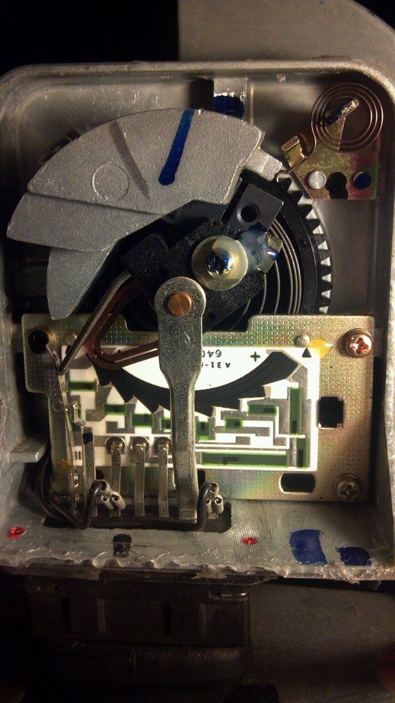

OldAndyAndTheSea Posted January 5, 2013 Share Posted January 5, 2013 (edited) Sounds like the air flow meter is to blame. If the car will run if you pour gas in the manifold, you obviously have spark. So rule that out. The AFM does a couple of different things. First, it controls fuel pump operation. Check to make sure this works. Remove the air filter boot from the AFM and physically push the flapper open with the ignition on. You should be able to hear the fuel pump running. The second thing to air flow meter does, is exactly what it says: Measures the air entering the intake, this is how the ECU "knows" how long to keep the injectors open etc... The internals of your AFM should look identical to the picture below. The fuel pump contact points often times get dirty, and require a little cleaning to make work again. But the problems you've described indicate to me a Air Flow Meter problem. That's where I'd start. Here's a picture of the internals of my 1976 AFM. The fuel pump contact switch is located on the middle left (there is an arm pointing to about the 7-8 'o clock position.) Make sure the connection between the two metals is clean and unobstructed. Edited January 5, 2013 by OldAndyAndTheSea Quote Link to comment Share on other sites More sharing options...

wesmc Posted January 19, 2013 Share Posted January 19, 2013 OOATS- pic is great for reference. I keep a known good one with the cover off that I can physically watch operate to help me when doing diag. Quote Link to comment Share on other sites More sharing options...
