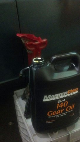

duragg Posted January 16, 2013 Author Share Posted January 16, 2013 (edited) Trying the other end of the spectrum for scientific analysis purposes. Edited January 16, 2013 by duragg Quote Link to comment Share on other sites More sharing options...
duragg Posted January 16, 2013 Author Share Posted January 16, 2013 Improved with O'Reilly GL4-140 Still grinds some at 7000 shift into 2nd, but less and goes in quicker. Can live with it till it breaks. Quote Link to comment Share on other sites More sharing options...
