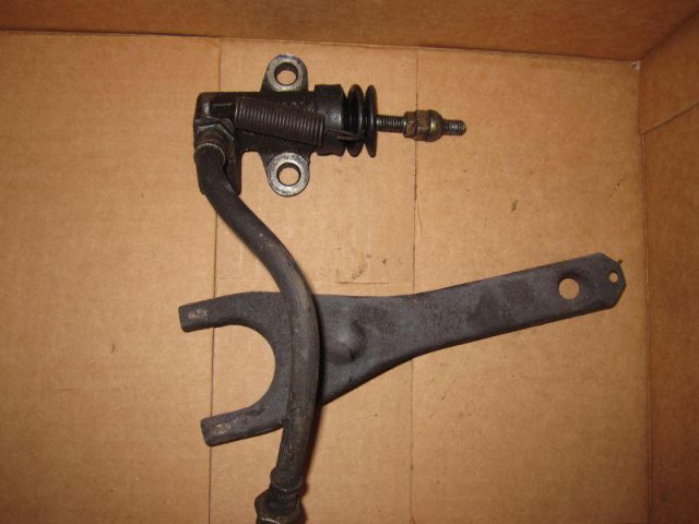

JMortensen Posted January 28, 2013 Share Posted January 28, 2013 (edited) Allows you to fine tune the engagement height. You wouldn't use the slave as it has been sitting around for 8 years and probably isn't working (although it has low miles on it). The pin and spring can be put on any slave, and you would need the throwout fork obviously. Here is a picture: EDIT--BTW the steel forks might be on the earlier 4 speeds and 5 speeds. I know guys were double pinning them and safety wiring the pins in. I think the aluminum can wear and doesn't hold the pin in as reliably. Dennis Hale suggested running safety wire right through the roll pin and around the shaft to hold it, and that's easy enough to do. Edited January 28, 2013 by JMortensen Quote Link to comment Share on other sites More sharing options...

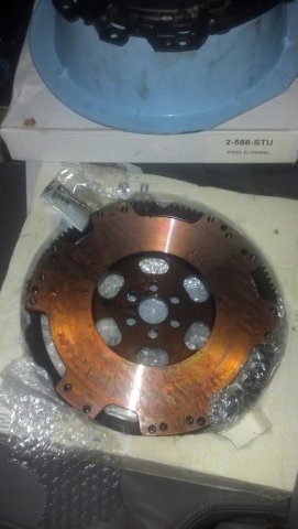

duragg Posted January 28, 2013 Author Share Posted January 28, 2013 I did order a new 1/2 fork and just guessed on the year since I don't have the VIN of the donor. Also going to pick up an Arizona Zcar flywheel later today. 12lbs. I already am using his clutch. Try to support local vendors where I can and the quality looked great last time I was at his house. http://www.arizonazcar.com/clutch.html Now that I know how better to measure syncros and what to pay attention to I think this rebuild will be a lot better than last. I understand the box better now. And can pay more attention to the things I want to improve. Quote Link to comment Share on other sites More sharing options...

AZGhost623 Posted January 29, 2013 Share Posted January 29, 2013 That AZ Z Car flywheel and clutch plate looks exactly like mine... That puck is not what I went with, looks like a stage 3 or 4 puck. I wonder if he sources his parts from competition clutch, thats where I got all my parts. I had my transmission rebuilt here locally, and they used the GM Syncromesh fluid. It will be interesting to see how much difference there is in our cars since they will be similarly setup. So when I see you on the track Duragg next month, Ill know all your secrets... unfortunately you know mine too lol Quote Link to comment Share on other sites More sharing options...
duragg Posted January 29, 2013 Author Share Posted January 29, 2013 Yep, sure does look the same. Im sure I just paid twice what you did for the same exact part. Oh well, Daves a good dude and just a short drive to pick up is nice. Cash discount... he likes that. Going to drop at Superfinishers tomorrow and let Mike verify its nice and true then get the F/W, disk and PP bolted back up. Then focus on fixing the tranny. Then full circle back to the top of this thread and pour the juice back in... Think you will be running by the February NASA meet? That would be great, but you probably won't want to Flog the crap out of your motor like I was doing. Quote Link to comment Share on other sites More sharing options...
AZGhost623 Posted January 29, 2013 Share Posted January 29, 2013 Ya, same part number and everything from that photo. Exactly how it came out of the box. Looking back on my records I paid $275 for the flywheel and $300 for the stage 2 clutch kit. I was on a major budget on the amount of things I needed to get so I had to stretch everywhere I could. I looked at AZC but they were way out of my price range unfortunately. I am pretty sure if I can get this gas tank problem settled, Ill be on my way for sure. Its the only thing stopping me now. My goal is to be at the next event with this car. Yes, I need atleast a 500 mile break in. Maybe a cruise is in order up to Globe or Flag and back. I am very curious how your tooth mod is going to turn out. Not sure I understand everything being said/done, but I find it interesting none the less. More to learn... Quote Link to comment Share on other sites More sharing options...

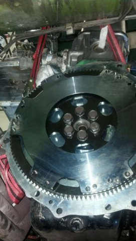

duragg Posted January 30, 2013 Author Share Posted January 30, 2013 (edited) Could use a second set of eyes here. RMS and freeze plug dry. Plate on Flywheel on with dowels located and pressed. Torqued to 107ft lbs per 1983 FSM with a little bit of Med Loctite. I think I got it all? Edited January 30, 2013 by duragg Quote Link to comment Share on other sites More sharing options...
