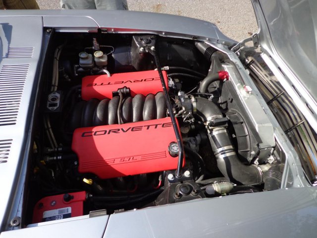

PLATA Posted February 9, 2013 Share Posted February 9, 2013 (edited) My original Z gauges are adapted to the LS1 harness , but the 40+ old yr temperature gauge is erratic and I don't want to fool with the original gauge or the connection. Is there a way to plug a gauge to my aluminium radiator and have it under my dash. Please advice. Thanks Edited February 9, 2013 by PLATA Quote Link to comment Share on other sites More sharing options...

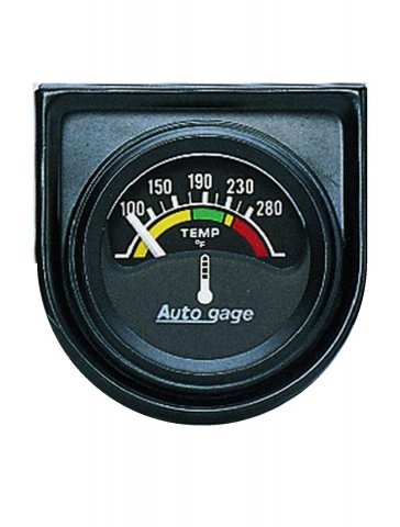

heavy85 Posted February 10, 2013 Share Posted February 10, 2013 (edited) I bought a 'from a top Nascar team' used wide sweep Autometer from e-bay then a sender to fit the LS. The sender goes in the port towards the back of the passenger head. Hint its metric. Cameron Edited February 10, 2013 by heavy85 Quote Link to comment Share on other sites More sharing options...
RebekahsZ Posted February 10, 2013 Share Posted February 10, 2013 I'd get a used gauge from somebody on the forum if you like the look. I used a sharpie pen and made a dot on the gauge to show how hot it got after the first startup. That became "normal operating temp" for the ls1. It never has exceeded that mark. Cheap and simple. Quote Link to comment Share on other sites More sharing options...
cheesepocket Posted February 18, 2013 Share Posted February 18, 2013 I took out the plug toward the back of the passenger side head and used the following to allow monitoring of temp in the head with an electric temp gauge: Autometer 2259 sending unit Autometer 2277 M12 to 1/8 NPT adapter Autometer 3421 electric water temp gauge, 2 5/8" You can't use the standard sender that comes with the gauge as it's too long. I got all this info off the LS1tech website and it was very straightforward and has been working fine. Quote Link to comment Share on other sites More sharing options...

SUNNY Z Posted February 22, 2013 Share Posted February 22, 2013 You can just use a temp probe from a 98 ls1. They have a 3rd wire that you can hook up to a gauge. Keeps with the factory look and function. One less wire to deal with. Quote Link to comment Share on other sites More sharing options...
PLATA Posted February 22, 2013 Author Share Posted February 22, 2013 (edited) GuysTHANKS, the LS1 adaptor/sending unit and gauge are on the way, she will have two gauges, the erratic OEM old Datsun Z temperature gauge and a new one connected to the block on the passenger side, with a mini gauge under the dash . Easy and simple solution , I use the A/C to keep me cool and this will make sure that she is also running at normal temp Edited February 22, 2013 by PLATA Quote Link to comment Share on other sites More sharing options...
