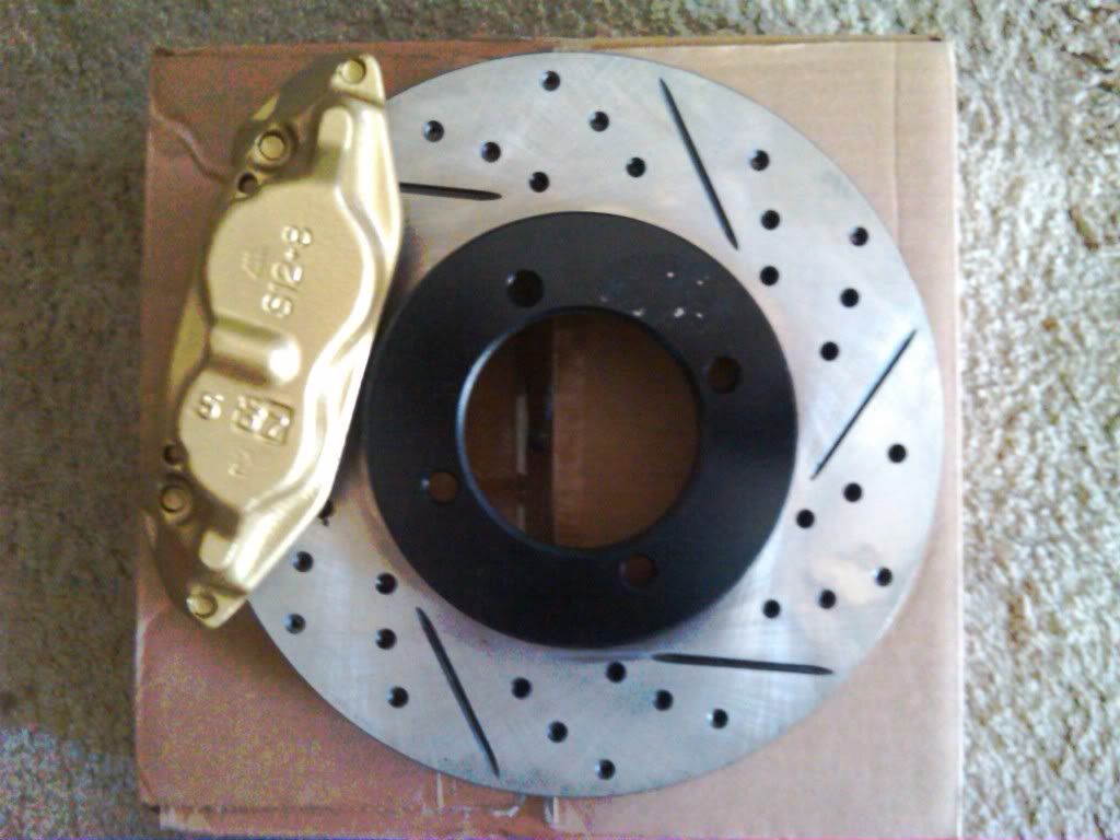

Is this for the turbo build?  If you are going to track it I would go with the slotted and vented disks like these:
http://www.silverminemotors.com/Front-Big-Brake-Kit-stage-4-Front-Big-Brake-Kit-Stage-4.htm
This is what I have.  Ryan can tell you how well they work on the track...
That's what I ended up getting from Silvermine.  Packaged arrived complete with the 15/16 Master set-up.  That in combination with the rear disc set-up should be good for the turbo build.  Ryan is focused on is 240SX LS drift car at the moment.
