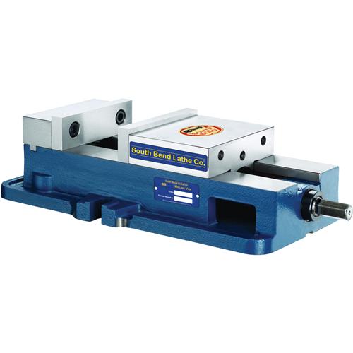

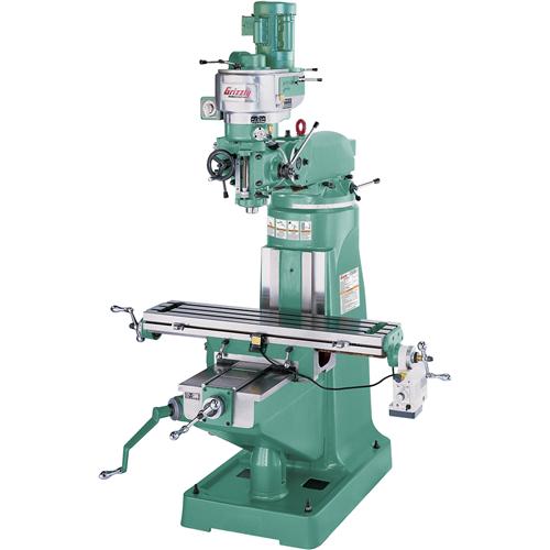

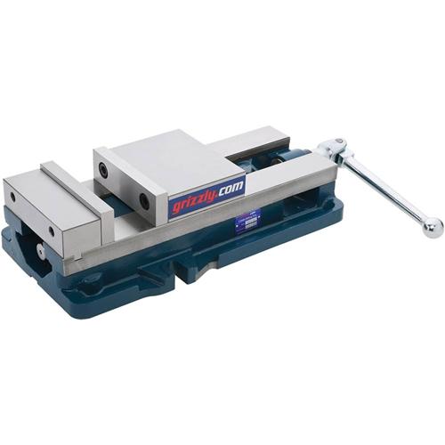

grumpyvette Posted March 4, 2013 Share Posted March 4, 2013 (edited) I doubt very many guys on the site own milling machines but many probably own a good drill press, and as anyone who owns either knows a good mill vise is about mandatory to allow you to drill or machine parts and that vise must be solidly bolted or clamped to the machine. in my shop I sold my larger drill press and purchased a true mill, similar to this It came with a mill vise that looks like this one below but its max open jaw spread is a bit over 3" and I need a larger mill vise that will open a minimum of 6.5" http://www.grizzly.com/products/6-Lockdown-Milling-Vise/SB1250 Id also prefer a large vise thats able to be set to hold angles if I must spend a great deal of cash BUT AT $560 PLUS ITS A QUITE a BIT MORE EXPENSIVE THAN I REALLY WANT OR CAN AFFORD TO PAY so Im asking for ideas Edited March 4, 2013 by grumpyvette Quote Link to comment Share on other sites More sharing options...

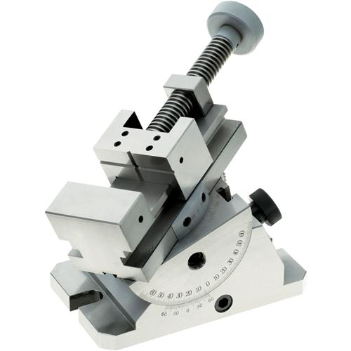

Rival5 Posted March 7, 2013 Share Posted March 7, 2013 For a personal use milling vise I would go with a Jergens 80075 manual 6" vise. Its $515 retail, I use then in production fixturing and have had good experience with them. If you have the money Kurt vises are great but your starting at $1000 for a 6" manual vise. For angle cuts you can angle the head of the mill or get a sine vise depending on the accuracy that you need. I wouldn't get a sine vise for your main vise, they are not rigid enough for daily milling jobs. Quote Link to comment Share on other sites More sharing options...
