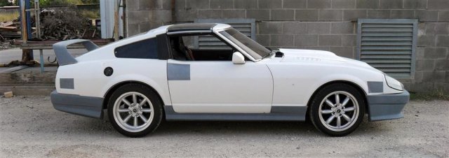

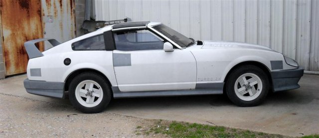

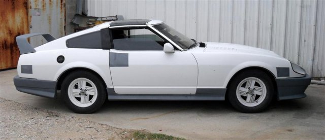

Domzs Posted March 9, 2013 Author Share Posted March 9, 2013 I have done this before on my 83 ZXT . After i converted it to LS1 w/ 6 spd , gutted the dash , replaced bumper reinforcements with lighter brackets to hold the body kit . I cut a coil off at each corner to get it back to its normal ride height . Ride is a little harsh , not bone breaking . The rear is not as stiff as the front and it reduces a lot of squatting during launch . The Z and ZX coils are not the same . I just need to know the amount of lowering with 1/2 a coil cut and 1 coil cut and so on . As you can see the above photos , after LS1 conversion , the front looks like a 4x4 . I just want to close the gap between the tires and the fenders . I went with larger tires , 25" diam. , to gain some ground clearance and narrow the gap by 1/2 " . The exh. sys. is low due auto trans. swap . Here are before and after pic. of the ZXT . Last one is a photoshop ( when she's done ) Quote Link to comment Share on other sites More sharing options...
