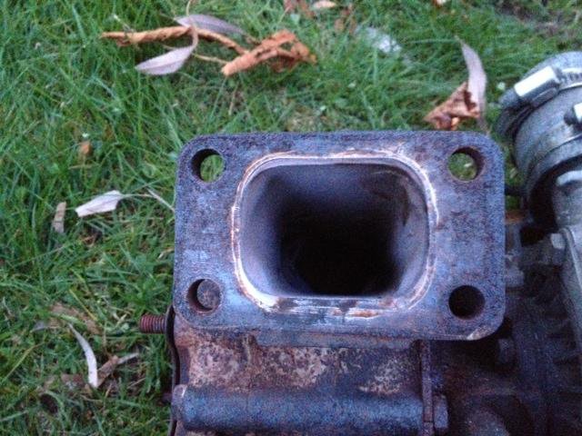

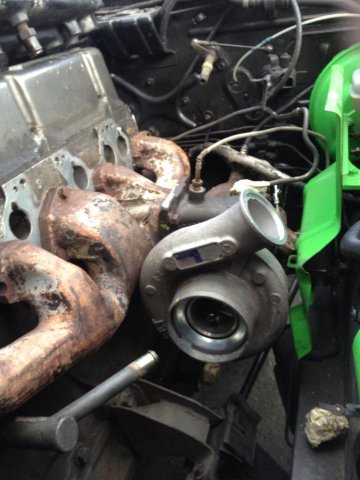

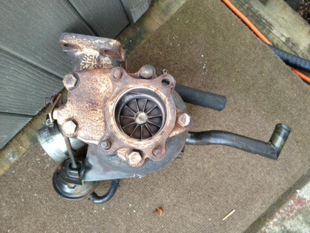

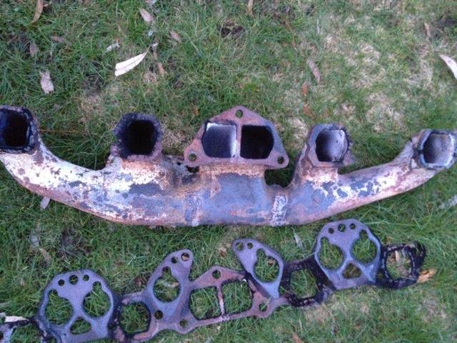

MaTTSuN Posted March 23, 2013 Share Posted March 23, 2013 Weekend projects are great, Mine started with taking the turbo and exhaust manifold off to fix the exhaust leaks Then i found out that the turbo had allot of shaft play... Not putting that back in. I have a Holset HX35w that ive been waiting to put in so no big deal, just a bunch of fab work Looking in the exhaust ports i found that ports 1,2,4 are white and 3,5,6 are black Also the inlet and outlet on the turbo are white so the leanness is winning by the time it hits the turbo I've been trying to lean out my regular driving AFR's with my mega squirt 14:1 out of boost 12ish in boost Do you think i have bad injectors or just a bad tune? the white exhaust scares me a little My fuel rail looses pressure as well so i have been suspecting i have leaky injectors as well, im going to pressurize the rail with the manifold off the engine to check that and see what happens maybe the same injectors are leaking... Matt Quote Link to comment Share on other sites More sharing options...

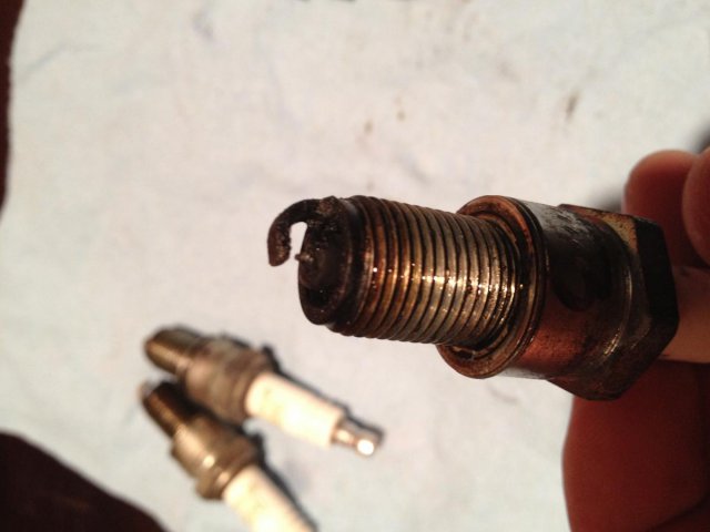

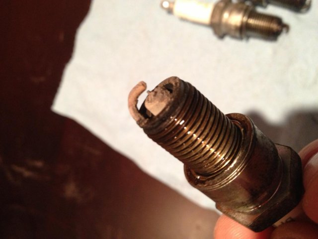

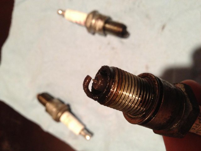

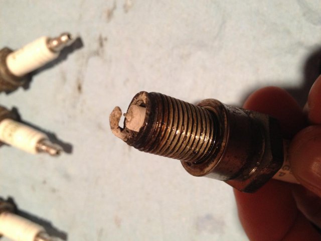

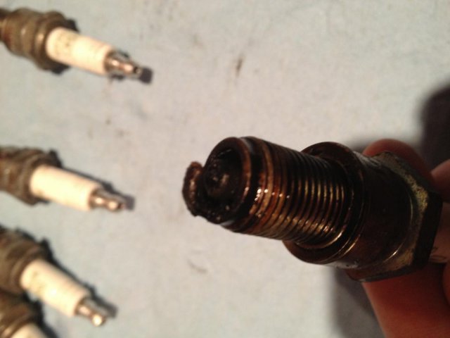

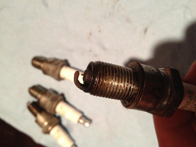

MaTTSuN Posted April 10, 2013 Author Share Posted April 10, 2013 FINALY pulled the plugs today, 1,6 are white and the rest are black & oily.... Check it out feels odd showing my dirty spark plugs hahaha they dont look good doc Quote Link to comment Share on other sites More sharing options...
MaTTSuN Posted April 10, 2013 Author Share Posted April 10, 2013 i took them off in the rain so some of those drops "could" be water Quote Link to comment Share on other sites More sharing options...
Metro Posted April 10, 2013 Share Posted April 10, 2013 White exhaust, clean ports, and white plugs; sounds like a blown HG. Quote Link to comment Share on other sites More sharing options...
MaTTSuN Posted April 11, 2013 Author Share Posted April 11, 2013 its not consistant tho there is no smoke from the exhaust no milky oil everything seamed to run fine before i shut it off if you look at my exhaust ports at the top 1,2,4 are white but the plugs tell a different story 1,6 are white and 2,3,4,5 are black... Quote Link to comment Share on other sites More sharing options...
Metro Posted April 12, 2013 Share Posted April 12, 2013 I was just tossing in my two cents. I just replaced the head gasket on my L28et after experiencing similar issues. Car ran well, the AFRs were good, and the oil was clean, but it would occasionally puff some white smoke/steam at idle. After pulling the head off, the metal ring on the #1 cylinder was cracked down by the water jacket and oil passage. It wasn't a catastrophic failure, like you would think it would be, just enough to cause problems. I never bothered looking at my exhaust manifold, but I think they were all nice and carboned up. You can try looking in the plug holes and see it there's anything unusual. My #1 cylinder had some wet goop on top of the piston (and that plug). Quote Link to comment Share on other sites More sharing options...
Xnke Posted April 12, 2013 Share Posted April 12, 2013 Looks like 1 and 6 are showing detonation damage, 2,3,4,5 are showing a rich condition. New set of plugs in, swap injectors on 1 and 6 to 2 and 3, drive it around a little and see if it chews up another set of (expensive, since you're using iridiums) plugs. The standard copper-core plugs work just as well as anything else I've tried in my L and the turbo L here. I've got a set of single platinums in there now that are currently there for "testing" purposes...so far I'm getting worse mileage with the platinums than with my old copper-cores. Could just be some silly tuning; which is also always possible with me... Quote Link to comment Share on other sites More sharing options...
MaTTSuN Posted April 13, 2013 Author Share Posted April 13, 2013 Interesting, Im temped to pull the head of for further investigation and just swap the head gasket for good measure. If i go that far and everything looks ok i may just re ring the pistons while im at it... Head gasket is only a couple years old and i havent put allot of miles on it so ill prob leave it as is and keep a closer eye on the plugs I tried the iridium plugs but didn't notice anything better as far as performance, ill go back to reg plugs when everything goes back together. For the injectors im going to get them cleaned, we will see how much crap comes out of them. Ill be sure to post picture of the cleaning. I have head studs so ill re-torque everything down a little tighter as well and see how it goes Id like to upgrade my ignition to EDIS as well but thats after the basics are sorted Matt Quote Link to comment Share on other sites More sharing options...
