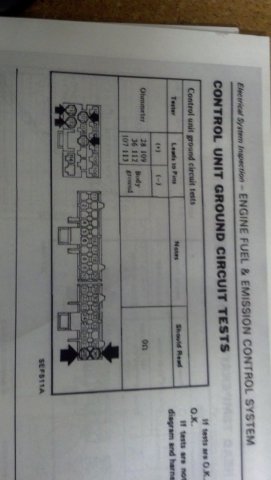

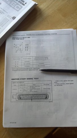

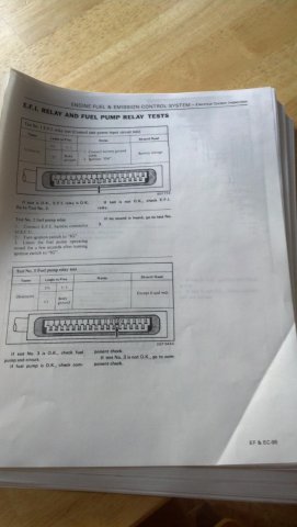

cgsheen Posted March 28, 2013 Share Posted March 28, 2013 On 3/28/2013 at 3:01 AM, daddydonuts said: 27 then, it failed that test, plus my fuel pump pin test...I get voltage at the coil, and none on the plugs... to me, if I'm correct, the ECU is the problem. I don't think you've provided enough information for anyone here to actually determine: "to me, if I'm correct, the ECU is the problem." "27 then, It failed that test" - Meaning? - Does it read battery voltage on ECU pin 27 when you turn the ignition switch to ON? - Does it read battery voltage on ECU pin 35 when you turn the ignition switch to ON? - Does ECU pin 114 have constant battery voltage? - Every GND connection (ECU pins 107,109, 112, 113, 36, 28) is properly connected to only GND? - Does the green LED inside the ECU case come on when you turn the ignition switch to ON? ( there is a hole on one side of the case from which the LED should be visable) "plus my fuel pump pin test..." - Well, if all the above is TRUE, and all the voltage and GND tests are normal, AND you get no green LED light from the ECU, then go no further. You won't get the fuel pump signal for ~5 seconds at IGN ON. The ECU controls the fuel pump so if the ECU doesn't "come to life" neither will the fuel pump. Quote Link to comment Share on other sites More sharing options...
daddydonuts Posted March 28, 2013 Author Share Posted March 28, 2013 On 3/28/2013 at 5:31 PM, cgsheen said: I don't think you've provided enough information for anyone here to actually determine: "to me, if I'm correct, the ECU is the problem." "27 then, It failed that test" - Meaning? - Does it read battery voltage on ECU pin 27 when you turn the ignition switch to ON? - Does it read battery voltage on ECU pin 35 when you turn the ignition switch to ON? - Does ECU pin 114 have constant battery voltage? - Every GND connection (ECU pins 107,109, 112, 113, 36, 28) is properly connected to only GND? - Does the green LED inside the ECU case come on when you turn the ignition switch to ON? ( there is a hole on one side of the case from which the LED should be visable) "plus my fuel pump pin test..." - Well, if all the above is TRUE, and all the voltage and GND tests are normal, AND you get no green LED light from the ECU, then go no further. You won't get the fuel pump signal for ~5 seconds at IGN ON. The ECU controls the fuel pump so if the ECU doesn't "come to life" neither will the fuel pump. If this test fails FSM says replace control unit, see the consecutive FSM pages below. My fuel pump works when I hard wired it from an accessory switch... Quote Link to comment Share on other sites More sharing options...
cgsheen Posted March 29, 2013 Share Posted March 29, 2013 Ouch... Your topic title says "83 Stock Turbo". The pages you show are for the EFI 280ZX. You should be in the ECCS Section of the FSM if you have a turbo model (280ZX Turbo)! And that's the pinout I have been refering to - the ECCS ECU. The N/A car is also fuel injected but it has a completely different computer (ECU) and engine management system than the Turbo! "EFI" is for the normally asperated engine. "ECCS" is for the turbocharged engine. If your ECU connector looks like the pictures you posted, the harness is from the EFI (N/A) version and can't be used to run the stock turbo engine. The ECCS (turbo) ECU has 3 seperate plugs (black plastic) that go into the side of the ECU, not a single long plug like the EFI ECU... Quote Link to comment Share on other sites More sharing options...
daddydonuts Posted March 29, 2013 Author Share Posted March 29, 2013 On 3/29/2013 at 9:57 PM, cgsheen said: Ouch... Your topic title says "83 Stock Turbo". The pages you show are for the EFI 280ZX. You should be in the ECCS Section of the FSM if you have a turbo model (280ZX Turbo)! And that's the pinout I have been refering to - the ECCS ECU. The N/A car is also fuel injected but it has a completely different computer (ECU) and engine management system than the Turbo! "EFI" is for the normally asperated engine. "ECCS" is for the turbocharged engine. If your ECU connector looks like the pictures you posted, the harness is from the EFI (N/A) version and can't be used to run the stock turbo engine. The ECCS (turbo) ECU has 3 seperate plugs (black plastic) that go into the side of the ECU, not a single long plug like the EFI ECU... Dang it Quote Link to comment Share on other sites More sharing options...
