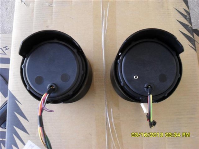

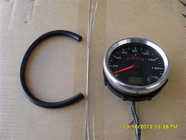

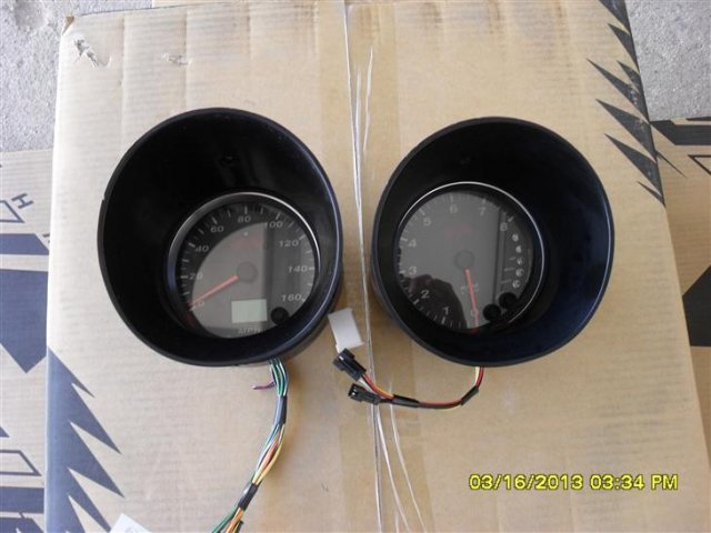

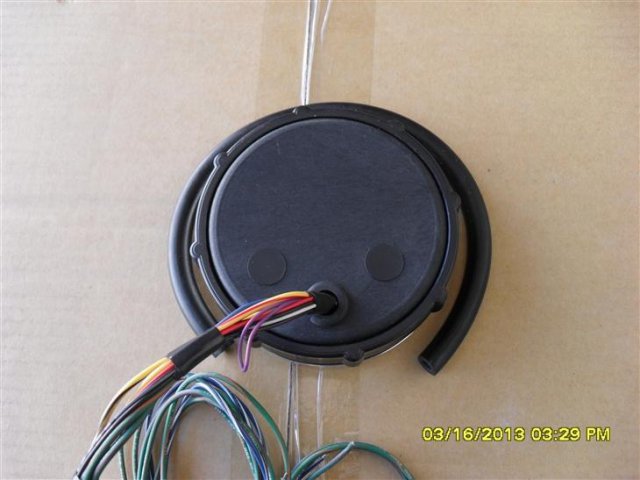

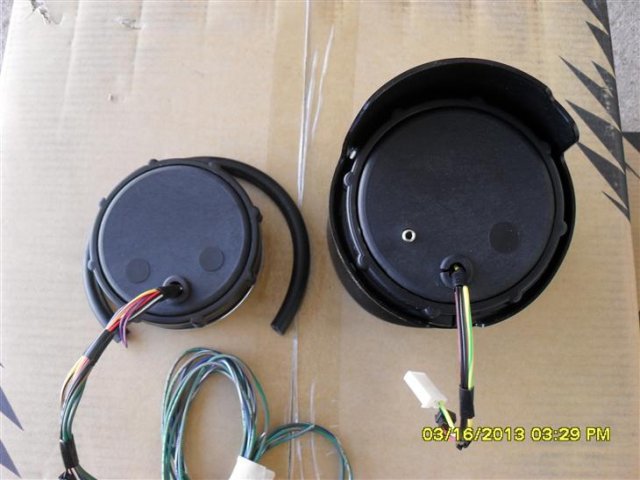

Domzs Posted April 7, 2013 Share Posted April 7, 2013 Here's another way to install Speedhut speedo and tach gauge . I used vac hose to install mine . Vac hose size depends on gauge size . Quote Link to comment Share on other sites More sharing options...
BitchinZ Posted April 7, 2013 Share Posted April 7, 2013 That looks good. Where did you get your hose and what size? I have the same size Speedhuts as you. They dont move around at all with that setup? Quote Link to comment Share on other sites More sharing options...
Domzs Posted April 8, 2013 Author Share Posted April 8, 2013 Sorry , forgot the size . I'll check tomorrow when i get back to the shop , if i remember which box . LOL . They fit tight , i used some WD40 to get them in . Not going to come off without any help . Quote Link to comment Share on other sites More sharing options...

Domzs Posted April 8, 2013 Author Share Posted April 8, 2013 Think i used 1/4 vac. hose . Quote Link to comment Share on other sites More sharing options...
