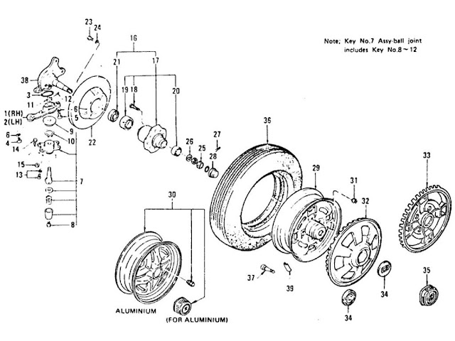

tamo3 2 Posted April 29, 2013 Share Posted April 29, 2013 I Slivermine brake spacer for slotted rotor with Toyota 4x4 conversion. Also I got Quest Studs. Part number at napa was 6412785 for 83-89 Nissan Quest Rear Studs. Now I need longer bolts to connect rotor and hub since I put spacer. Does anyone know where can I get that? Longer version of Part #23 http://www.carpartsmanual.com/datsunS30/DatsunZIndex/Axle/FrontAxle/tabid/1728/Default.aspx http://forums.hybridz.org/topic/63877-big-brake-kits-240z-260z-280z/ Thanks, tamo3 Quote Link to post Share on other sites
cgsheen 22 Posted April 29, 2013 Share Posted April 29, 2013 And you don't really need Quest rear studs - the rear studs on every early Z are the about the same length as the Quest - I used rears for the front too... We have a really well stocked - been here since the stone age - Ace Hardware near here that carries a huge variety of bolts & nuts. We found longer bolts for the rotors there. Or any good bolt and nut supplier. I can't remember the thread and pitch, but you have the orginal bolt, and the spacer adds about 3/8", right?... Quote Link to post Share on other sites
tamo3 2 Posted April 29, 2013 Author Share Posted April 29, 2013 Thanks for the information. I will check out local ACE and OSH. I heard rear s30 stud is 40mm where Quest stud is 45mm. http://forums.hybridz.org/topic/97317-extended-wheel-studs/?p=914442 Anyway, removing stud from rear extremely painful (I need to remove rear hub too.) and I already got Quest Studs. Yes, you are right. The thickness of the rotor hub is 3/8" for 280z. I exchange my 240z version spacers with member in this forum since I sold my 240z and got 280z. 280z = .375" = 3/8" (280z hubs only)240z = .5" = 1/2" (240z hubs only) http://forums.hybridz.org/topic/88620-toyota-4-piston-caliper-spacer-size/?p=841786 Thanks, tamo3 Quote Link to post Share on other sites
