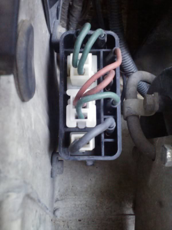

NewZed Posted May 2, 2013 Share Posted May 2, 2013 Check fusible link. Where did you come up with "12 amp connection"? I don't think that anybody out here is a fuse or a relay. Quote Link to comment Share on other sites More sharing options...

Clashez Posted May 3, 2013 Author Share Posted May 3, 2013 Check fusible link. . Checked fuse able links and they seem to be a okay Quote Link to comment Share on other sites More sharing options...
Domzs Posted May 3, 2013 Share Posted May 3, 2013 (edited) Need to use a voltmeter to make sure they are good . What year car are you working on ? Edited May 3, 2013 by Domzs Quote Link to comment Share on other sites More sharing options...

Domzs Posted May 3, 2013 Share Posted May 3, 2013 Check your White/Black wire ( power to ign. switch ) . If it has power then your ign. switch is bad ( electrical part ) . As CGSHEEN stated . Quote Link to comment Share on other sites More sharing options...
Clashez Posted May 4, 2013 Author Share Posted May 4, 2013 Well it was the fuse able link wire for ignition side.. thanks for the help Quote Link to comment Share on other sites More sharing options...
