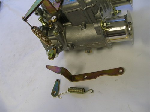

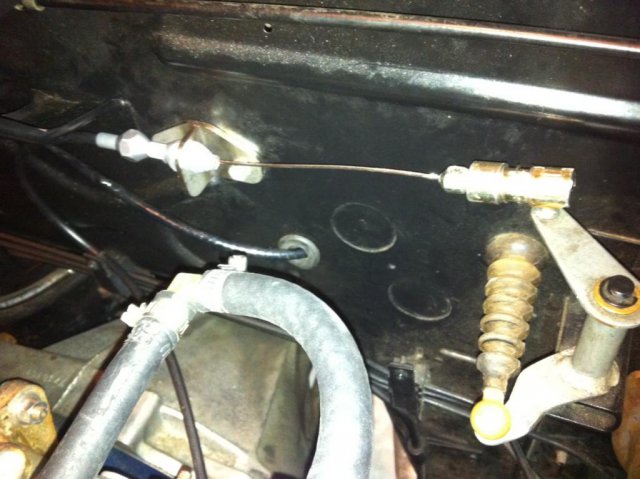

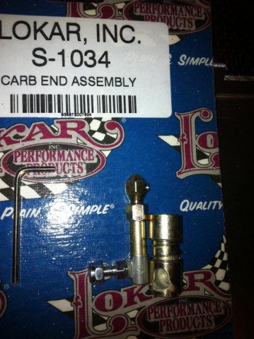

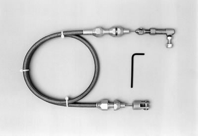

T-Bone028 Posted May 18, 2013 Author Share Posted May 18, 2013 Anywho, figured I show some pics of how I ran my throttle cable. I wanted the least amount of permanent modification as possible, and I think I was able to accomplish it with a great pedal feel and smooth action/return without any binding. Parts list: - Lokar 36in throttle cable, I used p/n: LOK-TC-1000U36 ($48 from Summitracing) - Quick Disconnect Ball Joint Assembly 5/16-24 ($15 for 2 from Amazon.com) - 5/16 (8mm) rod arm p/n: 99006.251 ($8 from pierce manifolds) - DCOE bottom mount cable bracket, p/n: 40930 ($33 from Pierce Manifolds) - DCOE external spring kit, p/n: LT5000 ($32 from Pierce Manifolds) - 16" stainless steel linkage rod p/n: 36016 ($13 from piercemanifolds) - 2 5/16 shaft collars p/n: 99024.350 ($13 from piercemanifolds) - Last piece was the firewall bracket that replaced the bell crank. I received it from HybridZ member Savage42 for $25. This could probably be made for you DIY'ers. Total cost: ~$187 I'm sure some of you more creative/thrifty folks have done something similar for a whole lot cheaper...but this was all readily available, off-the-shelf products delivered to my door. The Lokar throttle cable has one end with a ball and cup (1/4") that can be disconnected. Unfortunately the cup is too small to fit over the datsun pivot ball. So, I took the 5/16 quick disconnect ball joint and slid it over the lokar cable end, and bonded the two permanently in place with JB Weld. I like the quick-disconnect because it takes me all of 30 seconds to completely disconnect my throttle cable to make adjustments. Plus, I didnt have to crawl under the dash and modify the gas pedal at all. The only other "modification" I had to do was trim the cable sheath 3" to give me more cable wire. Here's a pic of the cable (that shows both ends of the cable) and the quick disconnect ball joint before being JB welded together.. And here's a pic of it in place along with the firewall bracket from Savage42: To connect the throttle cable to the carb/linkage, I used the DCOE bottom mount cable bracket from PierceManifolds, and a small L shaped bracket I had leftover from a universal choke cable to attach the other end of the lokar cable to the rod arm on the main linkage rod. Here's a pic of the bottom mount from Pierce Mainfolds, and it attached to the center carb. Lastly, the return spring is fitted to my 1st carb closest to the radiator...its the only return spring I'm running and with all the rods/arms attached to the carb/main linkage rod, all carbs return fully to the throttle stops. Based on some other posts, seems like I'm of the lucky few that is able to run all three rod ends on my intake manifold (brand is Redline). With my throttle cable rod arm mounted closely to the center rod end, I have good mechanical advantage and solid support to avoid bending the linkage rod. I've read some other experiences of folks only being able to run two rod ends due to uneven spacing and in some cases, the linkage rod flexing/being bent. I believe a fix for some folks has been re-drilling the manifold to accept 3/8 rod ends and a beefy 3/8" rod. Or JB welding the center rod end mount, and re-drilling to be centered correctly. Hope this helps someone, it probably took me a solid few days of thinking about and finding all the parts online I would need to make everything work as I envisioned. Now if only this weather would cooperate so I can continue tuning my rookie-mistake carbs! Quote Link to comment Share on other sites More sharing options...
AZGhost623 Posted May 19, 2013 Share Posted May 19, 2013 Man Im super interested in that throttle cable setup. I have been looking for a decent setup and a how to for some time. I may be asking you some questions later Quote Link to comment Share on other sites More sharing options...

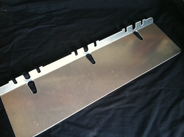

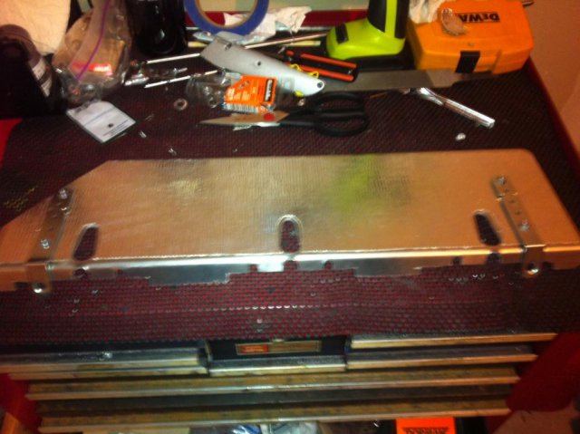

T-Bone028 Posted May 19, 2013 Author Share Posted May 19, 2013 (edited) Hey Heroez, I'm addressing you directly (again)...thanks for your opinion. I'll make sure to run everything I do by you first, I'm just not good at planning things. Wait...did I just make a plan?!? Awesome!!!! Moving on...I finished up my heatshield and put it on this morning. I purchased the heat shield from ZCCJDM.com...its a nice piece, but being universal, it had to be modified to fit. It took some time to trim the heatshield to fit my engine bay and I ended up having to use brackets to mount it to the intake manifold studs. There just wasnt any way to get it securely in place with the existing mounting slots. If I were better at planning, I probably could have just made the shield myself... but I'm relatively pleased with how it turned out. Here's a pic from ZCCJDM's website...when I received it in the mail it looked nothing like the picture from zccjdm's website, it had a lot of additional material on top of the mounting holes and it would not fit as received due to clearance issues with the carburetor bodies. Aside from trimming the excess material above the mounting slots, and adding brackets, I also had to trim part of the shield to clear my brake booster vacuum reservoir. Here's a picture of the shield trimmed to fit, thermo-tec heat adhesive backed heat barrier applied (about $18 from summitracing), and brackets added. And lastly, as mounted in the engine bay. Weather still wont cooperate and its forecasted to rain the next 5 days...so once I get permission from Heroez and the weather clears up, I'll be able to road tune and try out different jets. Moderators, please feel free to move this thread to the members project sub-forum if it makes more sense. Heroez, that okay with you? Edited May 19, 2013 by T-Bone028 Quote Link to comment Share on other sites More sharing options...

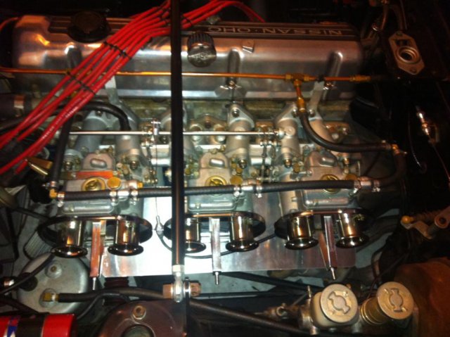

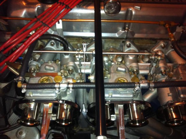

T-Bone028 Posted May 20, 2013 Author Share Posted May 20, 2013 For those following this thread (and I hope my experience thus far is interesting to you), I was able to do some tuning today. But first...Ram, I agree, I could be leaving power on the table...but I also left some money in my pocket! My primary cost on these specific 40 DCOE's, are the 33mm venturis, air horns, and filters. Everything else, like Gollum mentioned previously, would have had to be purchased regardless (assuming I purchased used 45's). Rebuild kits, additional linkage/throttle cable pieces, heat shield, manifold gasket, fuel hose/fittings, supplies, etc would still have been needed. And different main venturis could be a cost if the set of 45's I hypothetically were to purchase werent already ideally sized. However, what I really gained out of this project (aside from a LOT of fun) is experience. I now have a far better understanding of the disassembly/assembly, various circuits, and tuning of a DCOE carb then I ever had reading the Weber carb books I've been casually scanning through for the past 3 years. And as you mentioned...the beauty of these DCOE's are their design. I can always bump of the choke size with almost minimal work. Lastly, regarding CFM's...what I posted was for all intents and purposes...100% arbitrary. Numbers picked from obscurity over multiple years, unknown flow benches, and a whole lot of other variables. But in the end, I now have 6 carbs with 33 mm venturis, instead of 2 carbs with 32 mm venturis. On to my tuning experience this afternoon...I removed the air horns to make room for my sychrometer and measured their flow, and I changed my idle jet from 50F9 to 55F9. They are now all about as close as I could get them without being drastically different from the number of turns out on the idle mixture screws. I bench-set the idle speed screws prior to installing and dont plan on changing their position. Idle speed now hovers between 1000-1100 RPM, and AFR at idle is 12.5 to 13. Under load, AFR's up to about 2000-2500 RPM are in the 11's...however, I did not get the chance to get up to a real cruising speed (just running around at 30 mph on a short road less than a 1/4 mile from my home). Hopefully, this weekend I can take her on the highway to get a better idea of AFR's at steady state cruising. The real effect I noticed from the change of 50F9's to 55F9's, was the dreaded "bog" other people have experienced with triples. When flooring the throttle with the 50F9's from about 10 mph, I would get a slight half-second bog before getting planted in my seat. Now, with the change to 55F9's...the bog/hole/hesitation/what-ever-you-want-to-call-it, is effectively gone. I'm sure if I were strapped to a dyno with every single measurement device known to man hooked up, there would be data that shows there is a bog. But from a "seat of the pants" feel, there wasnt anything I could perceive...and somehow a grin ear-to-ear is permanently on my face. Finally, I was able to look at my AFR's at full throttle at 6500-6700 RPM. They climbed up to about an AFR of 13.8 at WOT. I may change my air correction jets from 180 to 170 to see if I can richen it up on top. From 2500-6000ish, AFR's are in the 12's at WOT...so according to the gauge, I probably dont need to change anything with the mains. Will I change my mains to experiment? In the words of Sarah Palin, you betcha! For those debating the move to triples, do it! So far, they have been completely drivable on the street, 100% fun, and noticeably faster in comparison to my SU's (SU's were rebuilt by Ztherapy in 2002). Hope to give some more updates as I progress through this project/exercise. Quote Link to comment Share on other sites More sharing options...
