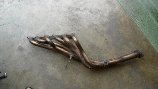

Does anyone make a Greddy knock-off that fits the RB20 NEO? I mean the greddy fits the RB25det and the RB25det NEO, but nothing else I have seen. It wont fit the RB26dett, RB25DE, or RB20DET... Better make sure one will fit your NEO 20 before hand.
Other than that looks good.
BTW, Venus has an RB20DE NEO on the shelf for sale right now...
Also have a look around you will find headers on ebay that will work. The RB20DE has the same bolt pattern as the RB20DET/RB25DET/RB25DE on the exhaust side. So Finding headers is only a matter of making sure they will fit a LHD steering column... and so far Ive seen a few that work.
Dig around and one will pop up
Edited by rayaapp2
No knockoffs for the 20 as far as I know, besides the stick welded ones on ebay from Thailand that I've seen blow the welds on boost above 18lbs. Usually knockoffs are for the 25 and 26. Only "really good" (in terms of flow and quality) one for the 20 in the aftermarket is the RIPS one, but those run a cool 1k+.
