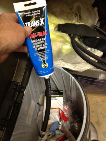

RebekahsZ Posted May 25, 2013 Author Share Posted May 25, 2013 (edited) Another tube of trans-x in the pumpkin. Used some 3/8" fuel hose to help get it in the fill hole. Edited June 1, 2013 by RebekahsZ Quote Link to comment Share on other sites More sharing options...
