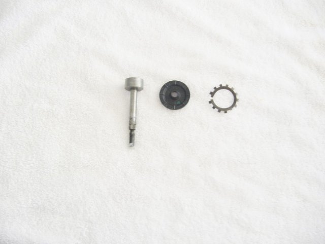

Miles Posted June 4, 2013 Share Posted June 4, 2013 On 6/4/2013 at 12:15 PM, RebekahsZ said: Anybody know how to get the rod out? This booster just has a rubber seal around the rod with no visible metal retainer. Grab the push rod with vice grips and pull it out. See picture for components. Be carefull not to loose the reaction disk (glue in-place when reassembling the push rod). Quote Link to comment Share on other sites More sharing options...
