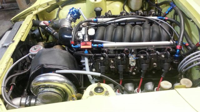

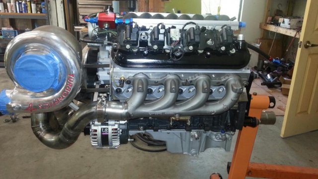

Z-Gad Posted October 7, 2014 Author Share Posted October 7, 2014 Quickie update... As many of you know, little over a month ago I had something let go in the bottom end of the built motor at the track, effectively destroying the short block and everything inside with maybe 500 miles on it. Fortunately the heads escaped unscathed... Had a thread on here, but it all disappeared with the site crash a month ago... Anyway, after a month and a half of number crunching, and agonizing on what to do since a new built bottom end is not in the cards right now, and I know I won't feel comfortable with just a stocker... I've decided to take the car down for a while to do some things to it that I have wanted to do, part out the turbo LS setup, and go back to the 2JZ. I'll be posting some items in the for sale section shortly... Quote Link to comment Share on other sites More sharing options...
