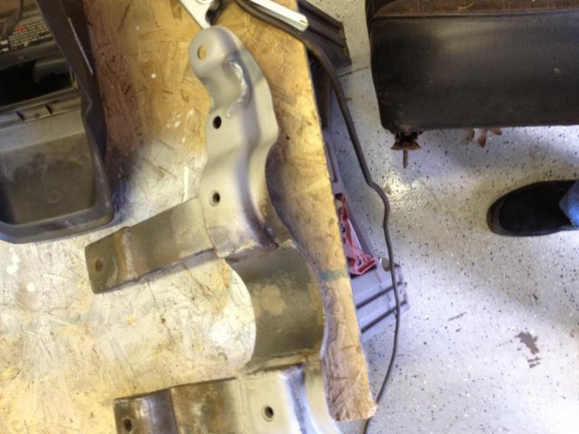

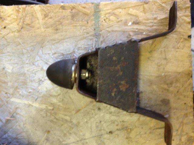

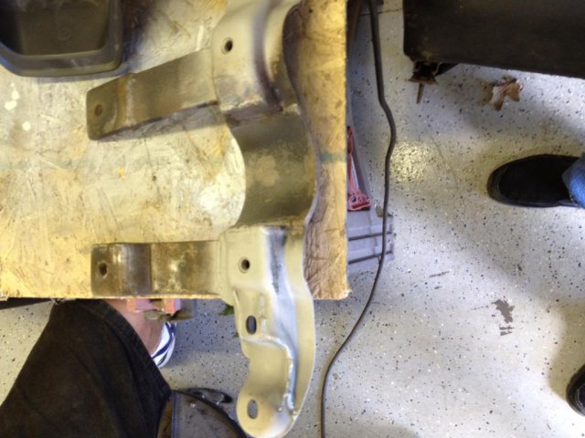

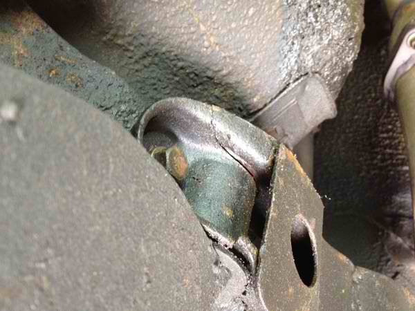

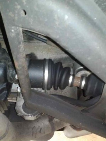

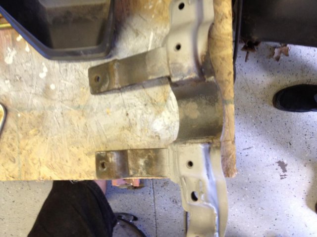

PLATA Posted July 18, 2013 Author Share Posted July 18, 2013 (edited) My modified diff mount developed a crack due to metal fatigue , crack was welded and back on the road stump re adjusted to prevent play Q45 R200 diff modified axles, no issues since the weld fix Edited July 18, 2013 by PLATA Quote Link to comment Share on other sites More sharing options...
