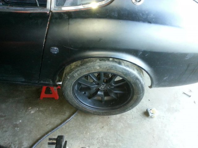

mattd428 Posted October 10, 2013 Author Share Posted October 10, 2013 Somewhere I saw you can use coil overs and will give a half inch clearance for the front tires. Might try that before i buy spacer. Quote Link to comment Share on other sites More sharing options...

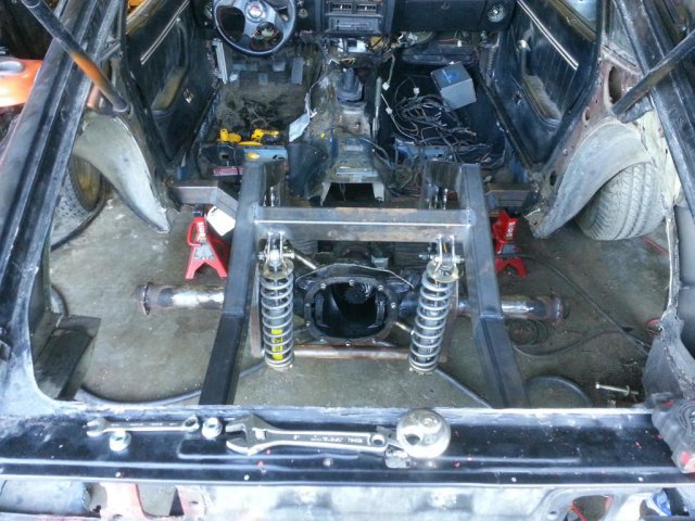

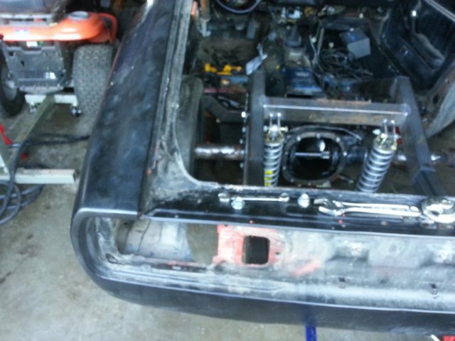

mattd428 Posted November 2, 2013 Author Share Posted November 2, 2013 (edited) Got an update for you ladies and gents. The axle is narrowed 7"s 3.5"s from each side. Still have to do the frame rails to connect the backhalf to the front frame rails. Also have to modify the rails for the seats doesnt give me enough room just yet but it will. Edited November 2, 2013 by mattd428 Quote Link to comment Share on other sites More sharing options...

RebekahsZ Posted November 9, 2013 Share Posted November 9, 2013 How does having the springs mounted so far inboard affect cornering? I'm asing because I don't know. Lots of room for big tires. Looking good. Quote Link to comment Share on other sites More sharing options...

LT1RAY Posted December 23, 2013 Share Posted December 23, 2013 Sorry if I missed it, but why did you decide to back half the car? What didn't work with the first SA 8.8 setup? What is the total length of the narrowed rear end? What did the housing originally come out of? To many questions? haha Quote Link to comment Share on other sites More sharing options...
mattd428 Posted December 24, 2013 Author Share Posted December 24, 2013 Mounting points weren't strong enough. 8.8 is from a 96 mustang gt. I took 7" total out of it I want to say it is now 54" but not sure would have to measure it. I mainly wanted to be able to launch the car at whatever rpm I want so backhalf made more sense. Quote Link to comment Share on other sites More sharing options...

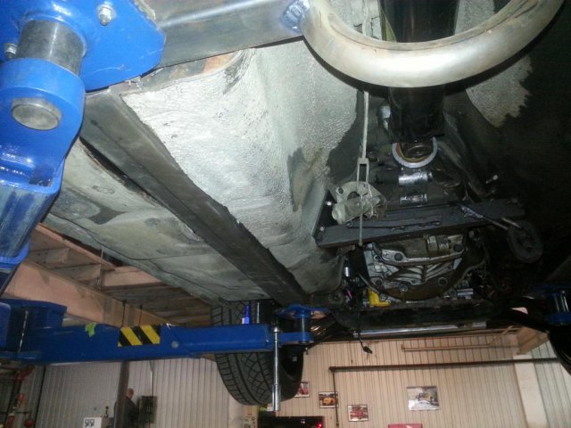

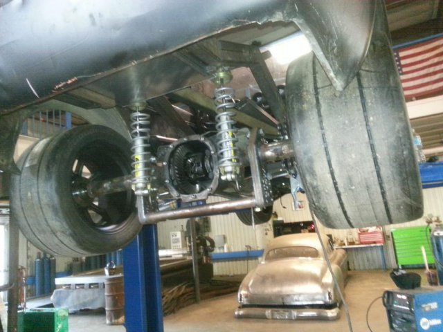

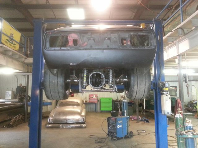

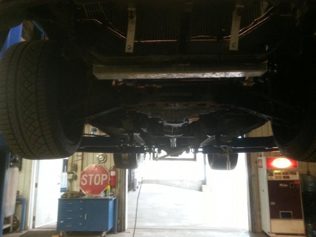

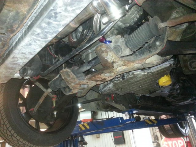

mattd428 Posted December 29, 2013 Author Share Posted December 29, 2013 Here you go rebekaz pics on the lift. Quote Link to comment Share on other sites More sharing options...
Domzs Posted December 29, 2013 Share Posted December 29, 2013 Looking good , Matt ! Quote Link to comment Share on other sites More sharing options...
RebekahsZ Posted December 29, 2013 Share Posted December 29, 2013 That's coming along great. Looking forward to a hot timeslip! Looks like you built quite a sub-frame in that car! Since you got it on a lift, can you shoot some more pics of where the 4-link bolts to the sub frame (the 4-link side)? Quote Link to comment Share on other sites More sharing options...
