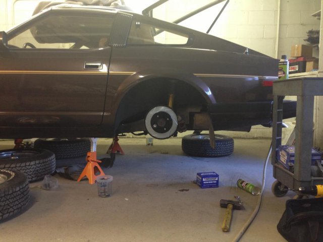

Bowtie29 Posted August 27, 2013 Author Share Posted August 27, 2013 Well, for now I'll be retaining the factory calipers. I bought some eBay slotted rotors from ABT (Advanced Brake Technology). I'm hoping they are decent enough for what I plan to do. The customer reviews didn't state any problems with them. I couldn't beat the price either at $110 for all four corners. I also bought some Apex Stainless Steal hoses to replace the factory rubber ones. I sourced these from eBay too for $60. The kicker was finding a decent pad. I had heard good reviews from a friend of mine on the Hawk HPS but Hawk doesn't produce a pad for the S130 in that particular pad compound, only full race pads (I'll never generate enough heat running auto cross every now and then). So with some more digging and reading and searching I went with Porterfield R4S. A lot of guys run these as a cheaper alternative to the Hawk HPS. They're a more street friendly compound. Reviews were mixed, I determined that most of the problems with them were probably due to installer error, but not all, a lot said they took more pedal pressure to really get things woaded down, but I'll take a chance. I found them on topbrakes.com and they cost $126 shipped. Porterfield was the only company selling a pad that hopefully exceeds my braking needs. I was hoping to get going on everything last weekend but happily spend Saturday and Sunday painting my buddy's Z31. I'm still waiting on the pads to show up, and it will be a little but while I get the tubes welded on to the front spindles and coilovers and all the new bushings welded in. I'm gonna be sure to do a decent build thread when I get the suspension finished up. I can get you guys part numbers/item numbers for these components if you want. For $300 I hope this is a "cheaper" alternative for those of us daily driving/auto crossing every now and then. Not included in that $300 is front and rear brand new (not reman) calipers for all four corners. The local O'Reilly's could still get all four and the counter kid told me they were the last in the warehouse, so I bought them. I probably won't need them, but I'm the type that if I can have extras sitting on my shelf for something that is hard to get, I'll take 'em. Quote Link to comment Share on other sites More sharing options...

Bowtie29 Posted September 30, 2013 Author Share Posted September 30, 2013 Well, I've got my rear coilovers all in, I haven't set ride height yet, but I'm wondering if any of you have made modifications to the subframe for toe/camber adjustment. I've noticed that there really aren't any "kits" to do so. I don't know if the toe is off or if it's just and optical illusion now that the hub/brake assembly sits further up in the wheel well. I would think that if the rear suspension on the ZXs needed toe to be adjusted the factory would have designed it to be be adjustable. I wouldn't think that raising the control arm at the coil mount point would change toe at all. Anyone have any thoughts on this? The picture sucks for showing this, but it was really the only one I have that shows where the brake now sits. Quote Link to comment Share on other sites More sharing options...
BluDestiny Posted October 1, 2013 Share Posted October 1, 2013 The more you lower your rear, the more camber and toe it will gain, there is nothing to do about this using stock bushings. It's really noticeable when you have stock sized wheels on and lower the crap out of the car. There is a toe/camber kit in the making. It will require the subframe to be pulled out and adjustable hinges welded in as the pivot points for the front of the control arm. Other than that PPK tried to use offset heim joints welded in place of the old rubber bushings. It would work, if he never changed wheels, and stayed at the same height. Quote Link to comment Share on other sites More sharing options...
Bowtie29 Posted October 2, 2013 Author Share Posted October 2, 2013 When might this kit be ready? I'm gonna have the subframe on the ground tonight. Right now I'm thinking the quickest way to do this would be to slot the holes on the subframe brackets and run Z31 rear camber/toe centric bolts/washers and then weld on the little 'C' brackets that hold the washer in place. Anyone else done this? It looks like an easy way to go. Be awesome if there was a simple kit that include the parts to do so... Quote Link to comment Share on other sites More sharing options...

BluDestiny Posted October 3, 2013 Share Posted October 3, 2013 Ppk did exactly what you want to do with the subframe. And he kept breaking the brackets off. Plus those eccentric bolts give you maybe half to a full degree of movement which isn't enough really. The kit is in the works, check the s130 build thread section. Stock calipers with ss lines and good pads go a long way..... I just wouldn't mess with the bias. Quote Link to comment Share on other sites More sharing options...
