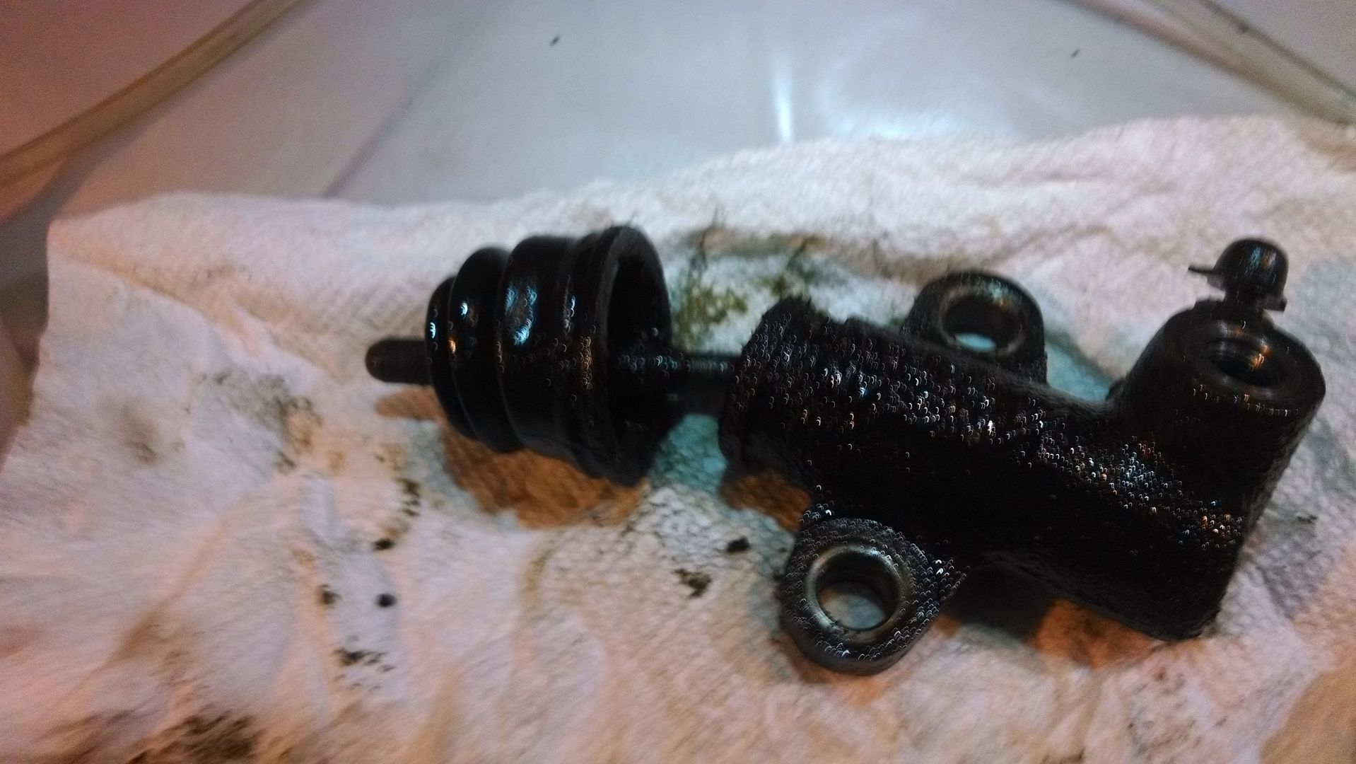

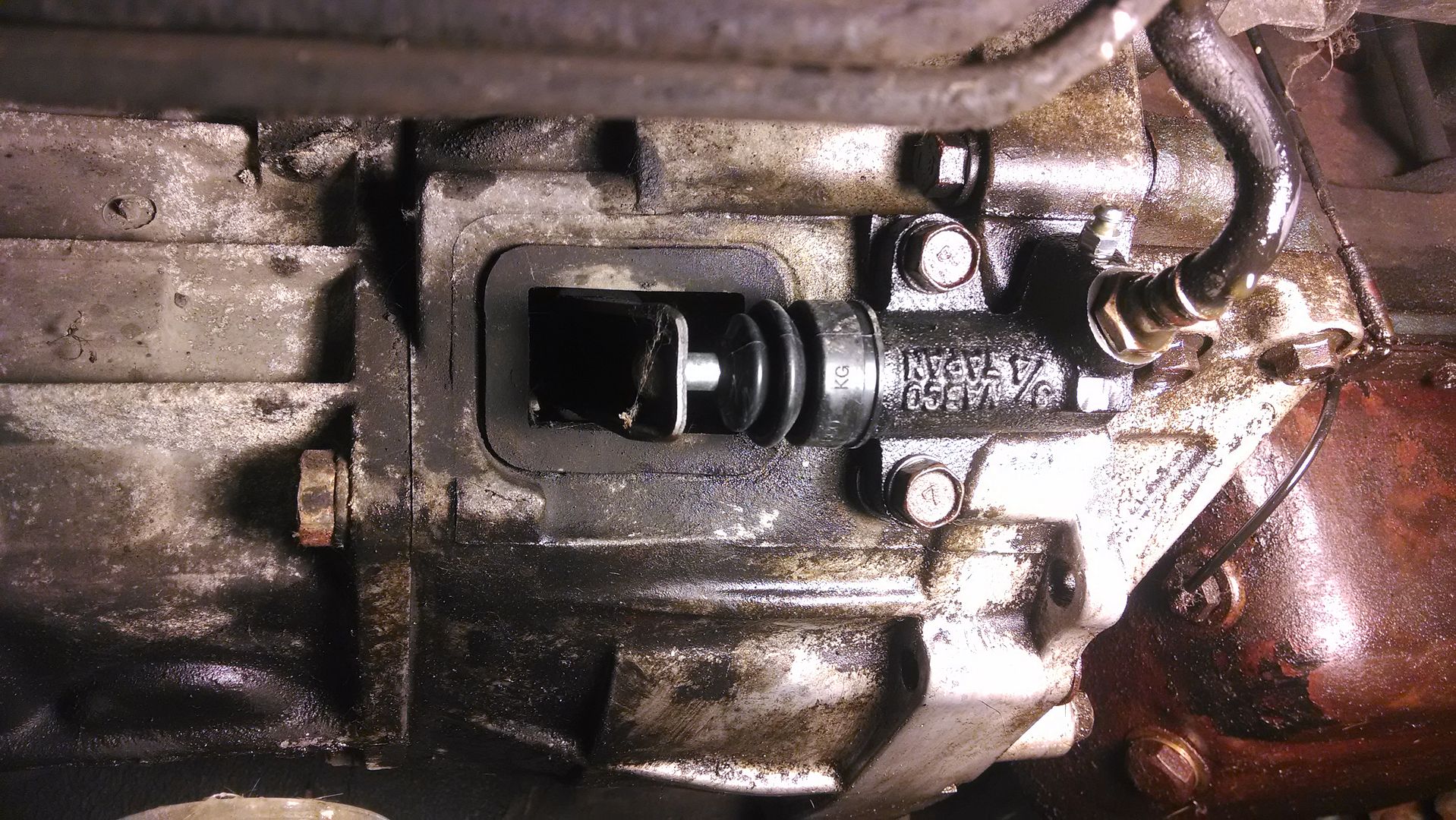

Tonight I changed out the slave cylinder.
Man, I don't know how the old one even functioned. It pretty much disintegrated when I pulled it. All full of grit and grime. Huge tear in the boot.
IMG_20140423_204519000_HDR_zpsggfencfh.j
So I installed the new one, and MAN. HUGE change in driveability, once again. At least from my 2 mile jaunt up the road, revs seem to fall off as they should. Seems like the clutch is definitely disengaging quicker.
I'll confirm tomorrow after more testing. Hopefully my skeleton case arrives soon so I can get some good sound driving videos.

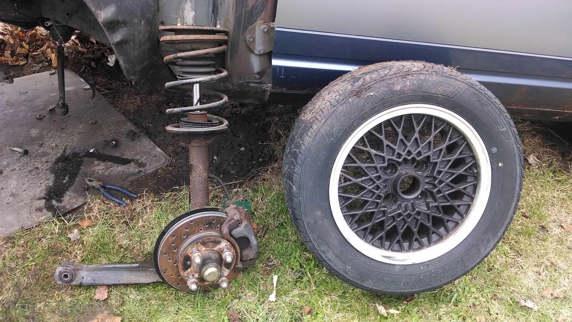

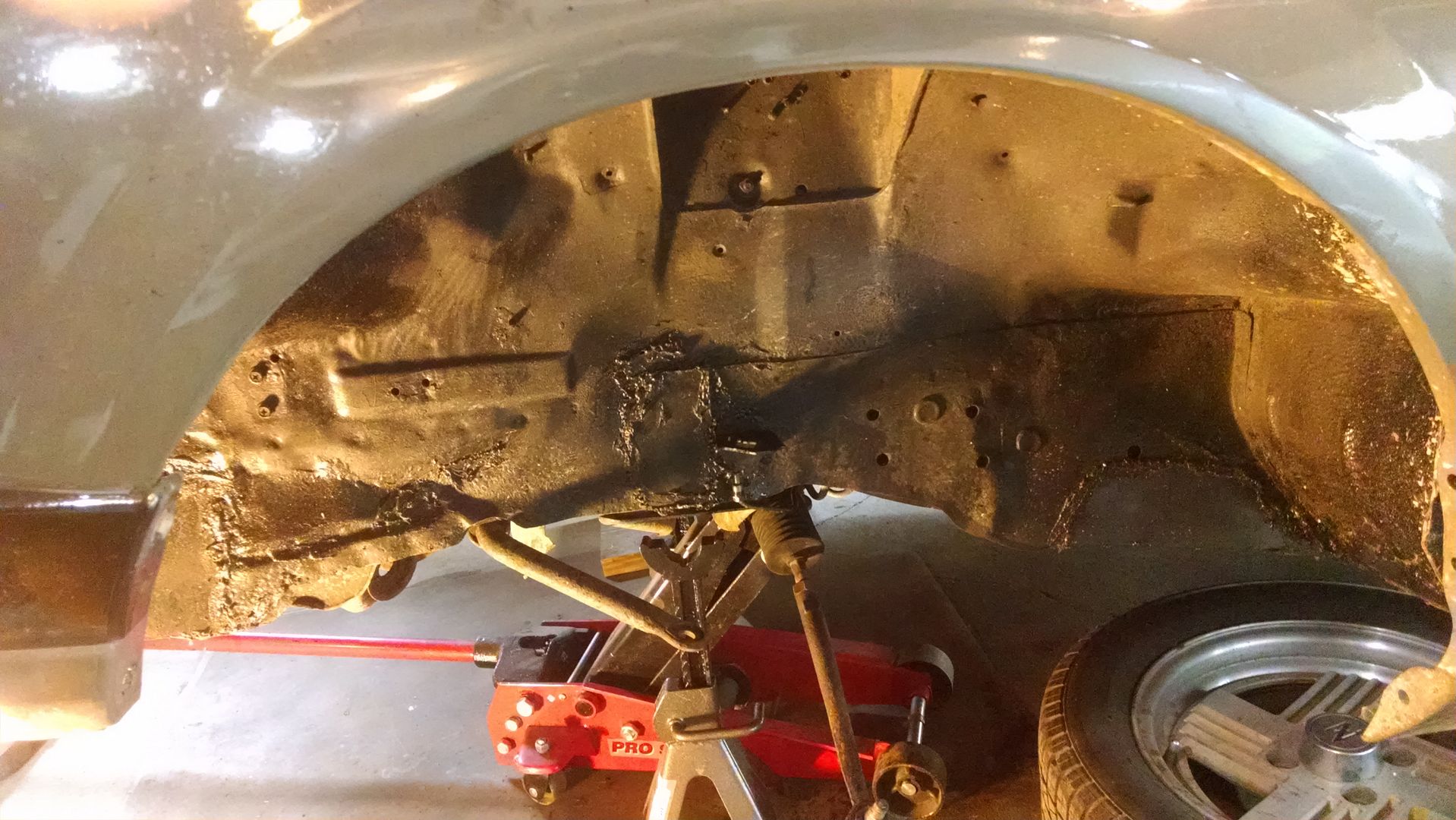

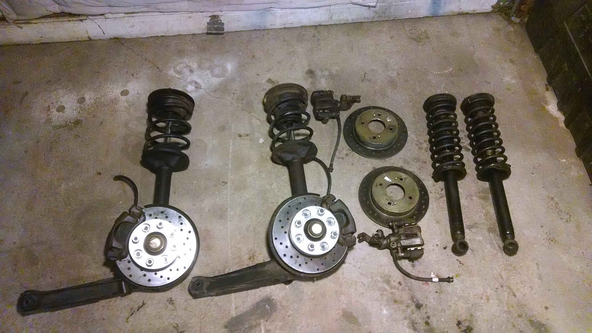

Today I got to pull the front suspension out of the parts car.
IMG_20140426_145930992_HDR_zpsjz8z0946.j
Look at those racecar brakes! New lines too.
And I will be going with the OZ mesh wheels.
Here are the crazy spacers that I had originally planned to run with the small wheels on the 240 to fill out the flares. I have to buy 15 non capped lug nuts to install them. Should clear all suspension components easily, and fill out the fenders a bit more too.

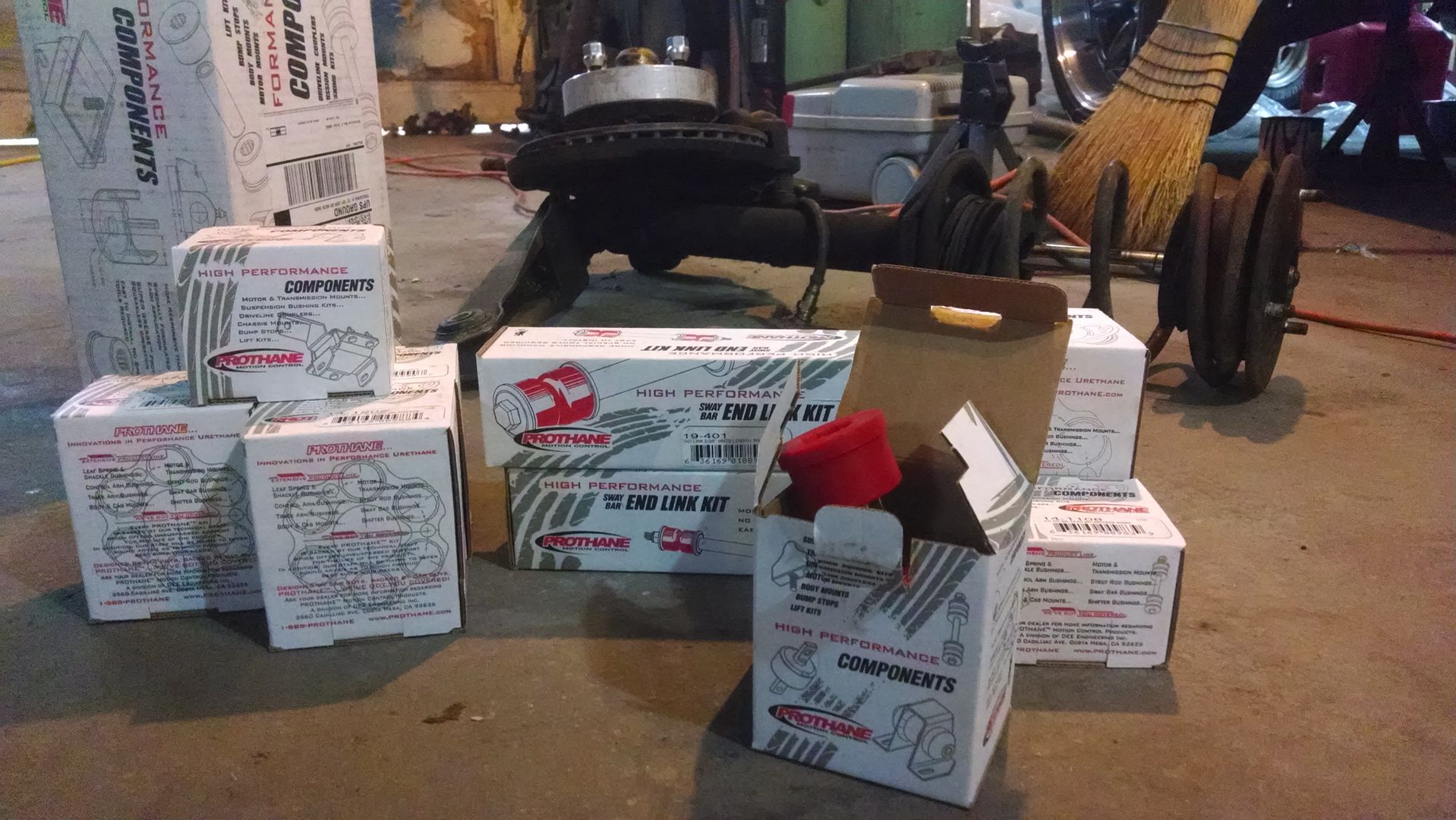

and the polyurethane bushings that everything will go back together with.
Still some cleaning left to do yet...

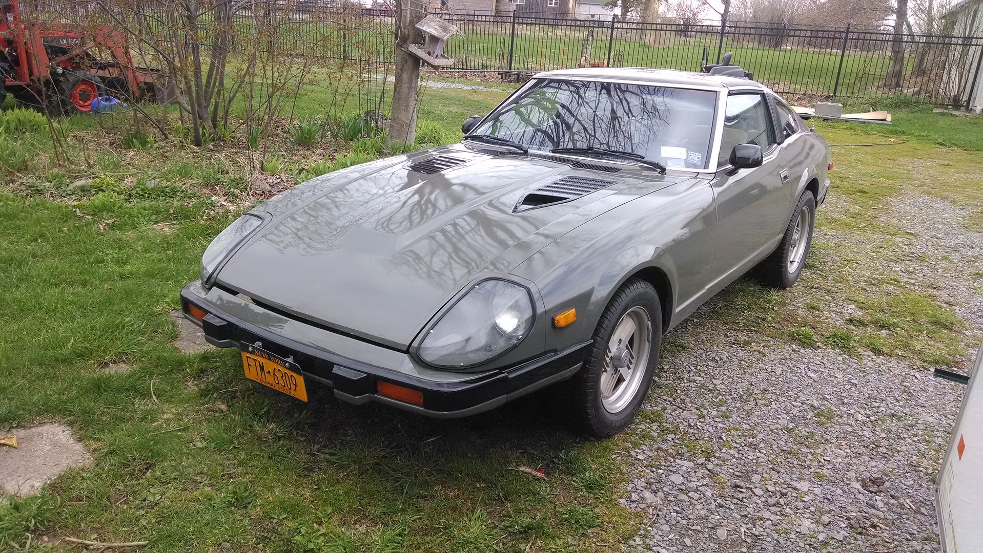

And here's what the car will look like with the new wheels. The best part of this arrangement (aside from aesthetics) is that they have two REAL good tires, and two shot ones (driven on a bad alignment) so I only have to buy two tires.
IMG_20140427_133656811_HDR_zps9o6hi3eg.j

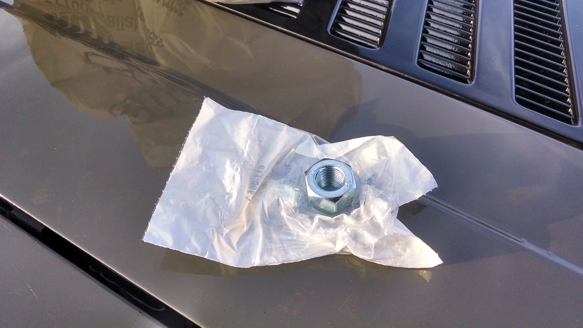

I ordered some lug nuts (+$35) for attaching the spacers. So, after work, I went for a drive to pick them up. I figured I'd make the car work for its parts now.

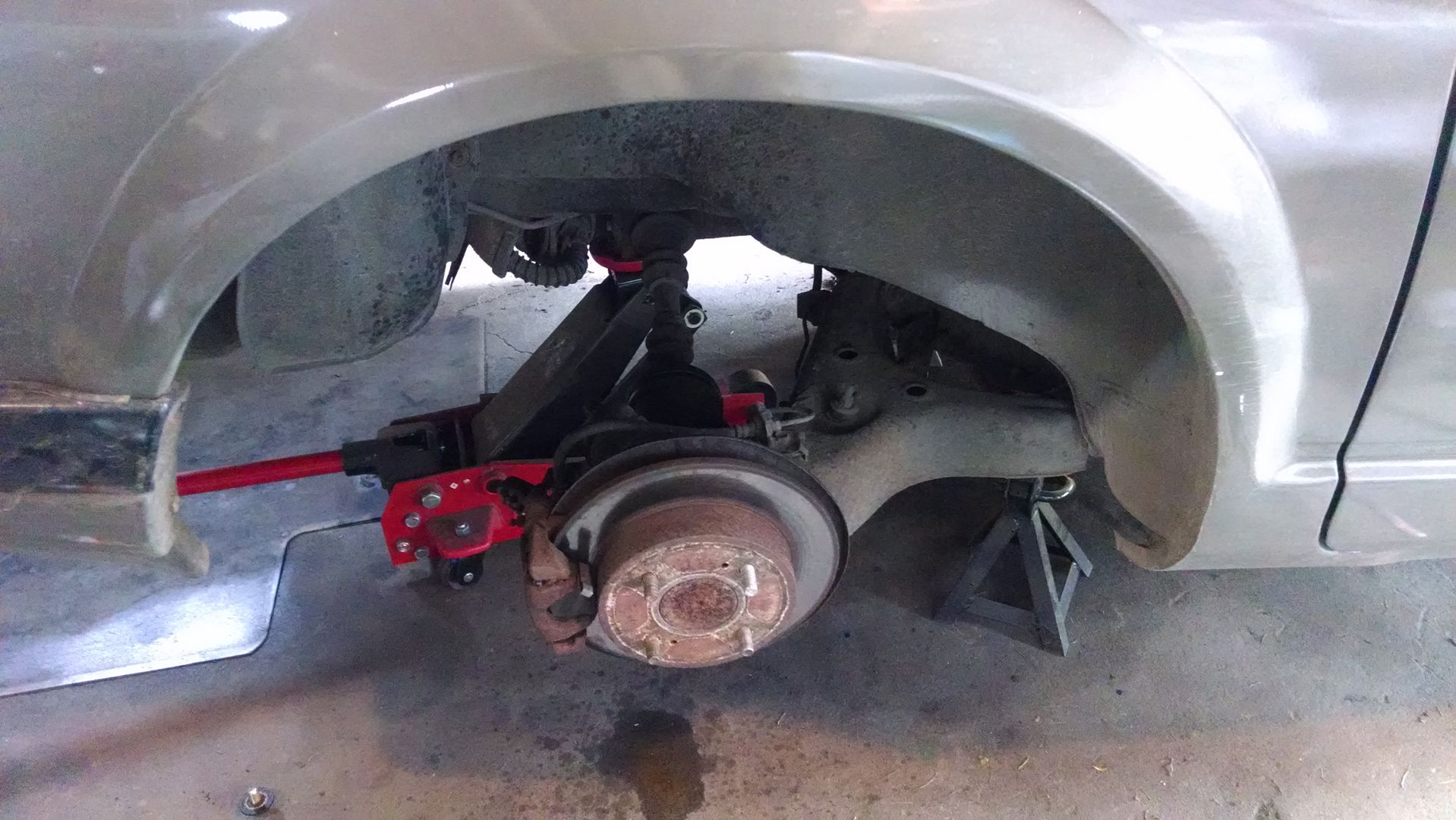

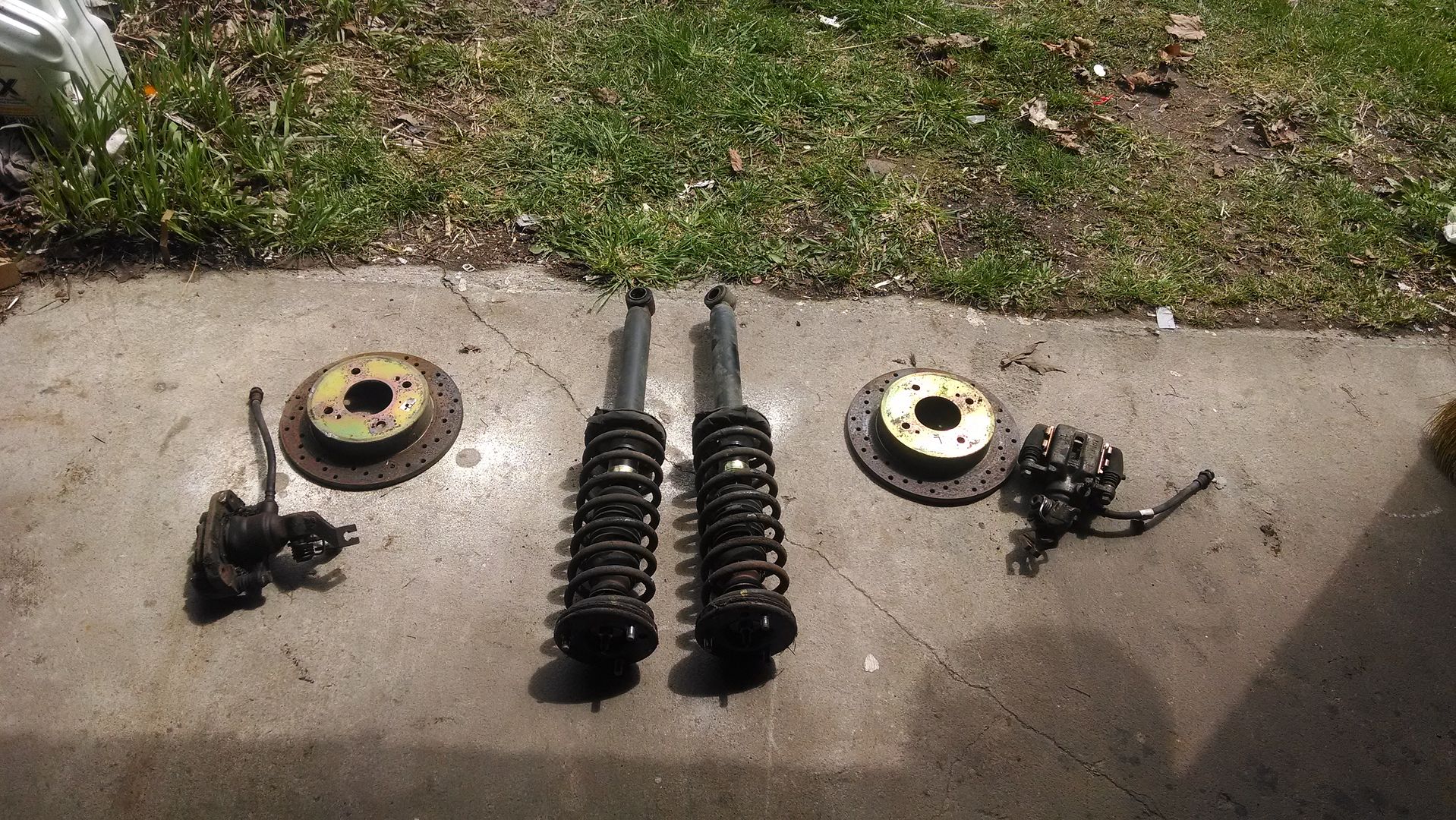

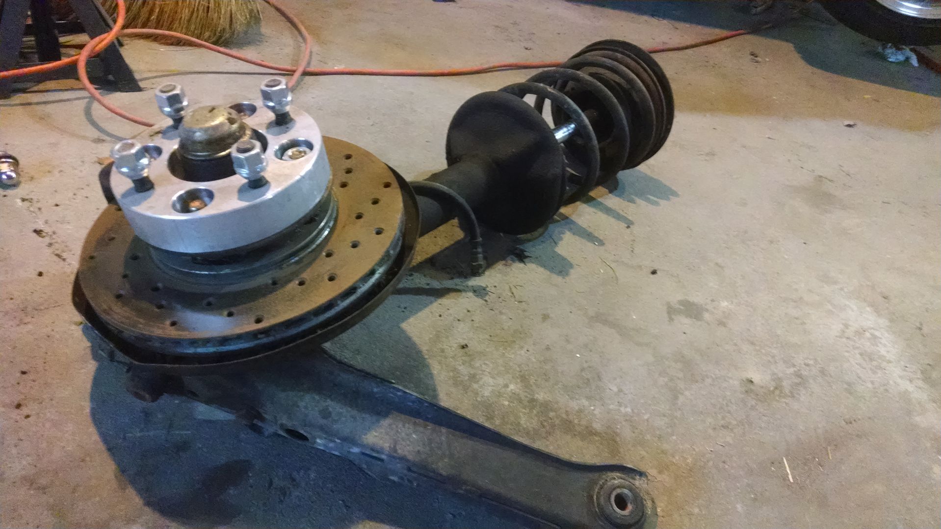

Did a little more tinkering today. Swapped out the rear suspension.
I'll do the brakes possibly tomorrow. Going to load up my bushings tonight in preparation as well.

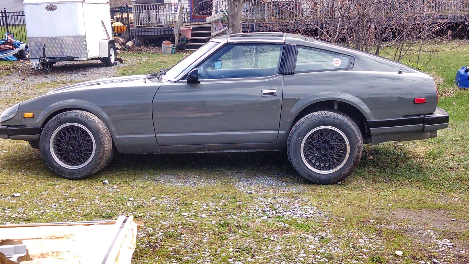

I installed the spacers with the current wheels. I'll be ordering 2 tires soon, so the O.Z wheels will go on the car next.
Here are some pictures of the improved fitment and rear suspension swap.
I'll tell you what, the car feels great.
Definitely an improvement. I can put power down reliably. I like that. Can't wait for the brake swap, bushings, and the fronts.

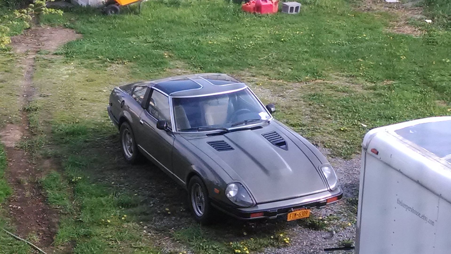

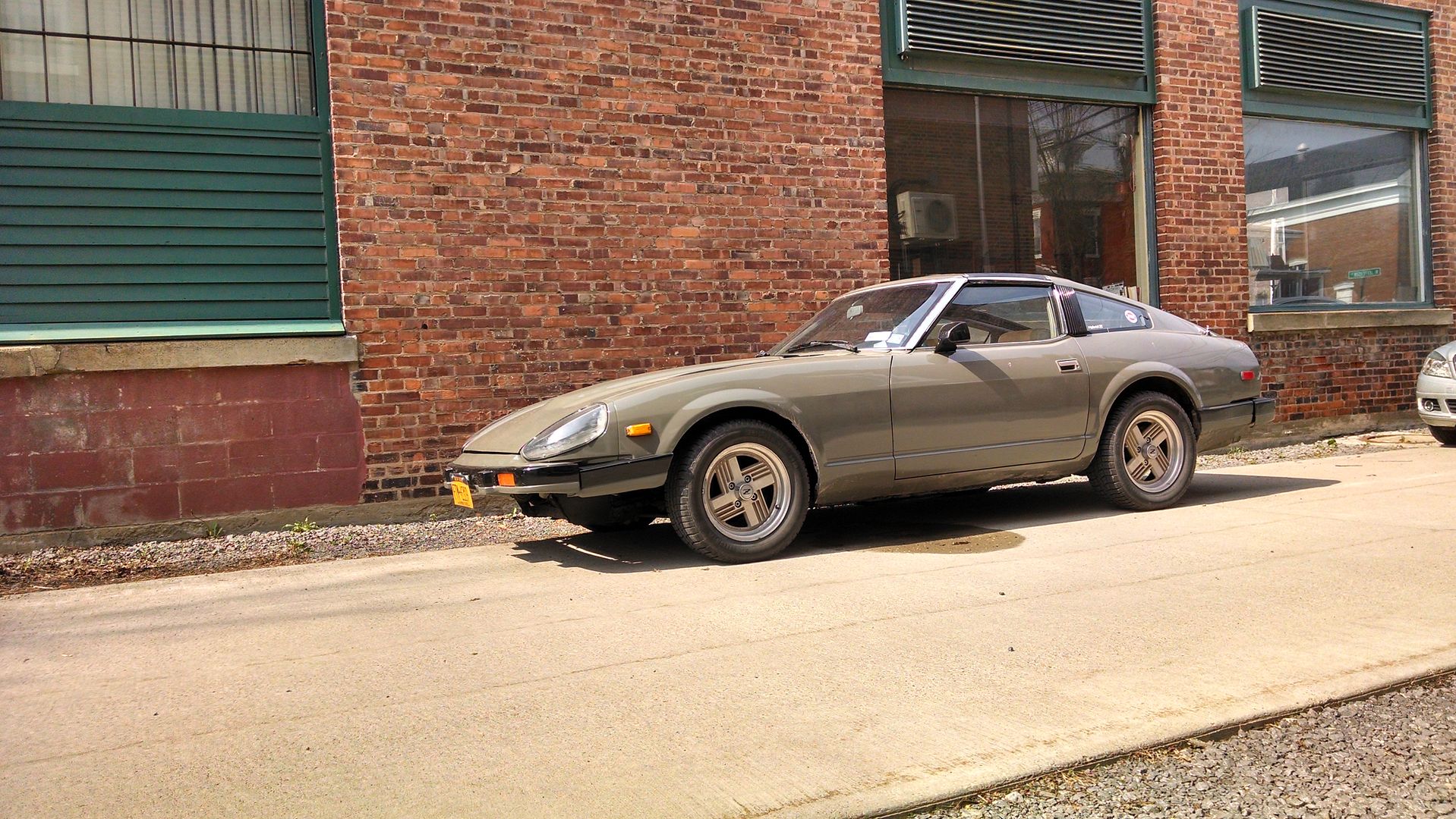

As for this car, I'm now up to around 1700 miles to date, and I'm loving it.
IMG_20140509_101927282_HDR_zpsdwevktbp.j

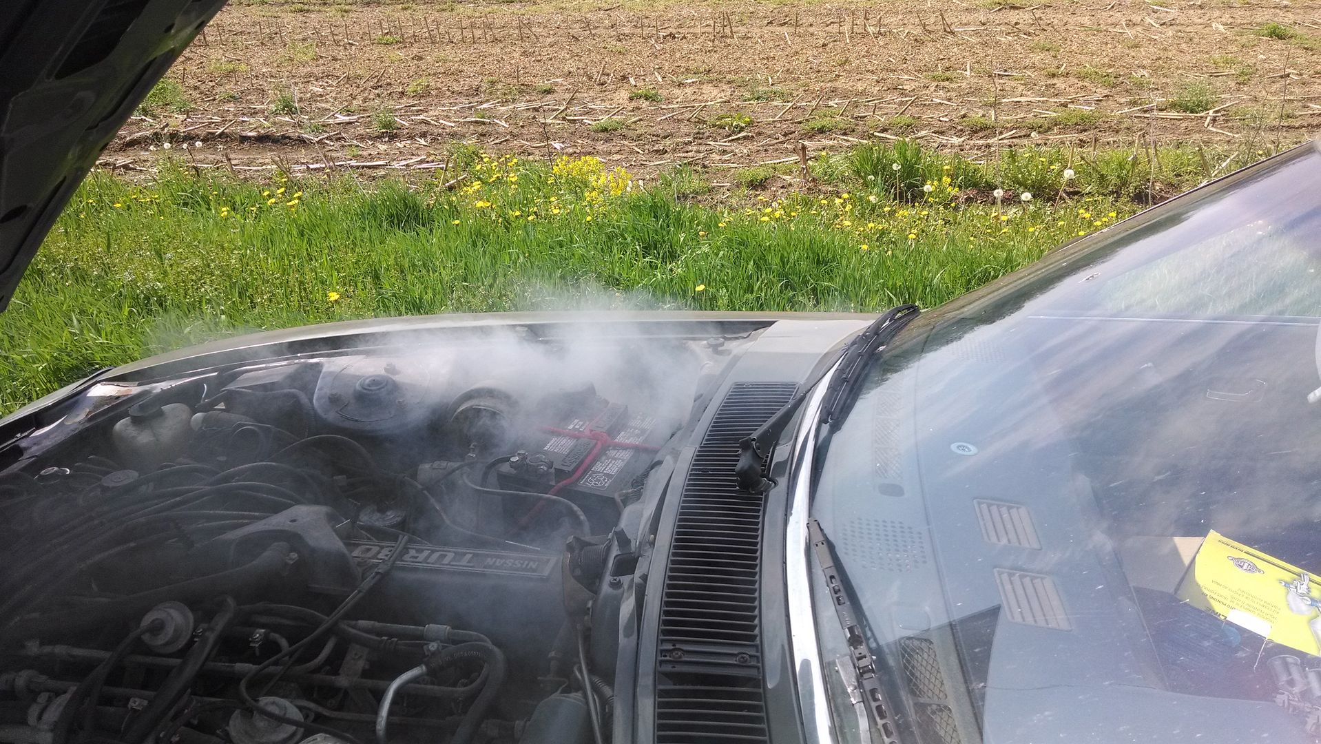

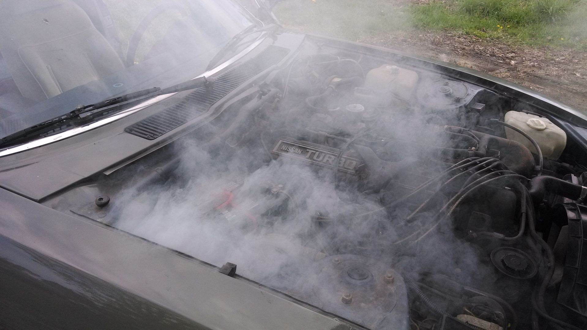

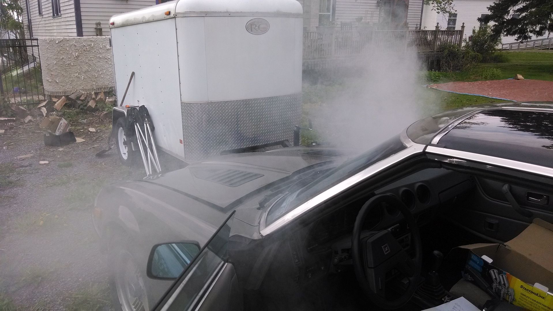

And today the car decided to be a bit theatrical on my way into work.
Pop goes the coolant line!
So I spent the passed hour or so limping the car home, making multiple stops to let it cool down. Kissing the danger zone.
Luckily, I'm not burning it internally, only just what's making it onto the engine block/manifolds.
And I still haven't swapped the brakes/front suspension yet. That's the first thing on the list once the garage is finished being organized.

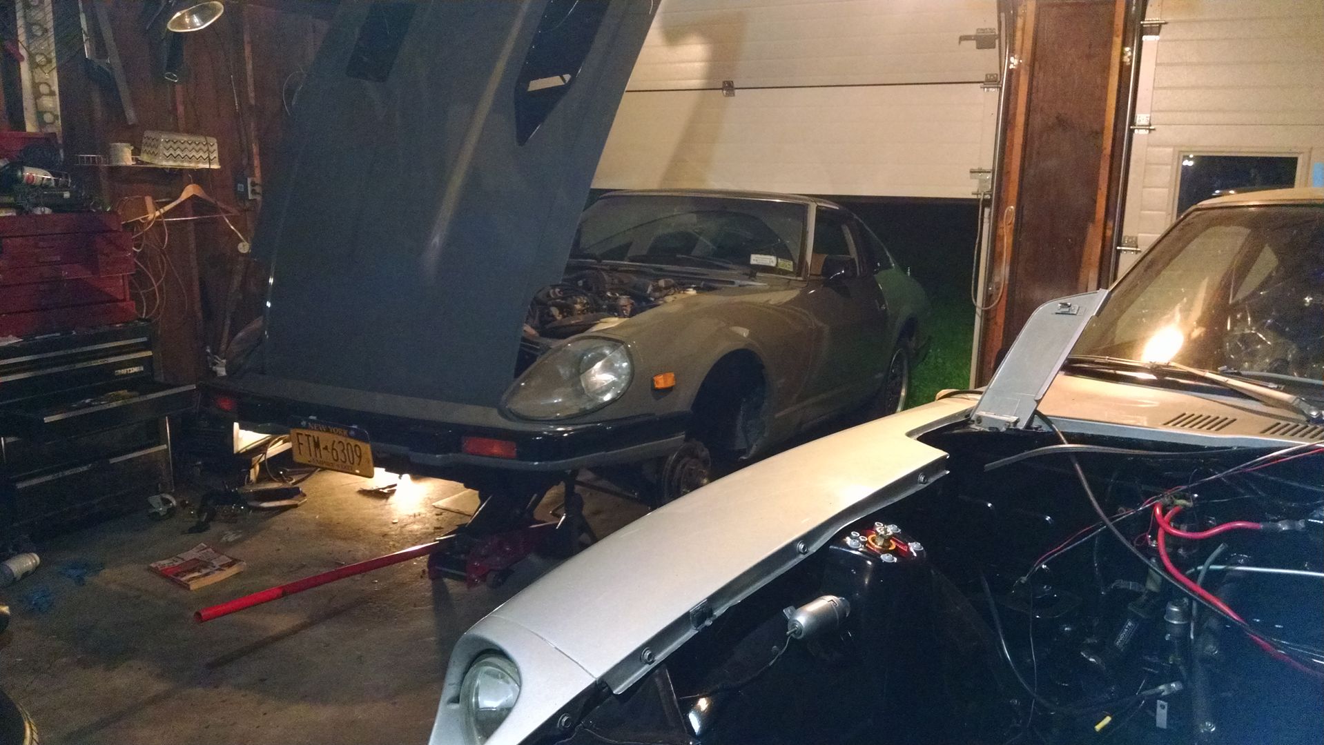

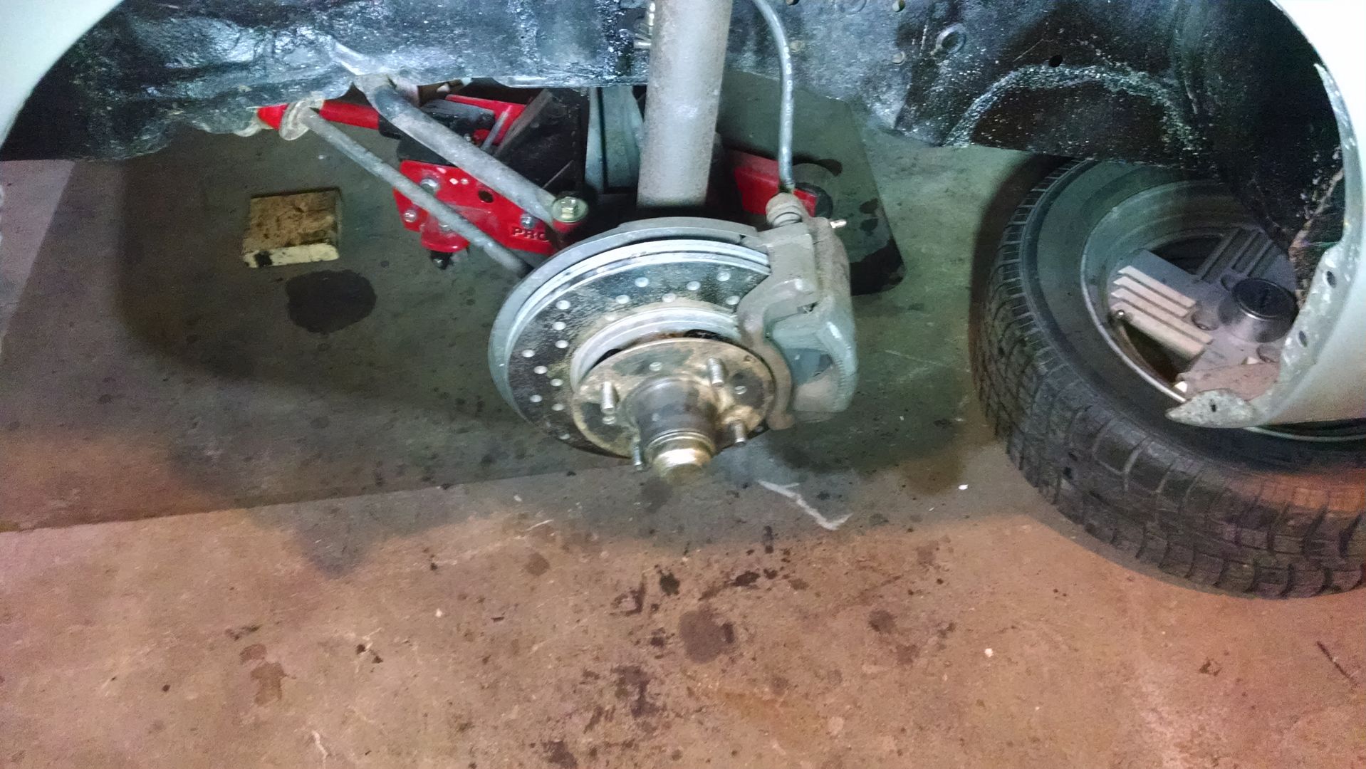

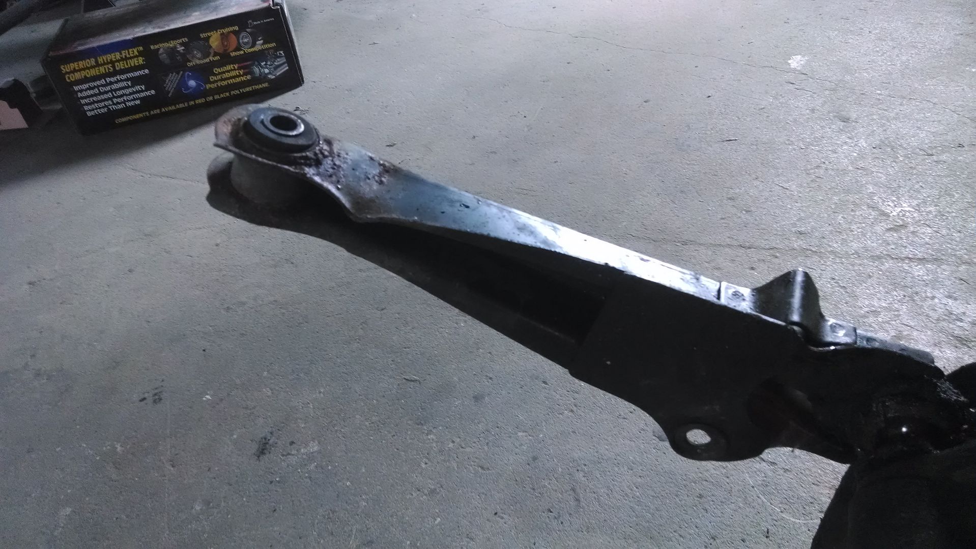

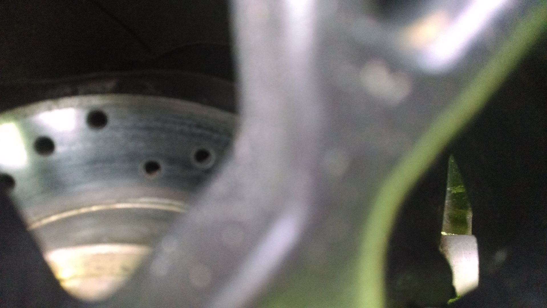

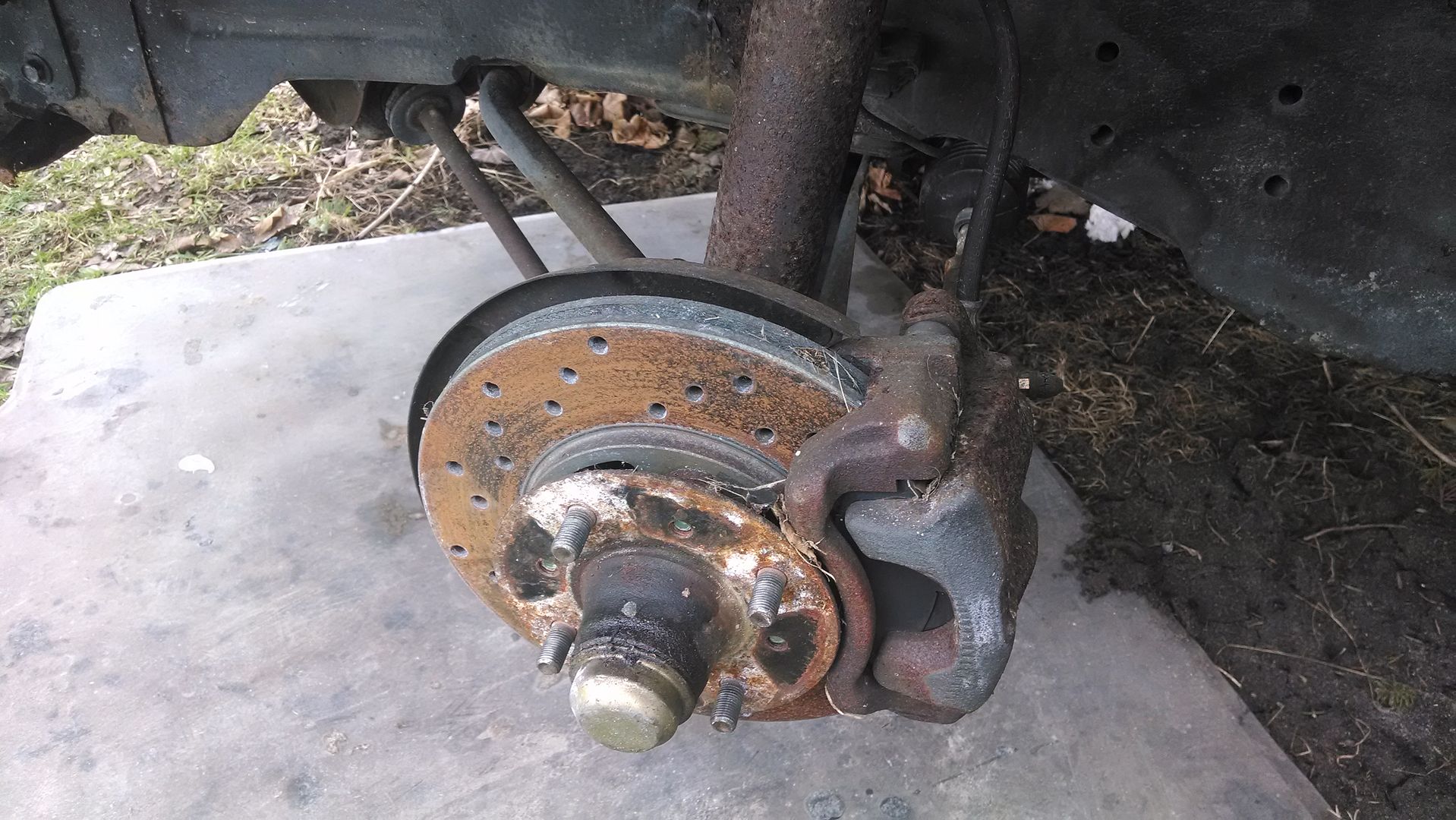

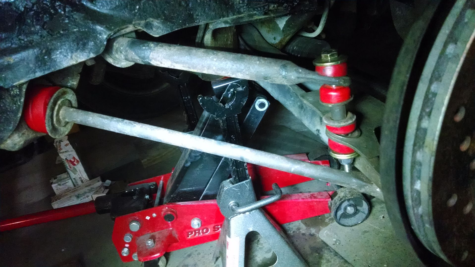

Brakes. Shocks. Bushings. Underway...
Driver's side requires the most labor, as I had to swap ball joints (new on the parts car) and a damage free LCA.
The torch was most definitely required.
Now onto the passenger's front!
After that, the rears take no time at all.
I'll update with more as it happens.
And some pictures of what I've been up to (explains the lack of updates)... The rough draft to some stone work, and a picture of my brother sailing the Moth! :cool:

Finished the brakes
Finished the bushings

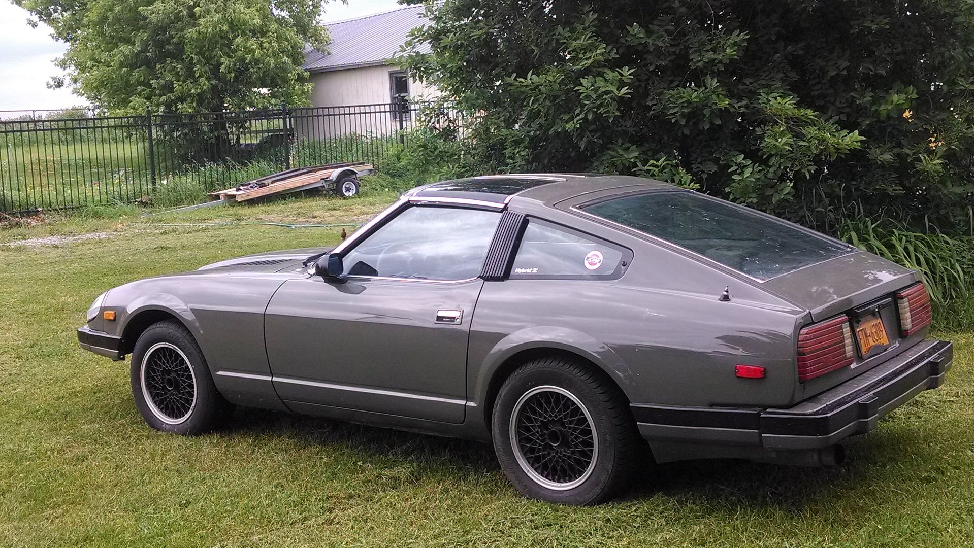

Some crap-tastic pictures. It'll look good with blacked out trim/handles.

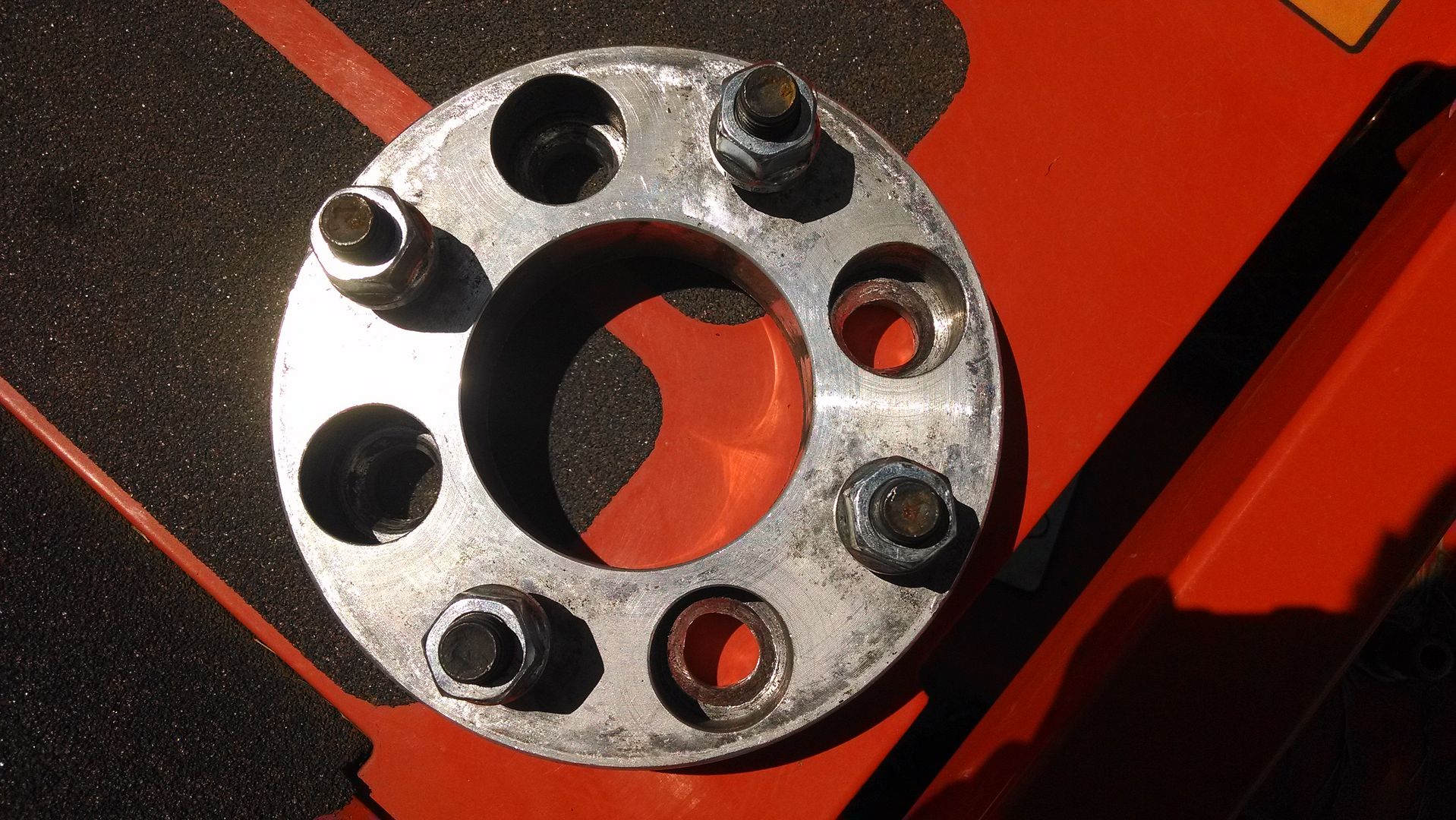

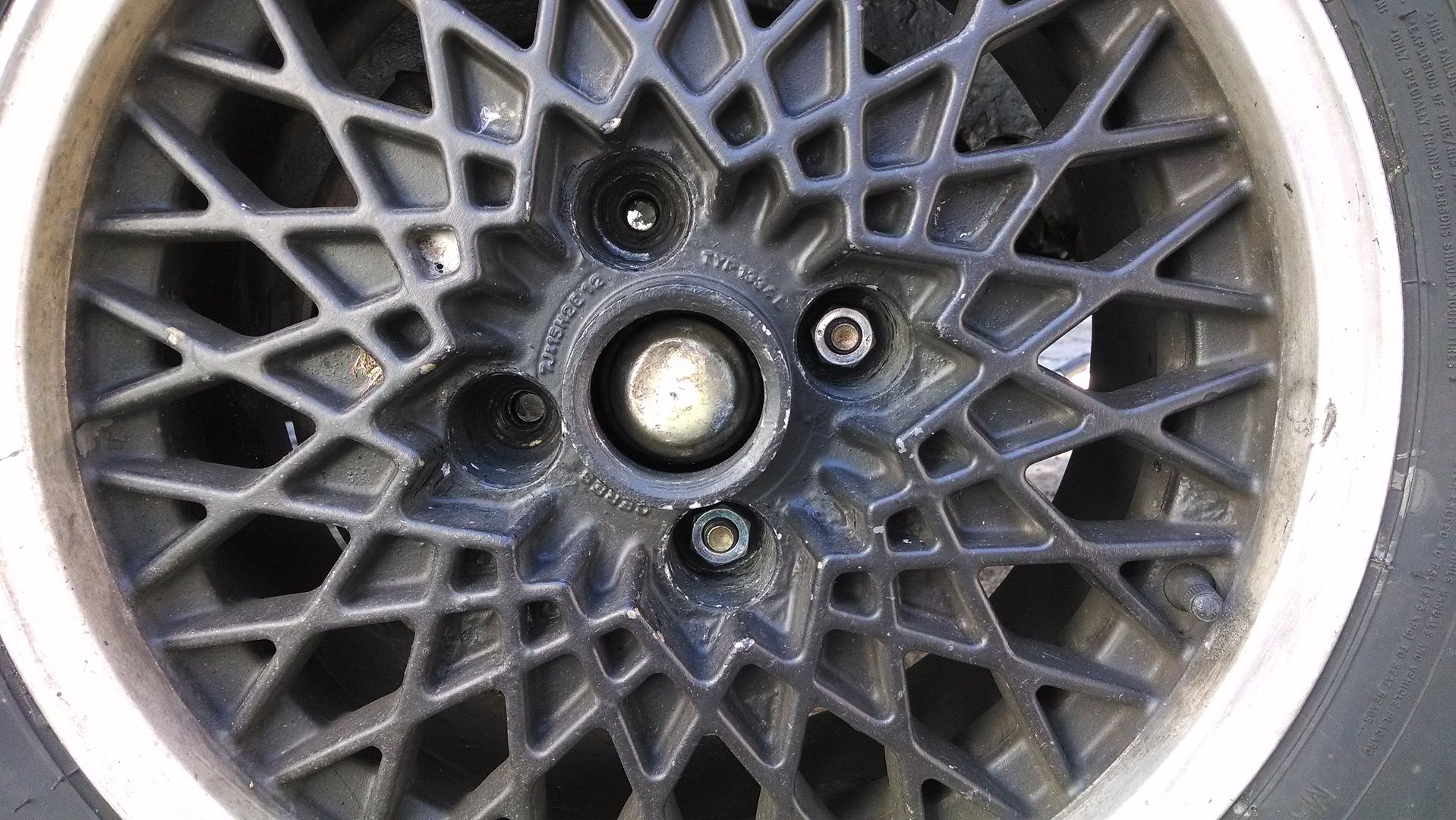

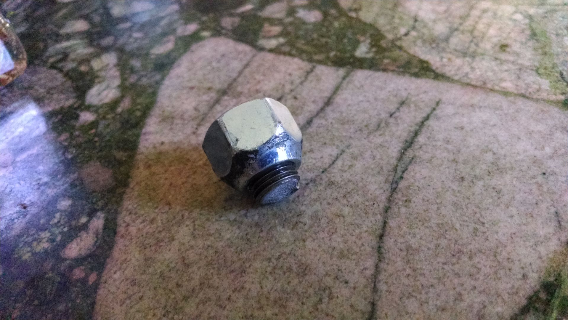

Well today was fun.
Inspection : (+$10)

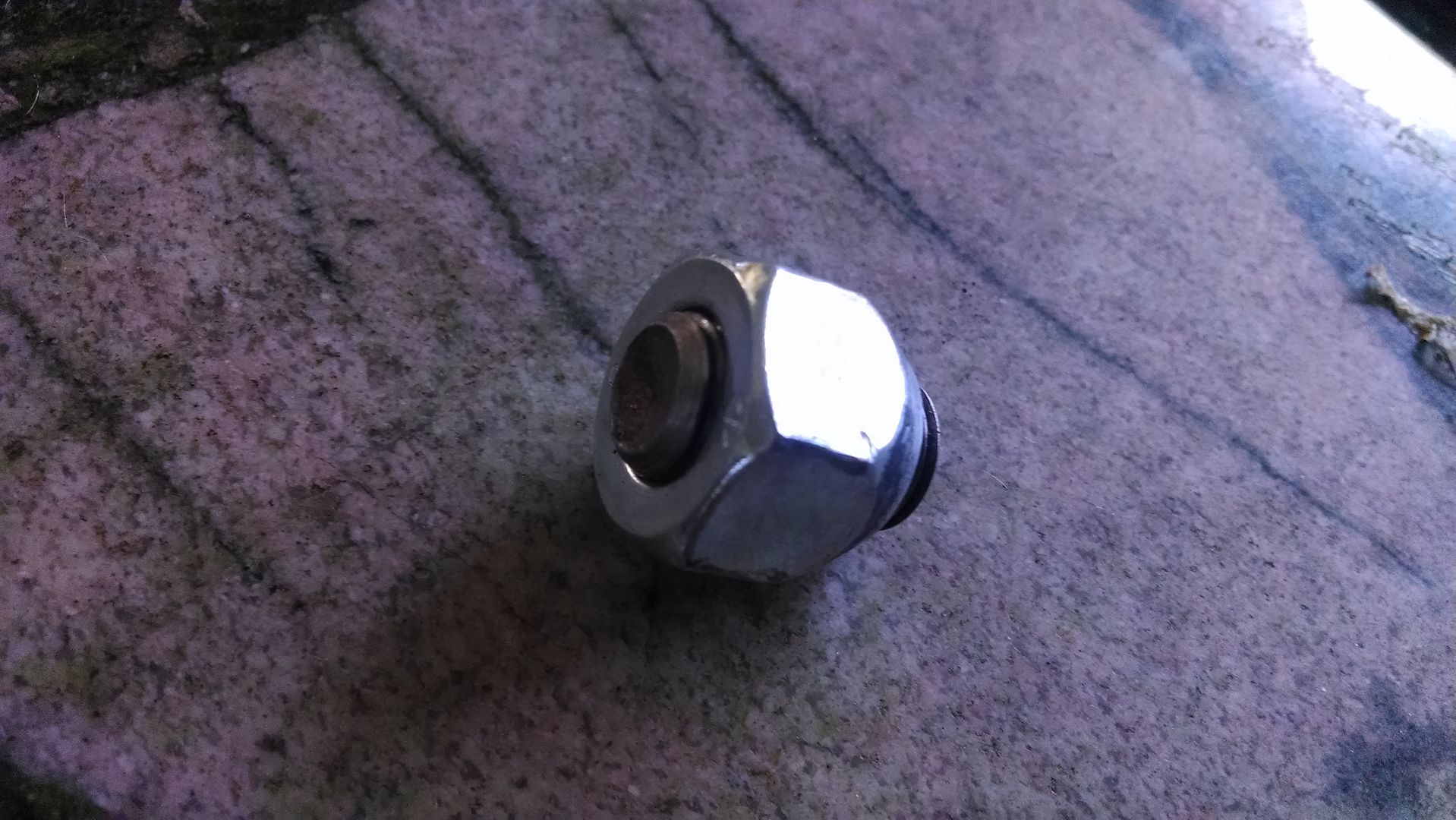

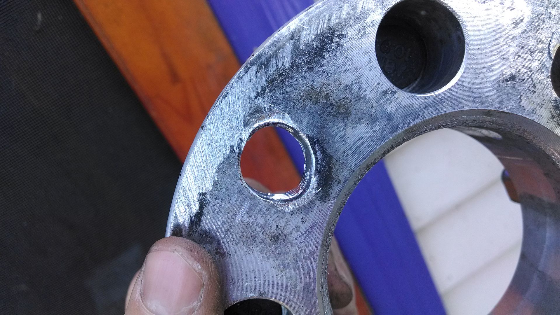

and oh yeah, F*** wheel spacers.
It (passenger's front) managed to wiggle loose, and shear TWO of the studs off. I'm lucky I didn't lose the wheel.
All that was holding it on were my hopes and dreams.
So I removed the spacer, which almost removed my wheel, and had to limp the car home like this. :eek: :eek:
The car is now back home, awaiting to be dealt with, but I'm going to go shingle my micro house/shed project this afternoon; Not feeling cars today.
The irony of passing inspection, and shearing two wheel studs off in the same day is pretty palpable. I certainly got a laugh out of it. :P

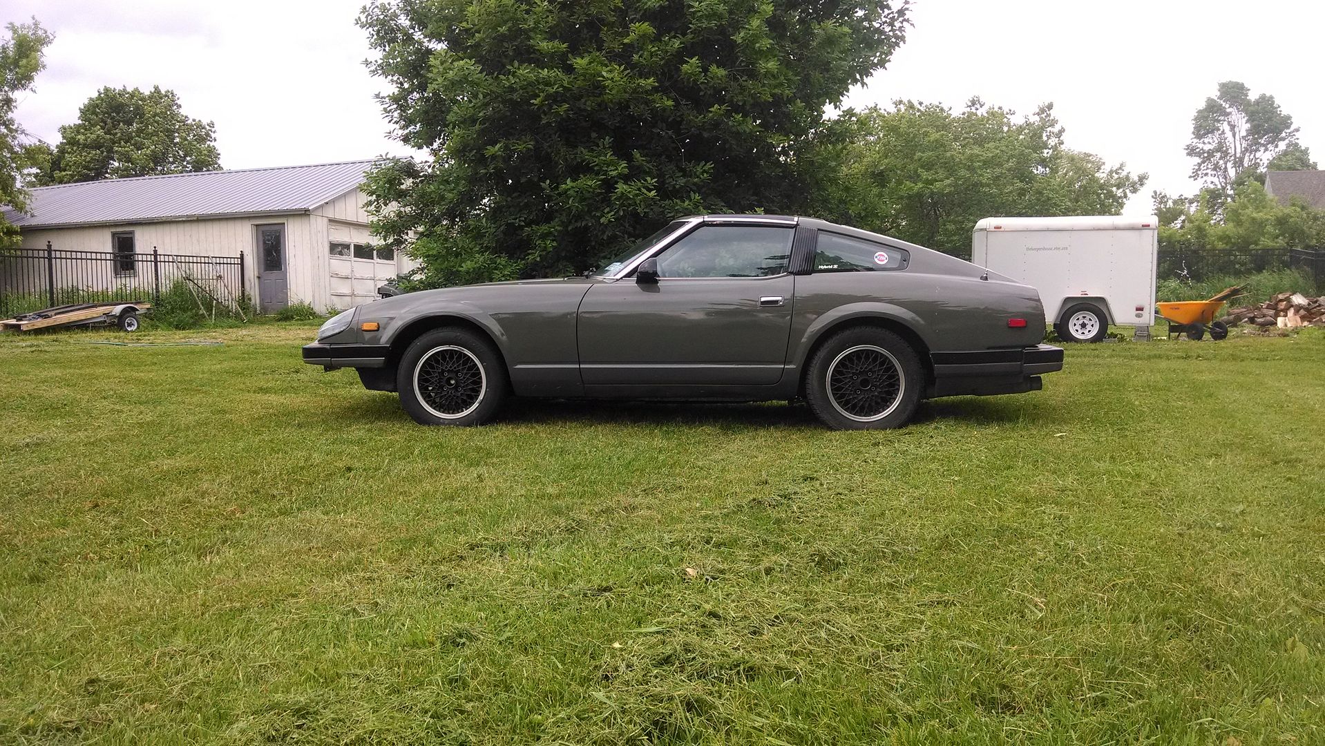

okay, I figured I'd bring this car up to date, as it has been a while.
Fixed the sheered off lugs, rebled the brakes. Man...
Car has been super reliable.

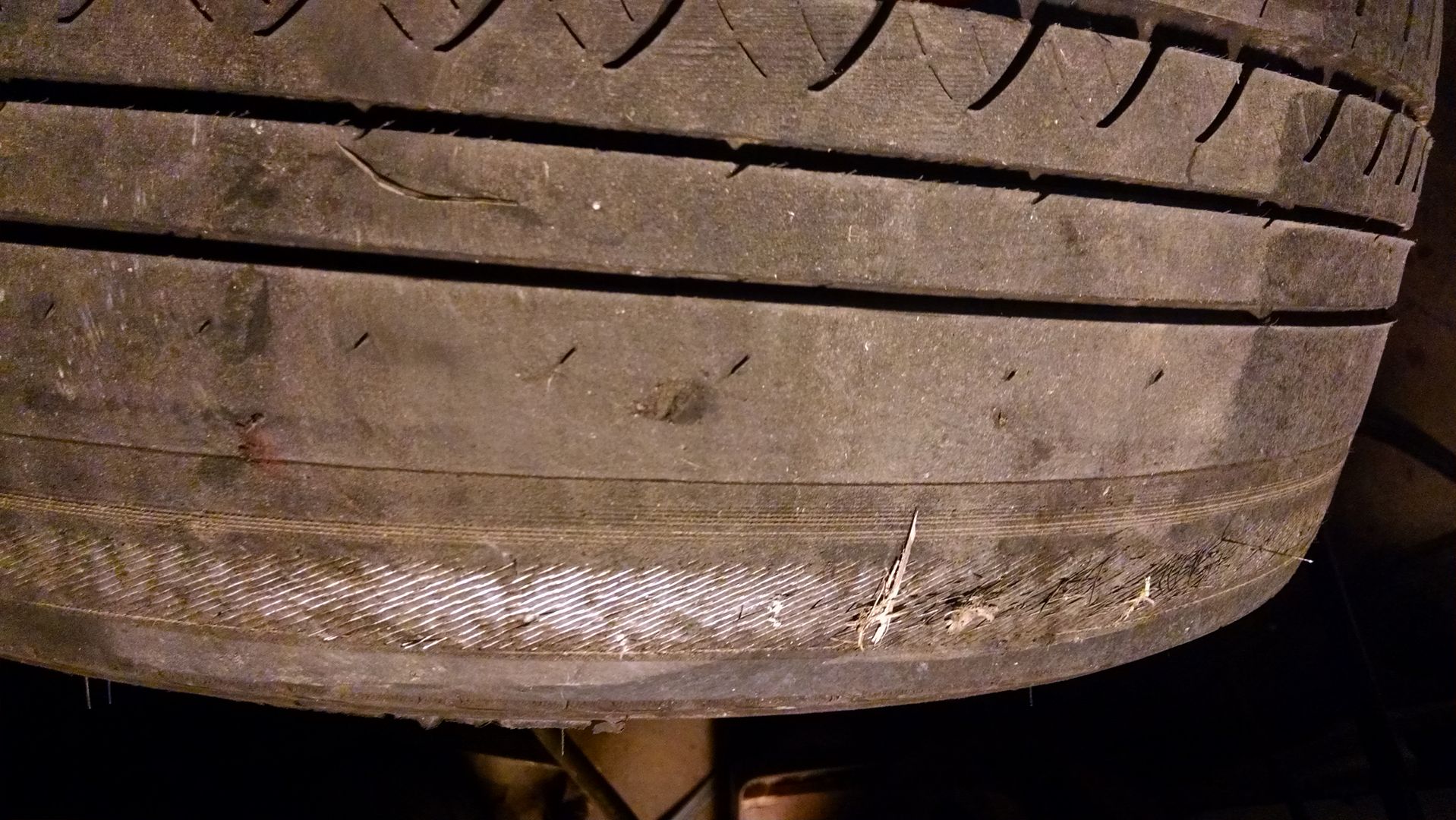

I finally have got around to fixing the alignment on the vehicle. I still need to tweak it slightly, but it is worlds better.
Now it wont do this in 2500 miles again. Haha.
I lost a trim piece somewhere along the way (Booo!). Had to shop the parts pile for my spare.... Still need to shoot it.

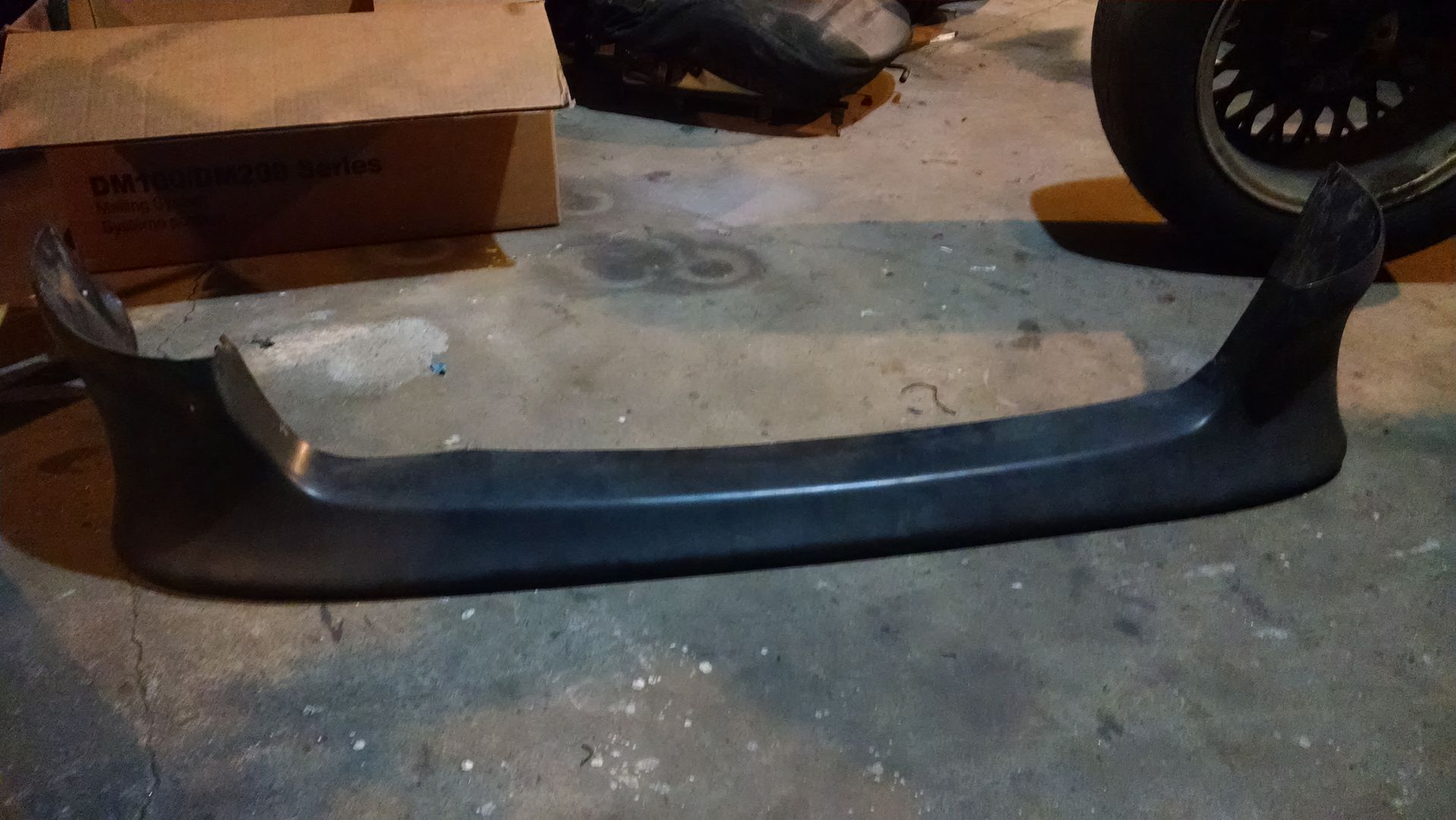

I bought a used front air dam. It was advertised for a 280zx, but it definitely is supposed to be on a 280z. - +$80 SHIPPED!!!! Got a scream of a deal on it.
I'll make it fit :)

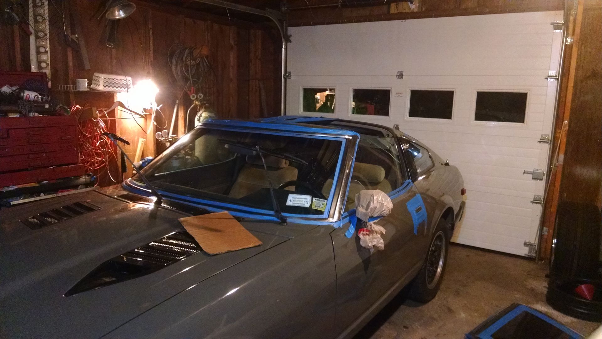

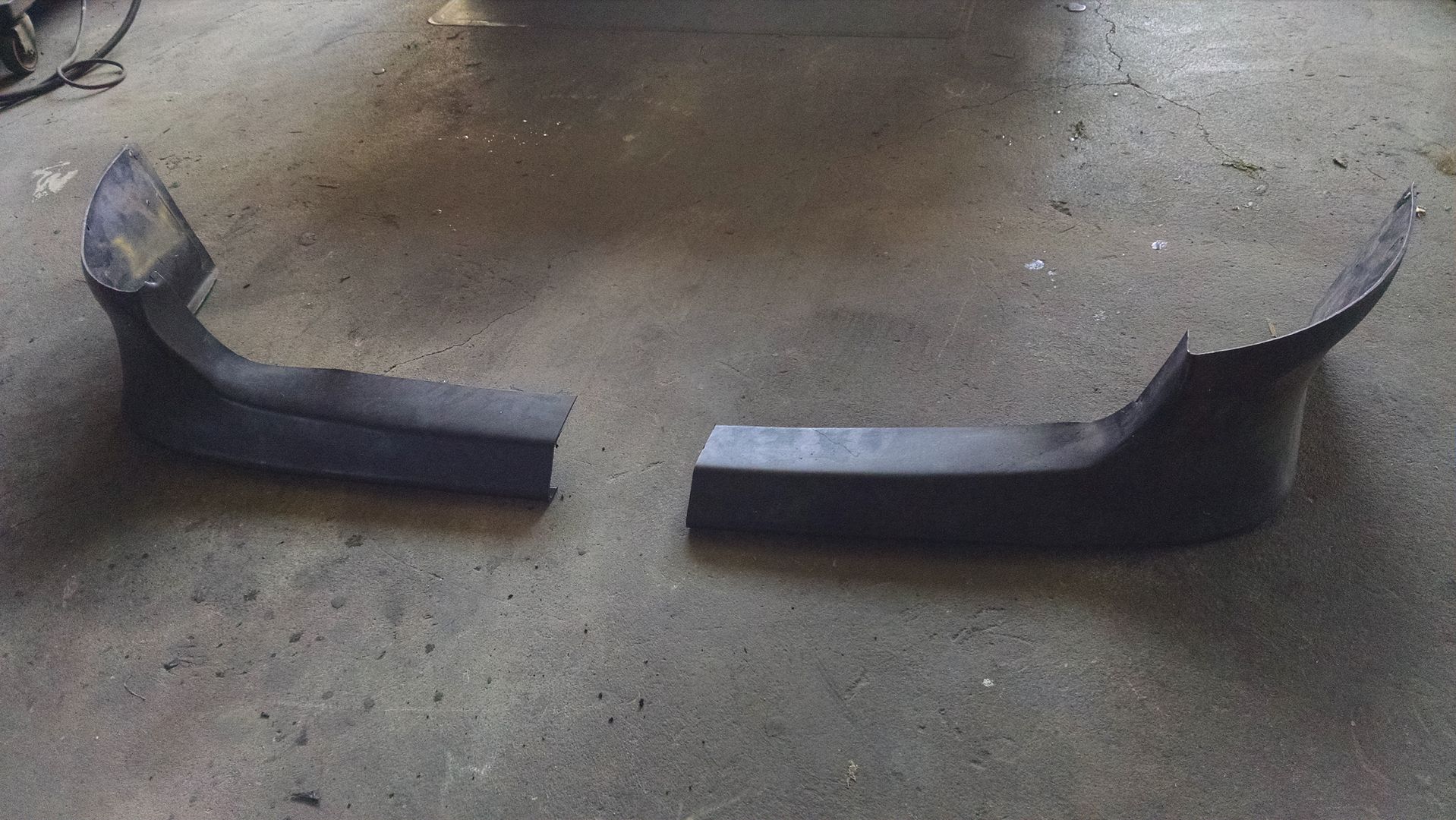

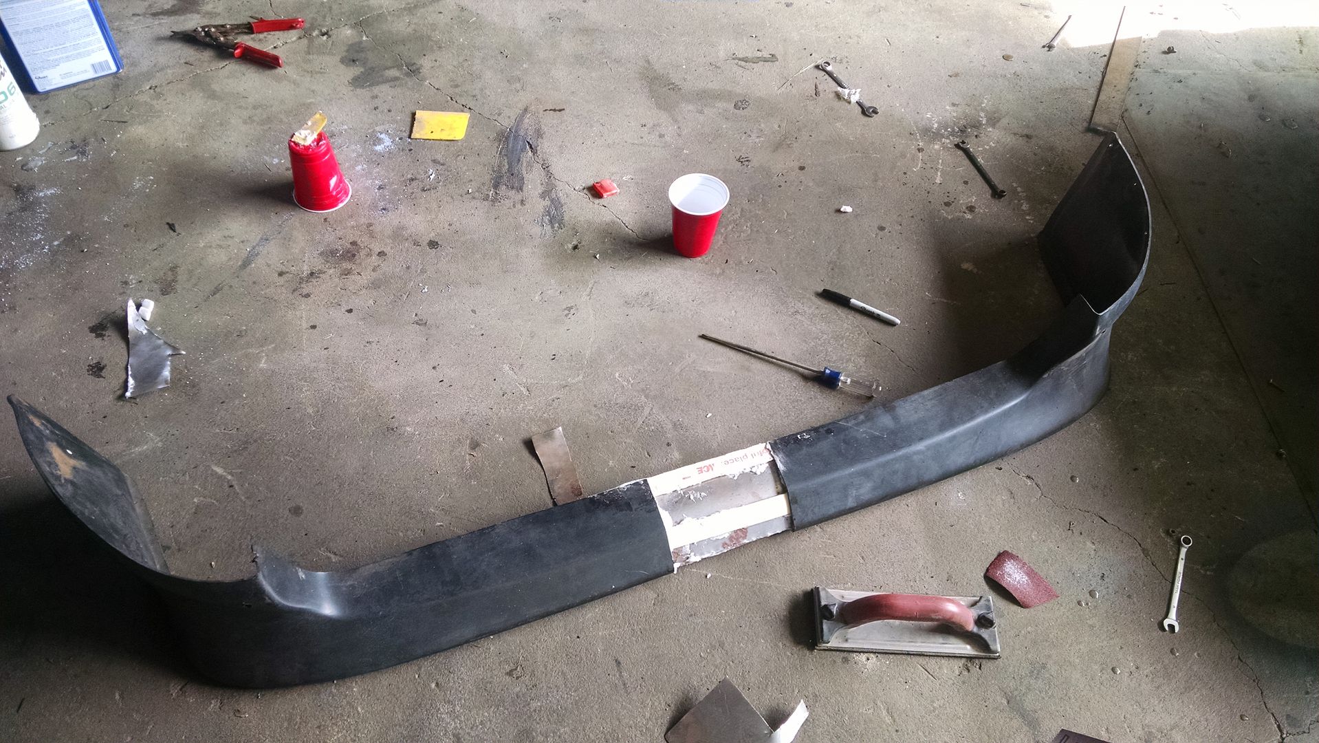

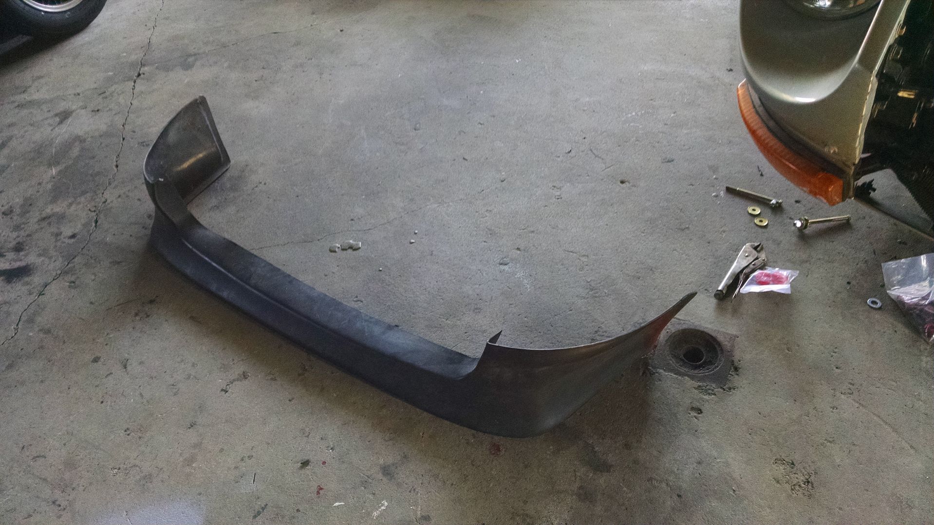

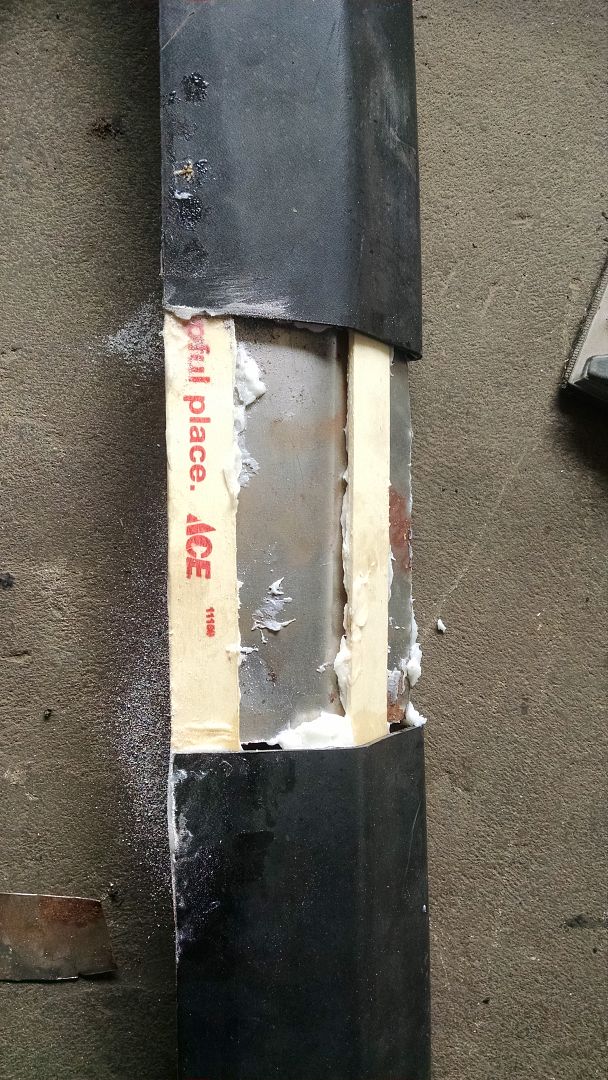

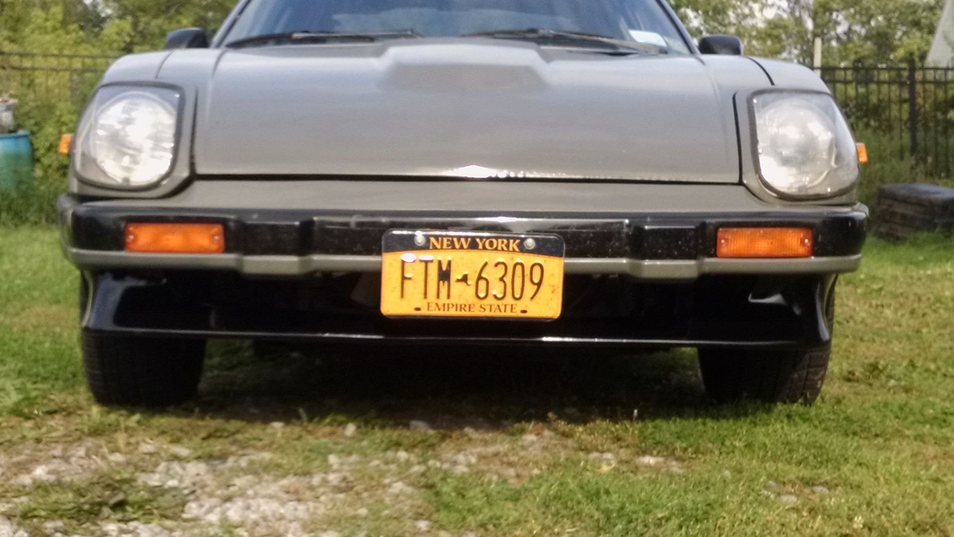

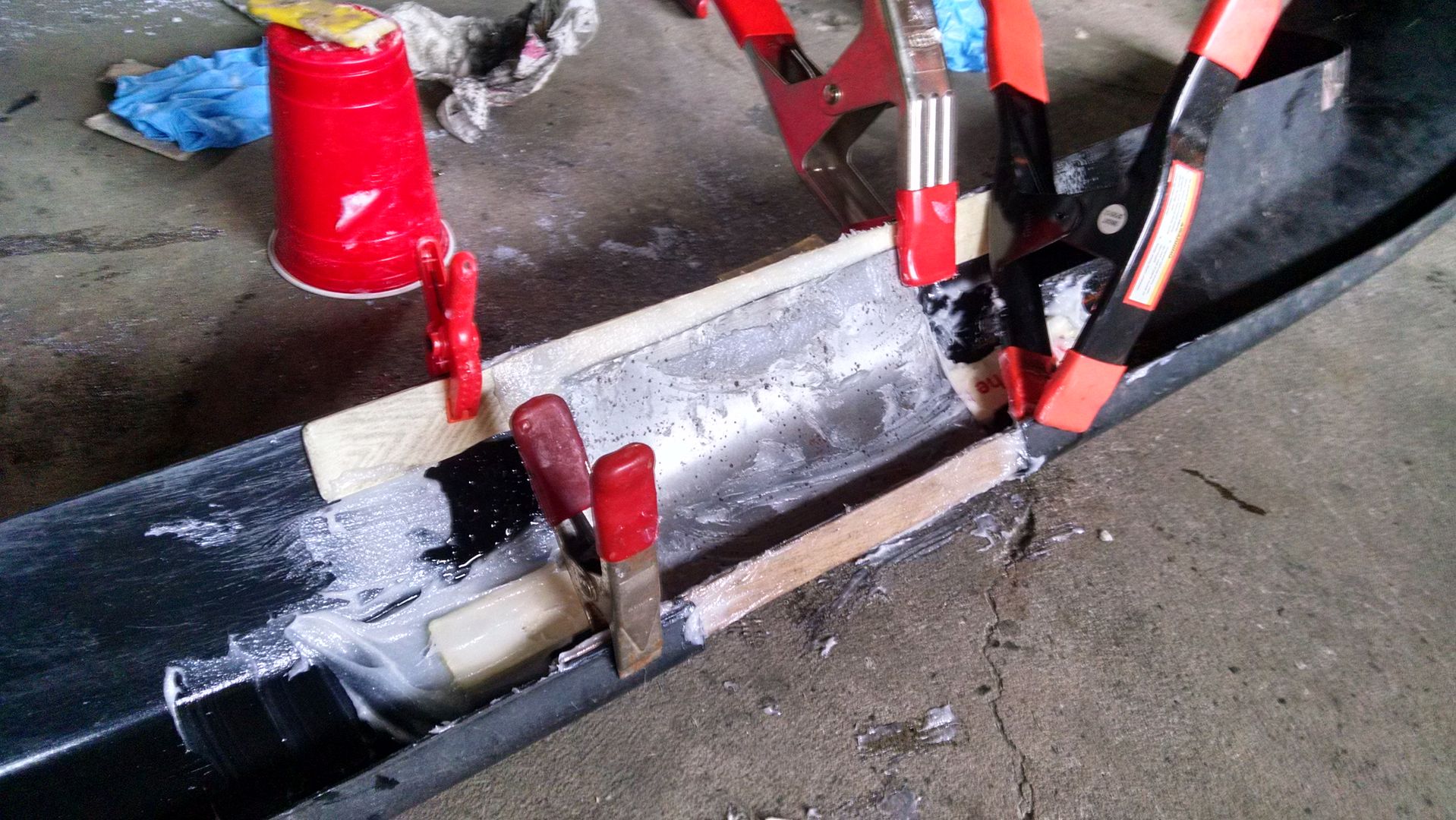

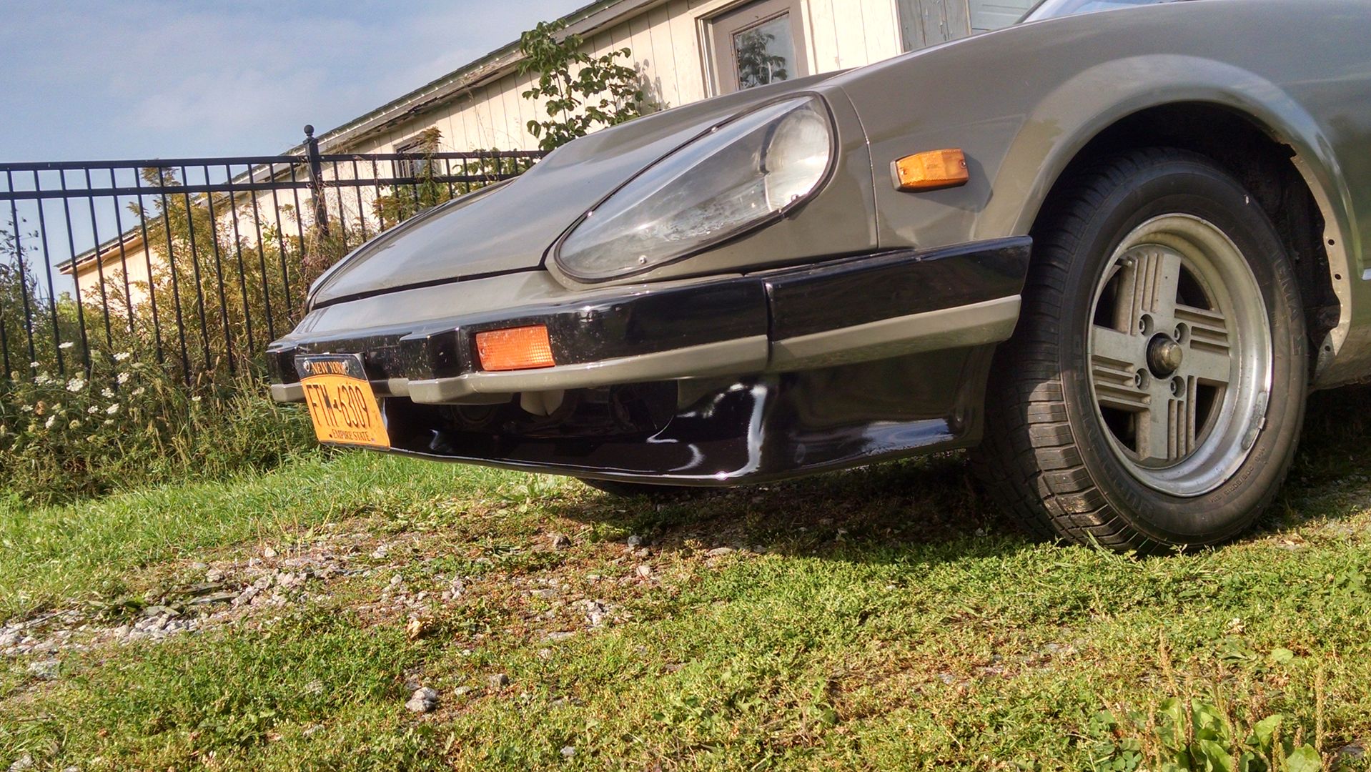

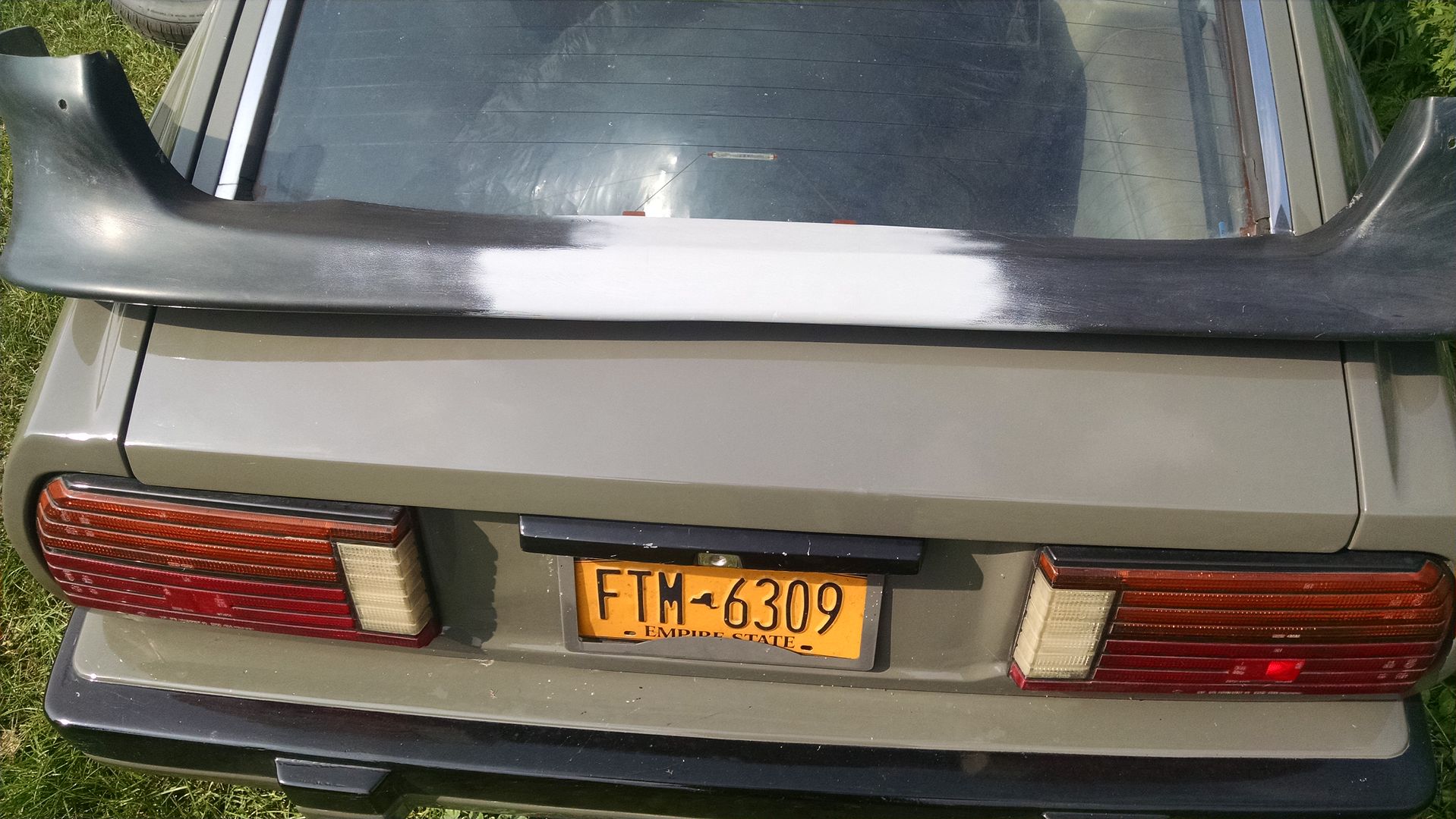

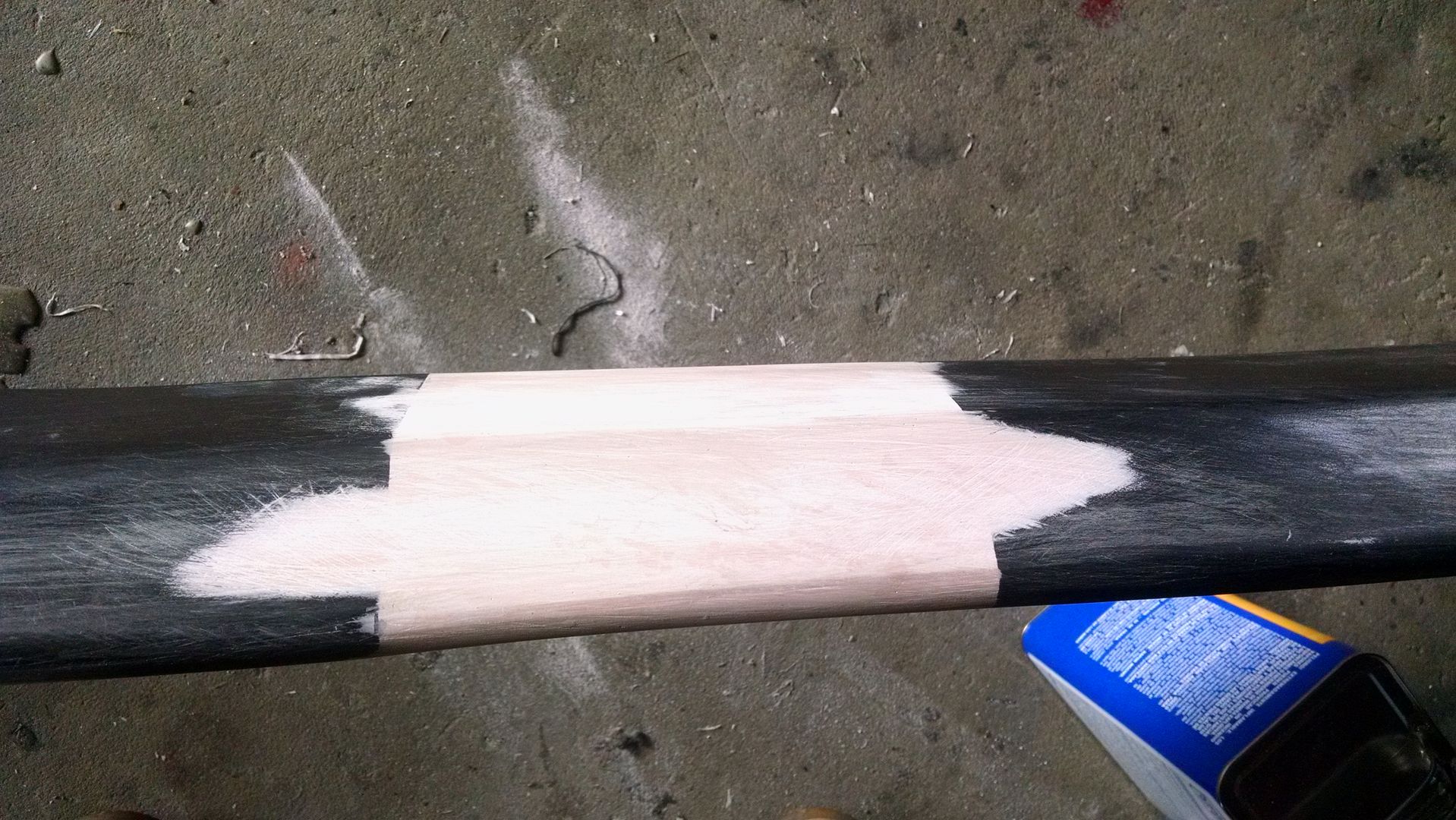

So yesterday and today I decided to do some.....budget composites! haha.

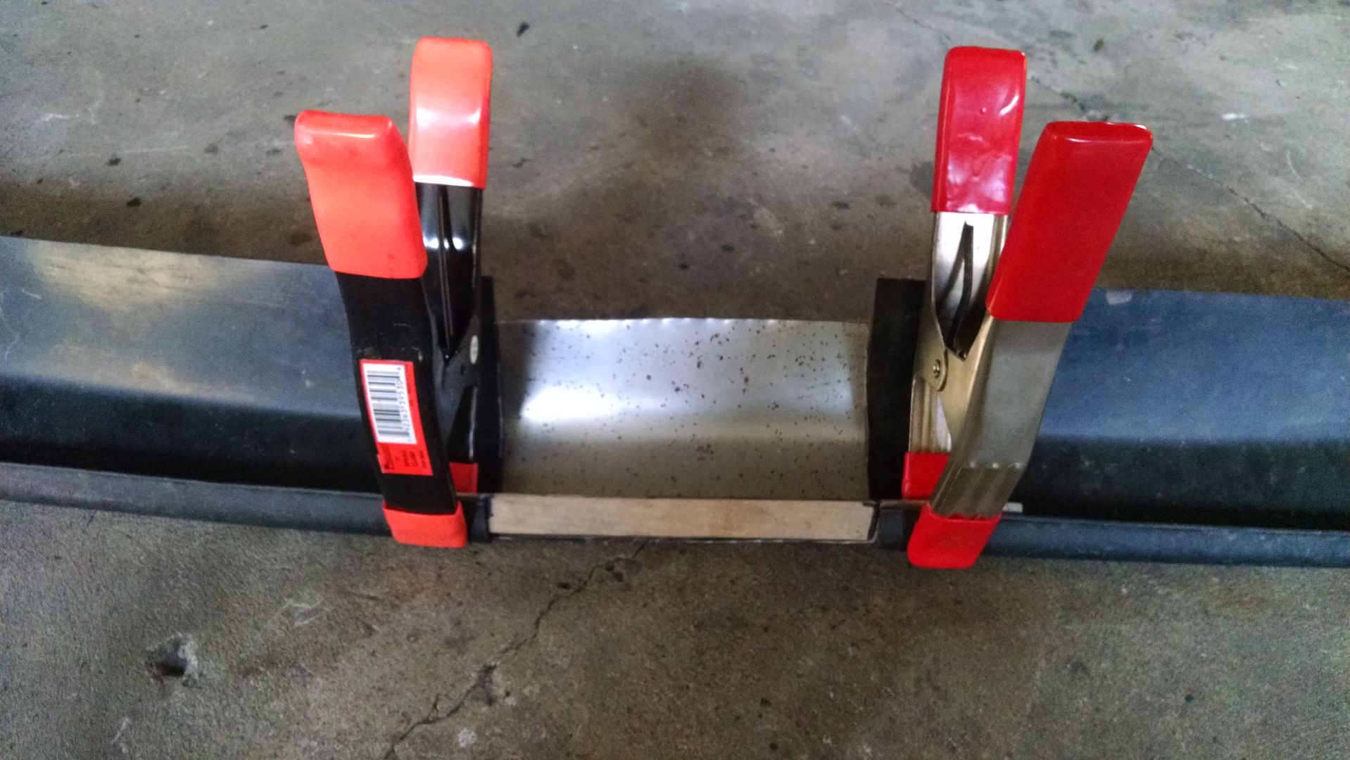

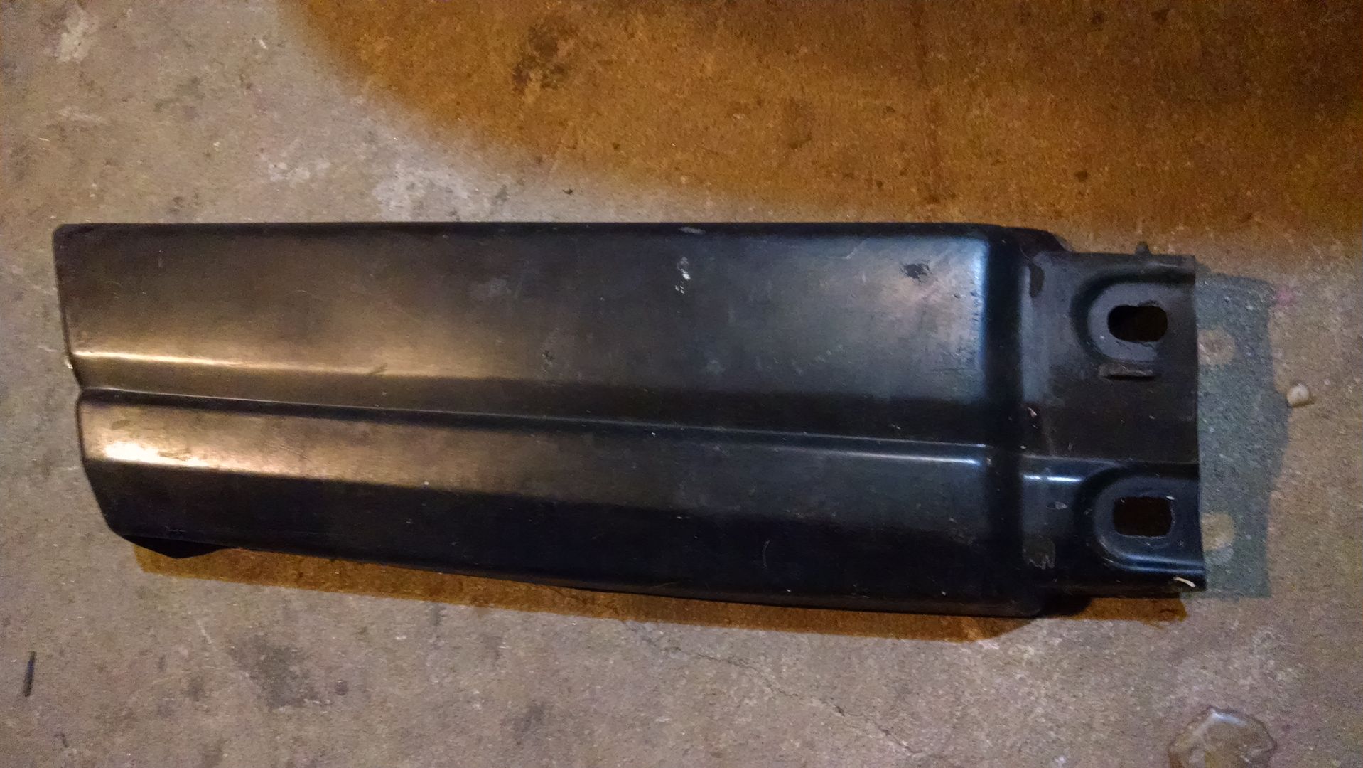

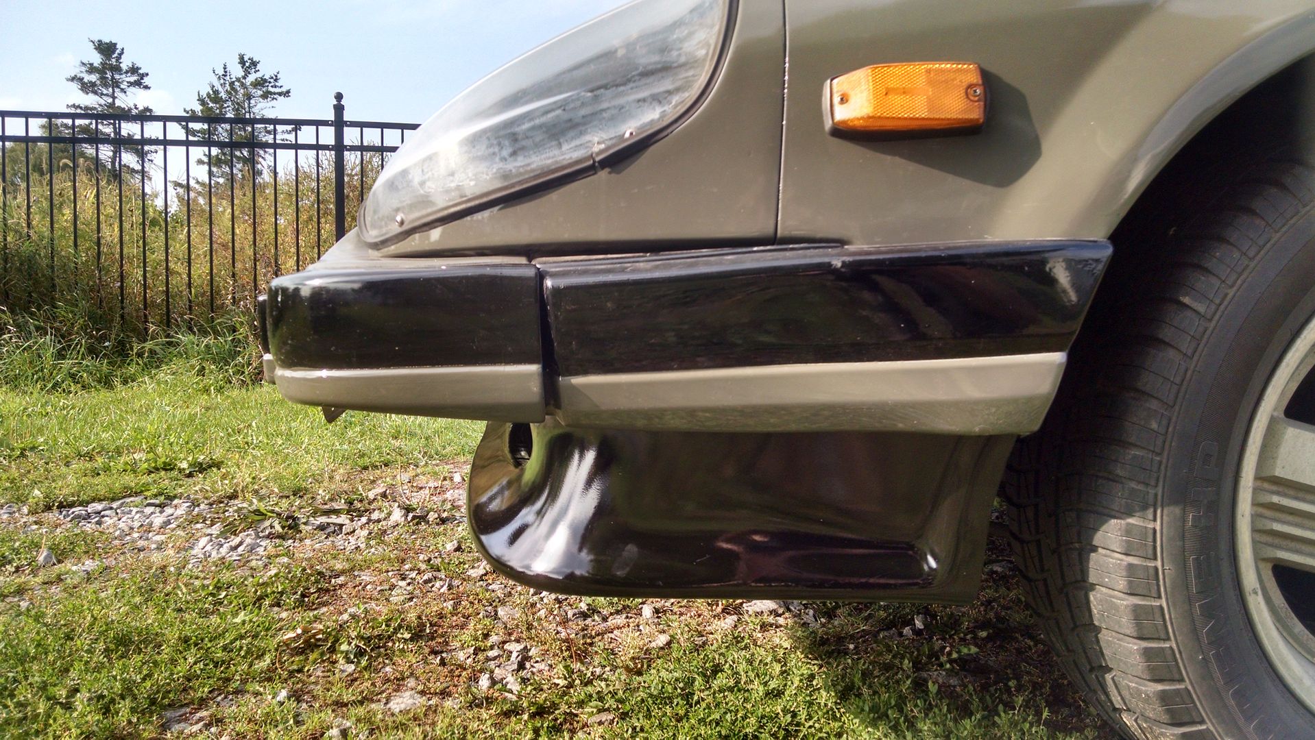

The air dam I recently purchased is designed for the s30, specifically a 280z. I did not know this until I received it.
It was only 80 dollars so I didn't mind either way. So I decided to make it fit. The majority of the body lines seemed to be appropriate, save the fact that it was about 8-10" too narrow.
Like I said. On a budget (all scrap materials utilized). Thank you ACE, you certainly were helpful! :laugh:
Epoxied
IMG_20140919_183552214_HDR_zpsq12otzil.j

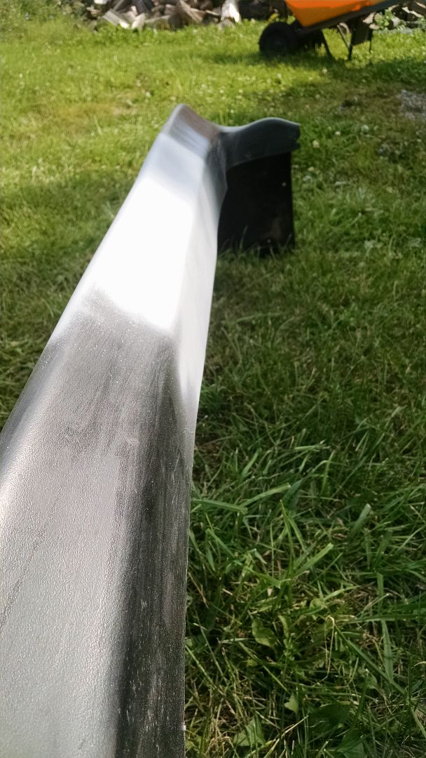

Some short strand fiberglass and a little body filler to make it roughly acceptable.
Primer

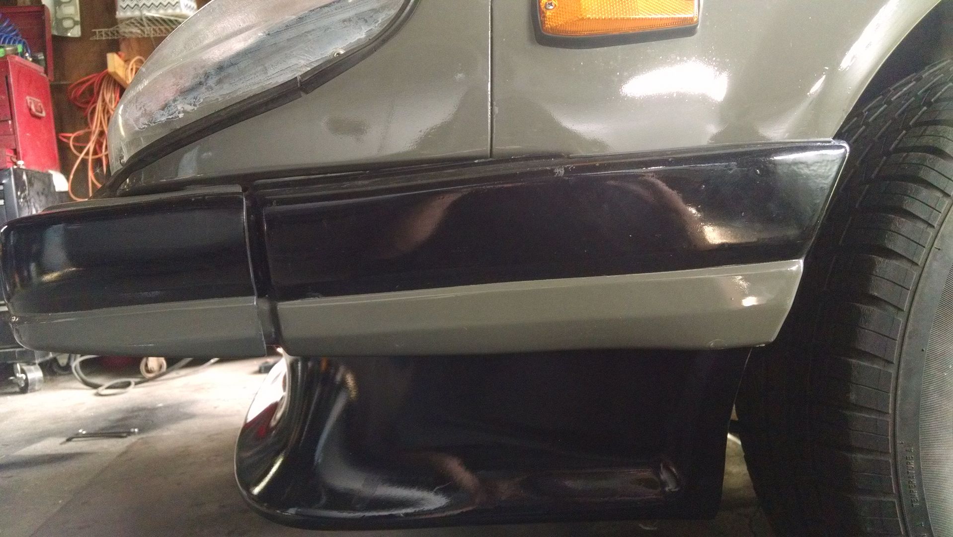

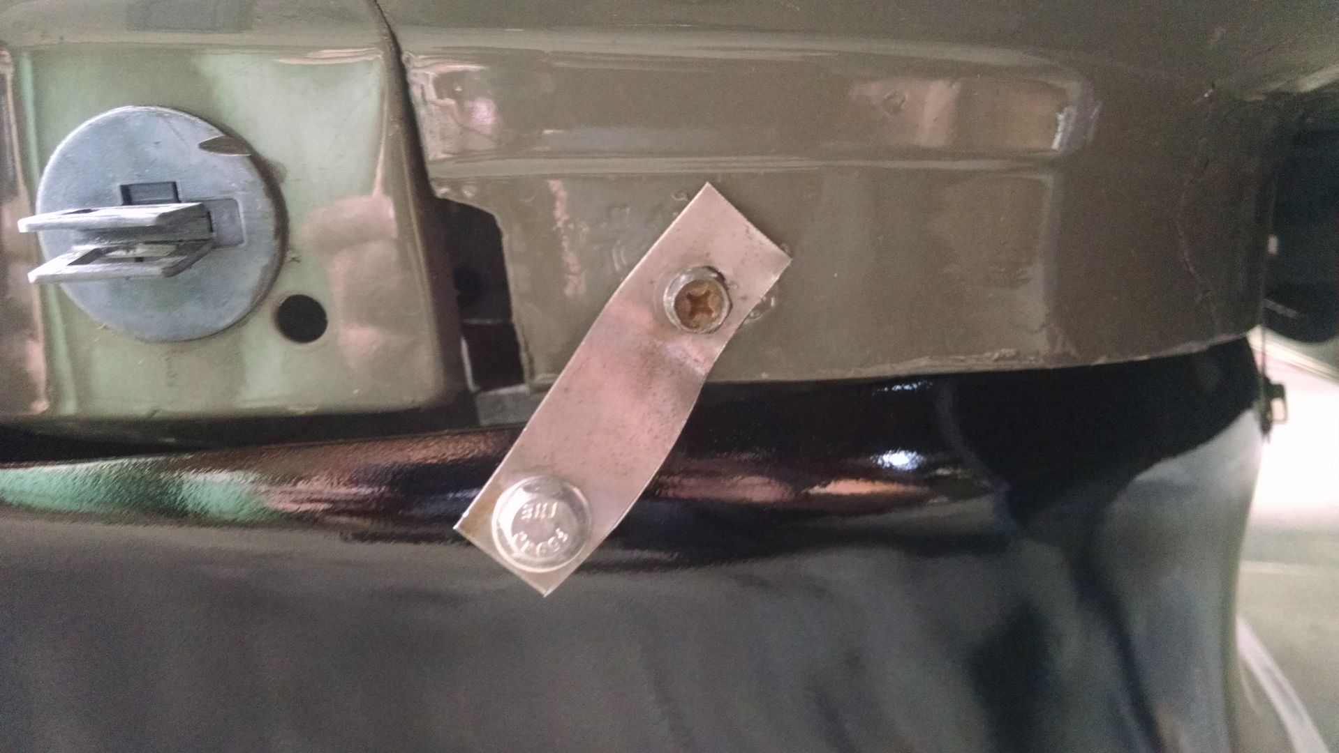

Some shoddy scrap 20 gauge steel brackets. hahaha. And despite what they look like, they are actually surprisingly strong.
I think it turned out pretty good. Actually, I giggle when I look at it, and think of what actually went in it. Some trash, and a couple paint sticks.
IMG_20140920_163433641_HDR_zpsq4an8xjp.j
IMG_20140920_163445225_HDR_zpslo9vsw4y.j
I don't normally abbreviate things, but LOLZ!

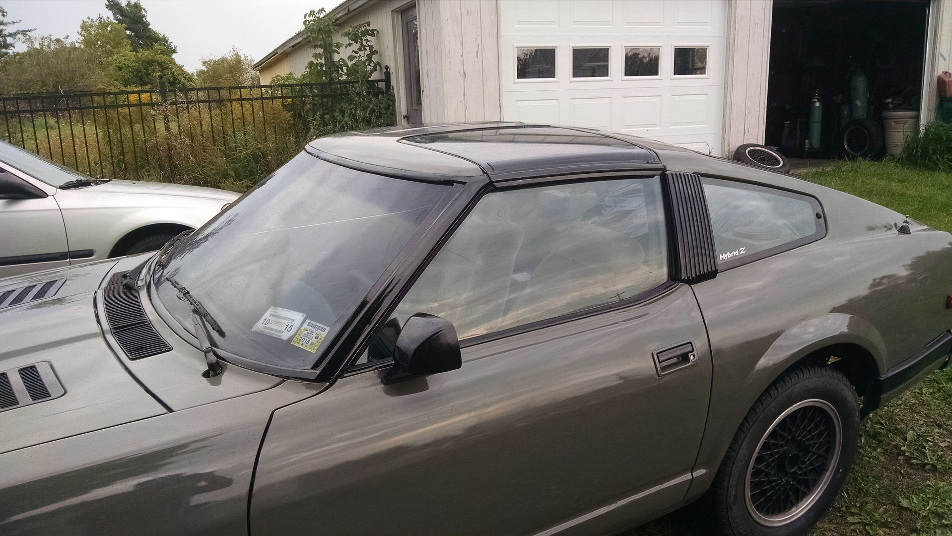

EDIT: And Tonight, I fooled around, and blacked out the trim.
I'll get better pictures in the morning.
Definitely changes the look.
I think it's going to look good. Time will tell.

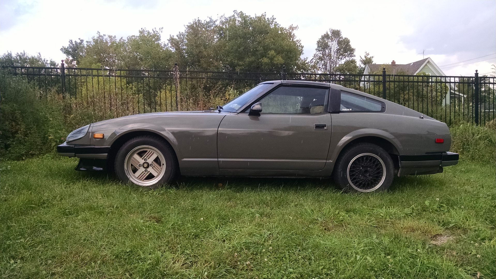

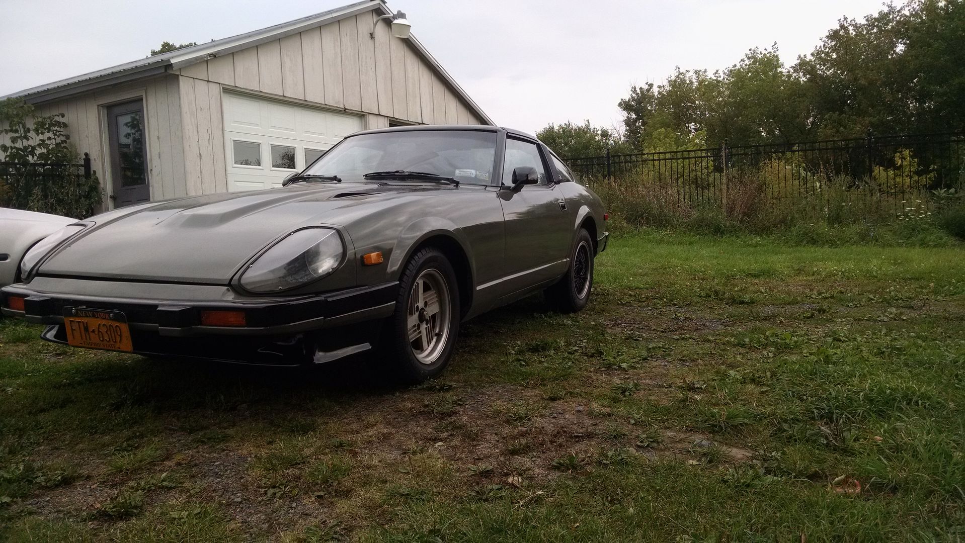

Some outside pictures. Blacked out trim with new air dam.

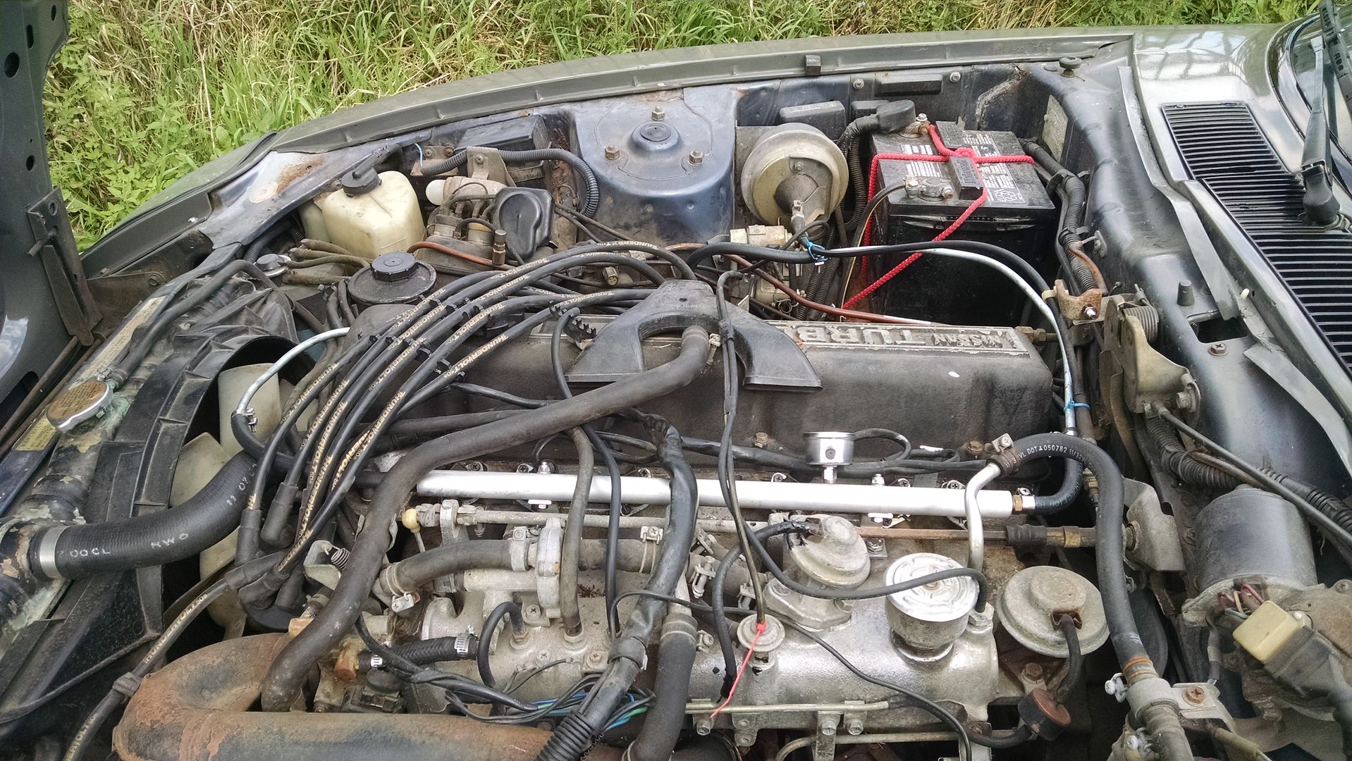

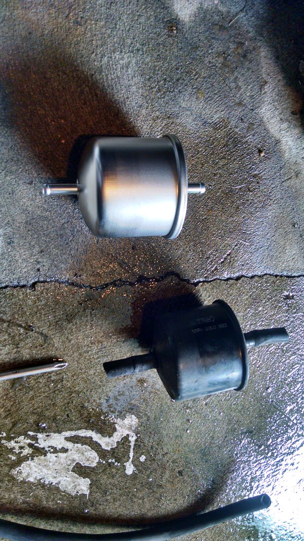

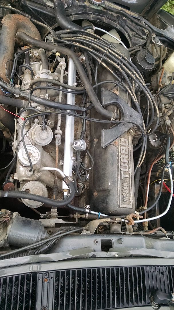

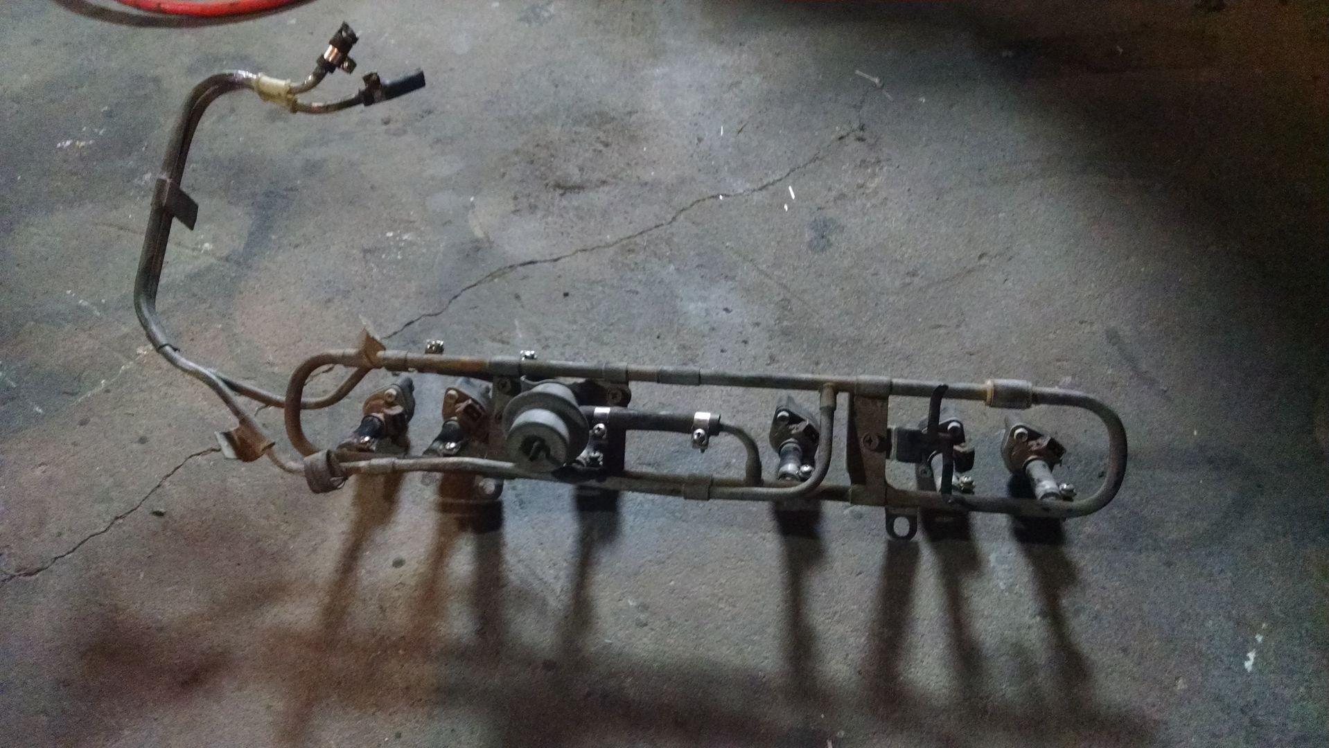

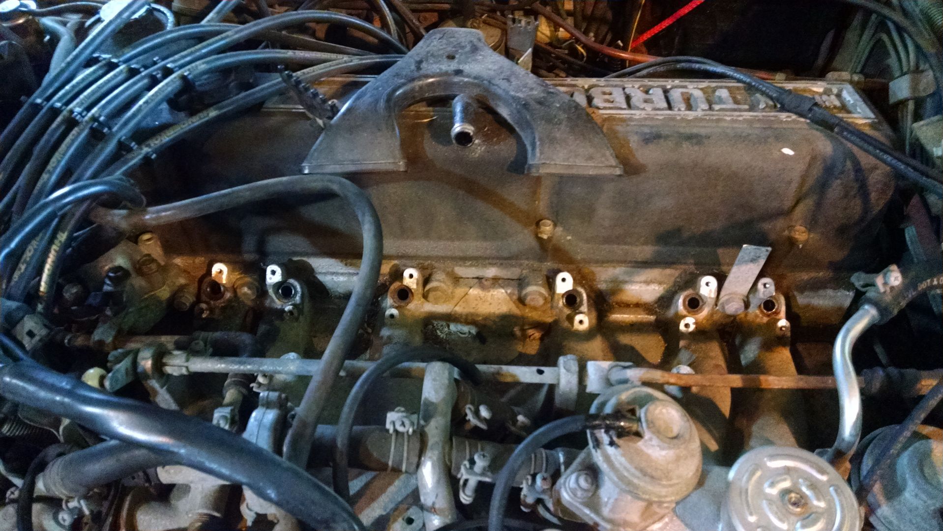

I took the earlier part of today and did some fuel system refresh.
New filter.
IMG_20140921_133100878_HDR_zpsvpzaxudg.j
New hoses.

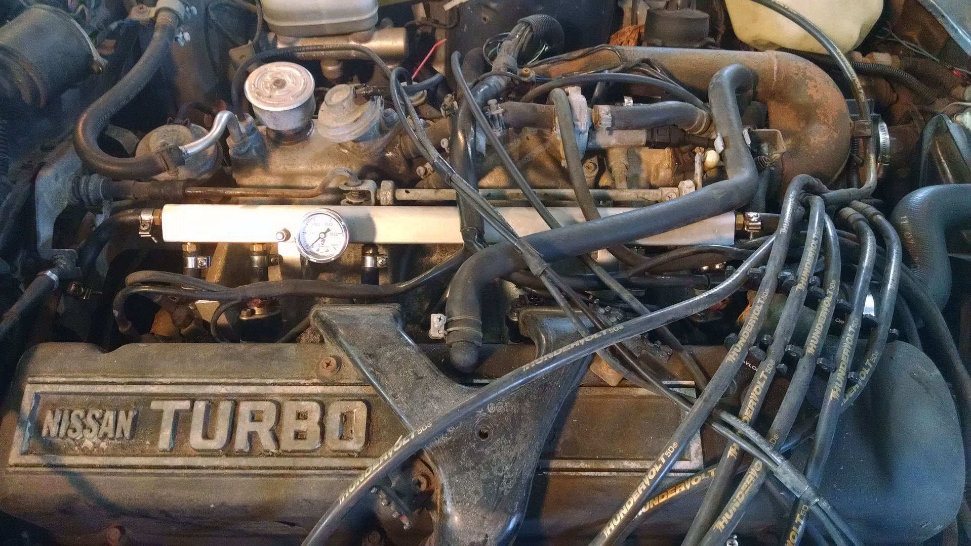

New fuel rail. Courtesy of the 240 build, which it no longer needs due to different style injectors.
Better condition injectors.
Old fuel rail out.

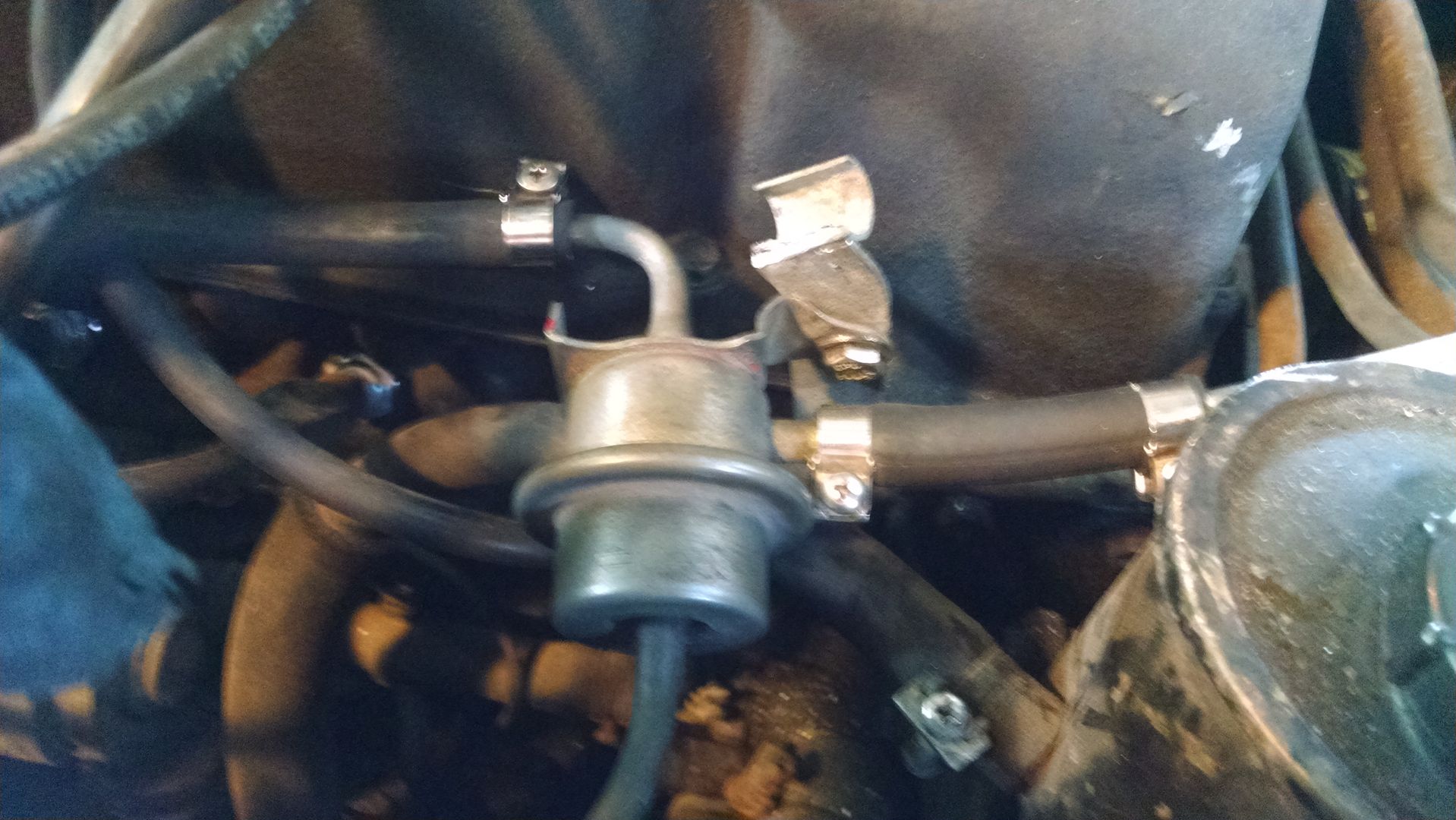

New fuel rail in. With some slight rerouting of lines, and the fuel pressure regulator.
And the car started right back up! Cool! Another thing off the list.
