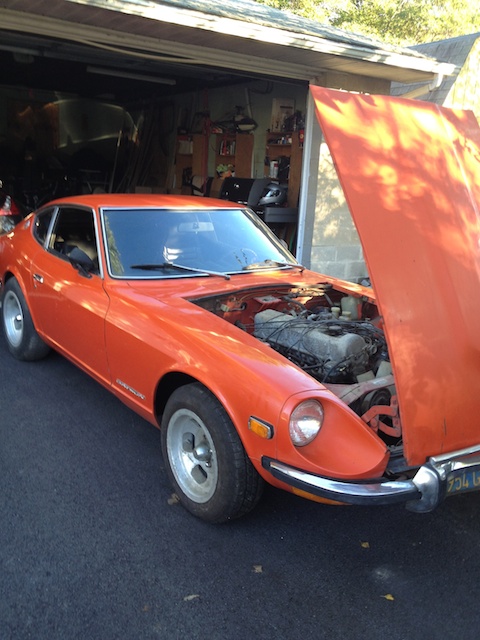

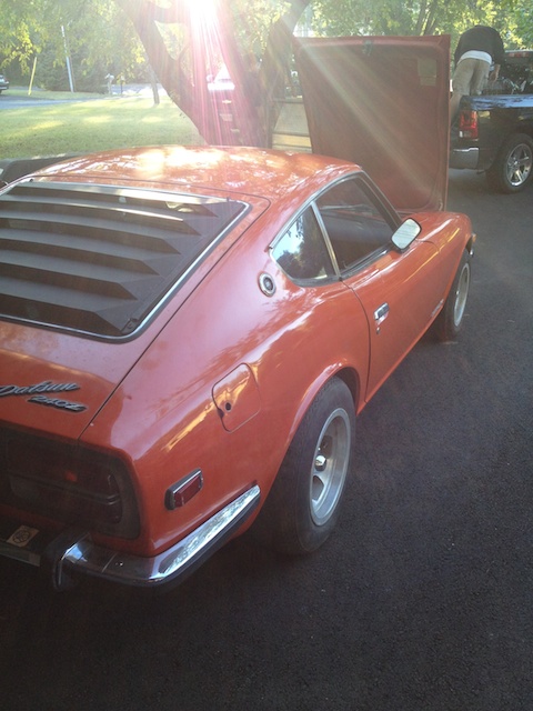

Kirkster Posted September 15, 2013 Share Posted September 15, 2013 Well I was finally able to go pick up a 73 240Z from my buddy. It was last on the road in 1984. My buddy picked it up from California in 2006 and it has been in one of his garages ever since. He referbed the interior, the suspension, and got the old L24 running but had problems with the tank being rusty and not getting clean fuel. So it went into storage... The Good... The car is absolutely rust free. It has just a tiny bit of surface rust in about an inch of the passenger floor in a seam and that is it... I went over it inside, outside, and under and it is clean clean clean... The bad... It has ding and dents on the body all over the place. The front bumper is fairly knackered. The hood has seen better days and the drivers front fender is not good (looks like someone beat on it with a bat). I was feeling a bit bad about what I am going to be doing to the car as it is soooo rust free, but with all of the dings and dents I am not feeling as bad about doing the flares with all the other body work I will be doing over the winter... I will be spending the fall/winter/early spring prepping the car for SCCA BSP autocrossing. My buddy provided a bunch of spare parts that basically replace anything with any issues, front drivers fender, gas flap with no hole, fairly pristine center console, etc... The best part is an L28 with only 40,000 miles on it that he gave me. He also gave me a Diff that he took out of his automatic Z when he turned it into a 10 second monster with a grand national engine. So I have the 3.54 diff that I needed for my build Here are some photos... The included a L28 motor. Which is what I needed for my build. With the N42 Head which I also wanted as it was the last of the 280Z cars before the 280ZX line which I can't use due to SCCA rules.. Finally, Here is the car with it garage mate... Yep... No brakes but the marginal parking brake, New brake lines are installed but not connected... I can't wait to get started, I would be working on it tomorrow but heading to the Ravens home opener... Quote Link to comment Share on other sites More sharing options...

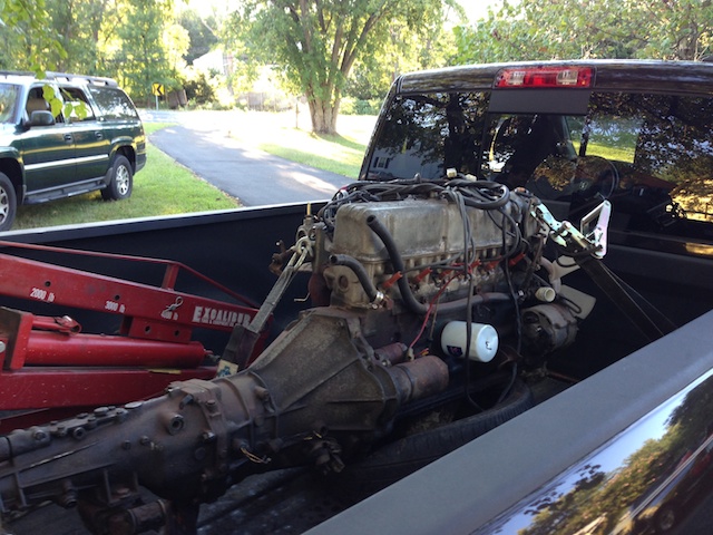

Kirkster Posted September 18, 2013 Author Share Posted September 18, 2013 Got the engine and tranny seperated. Got a few more feet of my garage back... I read through the strut sectioning faq as this looks to be my first project once the Coilover kit show up from MSA... I also have a full weatherproofing kit coming with all the soft rubber bits. Still looking for the best bushing kit as they are all coming out of the car and being replaced when I do the various suspension work and other bits. Any suggestions??? Quote Link to comment Share on other sites More sharing options...

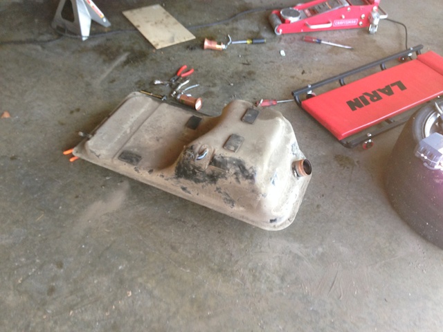

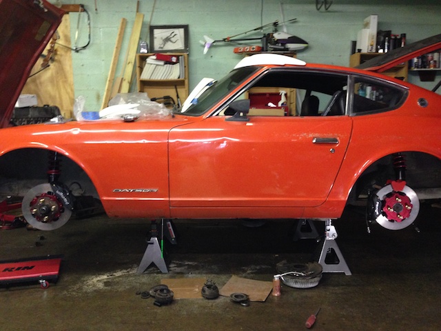

Kirkster Posted March 5, 2014 Author Share Posted March 5, 2014 So it has been a while since an update happened... I have been busy but have not put anything up here. So first things first the Wilwoods are on all four corners. Still have to finish sorting out the Arizona Z Car parking brakes. While I still had it on the stands I figured it was time to drop the gas tank. Of course all of the lines were dry rotted and I have ordered new ones. The tank is fairly rust free, just a little surface rust on the top which I will take care of once I Red-Kote the tank. My buddy who had this car was never able to get it to get clean fuel and seeing the bottom of the tank I can understand why... The issue is this... I have banged out a lot of this stuff, I figure that the gas that was in it in 1984 turned to sludge that subsequently hardened. More has been coming out when bang on the tank every weekend, not as much now but still some chunks. Not sure what I am going to do to finish cleaning out the tank. Not sure if I want to go to muriatic acid yet. Will try out Super Purple first and see how it does. Next up was the wheels. Well after lots of talking to a few very knowledgable autocrossers and car builders for autocrossing they finally talked me into 18s. So I ordered up a set of 18X10s on Dec 31st... And yes those are the Marugen Shoukai ZG flares as I did not want to fool with the ill fitting flares that are floating around... I still need to get some photos up in the Marugen thread in the group buy section... I spend most of last night reading Mike Kelly's build thread so I will be putting these up pretty high as I have to have wheel travel to accommodate 18 inch wheels (pretty much the same ones MiKelly is running except mine are classics) Big thanks for posting up those details MiKelly. I was super stoked that when I put them on the car there was no rubbing on the suspension (I had figured on needing half inch spacers in the front), the fronts do rub on the front edge of the front fender and I will have to trim that when I do the fender flares. but other than that no fitment issues. I may have some weird toe issues in rear and the front definitely needs an alignment but that will come once I have the car running. Seaking of getting things running. I have been cleaning up the 77 280Z motor and stripping all of the emissions crap off of the engine as well as the fan and whatnot... I am still waiting on my buddy to ship me the 82-83 dizzy he has on the shelf, as well oil pump / dizzy shaft that is eluding him at the moment. I have a center force clutch and a fidanza lightweight flywheel to finish off the transmission. Then it will be time to start putting all of this stuff into the car along with the 77 280 motor. I have spent a lot of time reading the MS3-Pro manual and trying to figure it all out. I have my work cut out for me in wiring this up as I have no clue what I am doing when it comes to getting power from the ignition key I am sure I will be posting up some questions in the future in the EMS section of the forum, especially when it comes time to get the base map figured out... It is getting exciting seeing things come together and hopefully be on the road in a month or so for some autocrosses. Now it just has to get warm here so I can coat the fuel tank with Red-Kote. Plus there are a ton of little details waiting to bite me in the ass of that I am sure... Quote Link to comment Share on other sites More sharing options...
hwvigo Posted March 5, 2014 Share Posted March 5, 2014 Looking great so far keep it up, And I love those wheels. Quote Link to comment Share on other sites More sharing options...

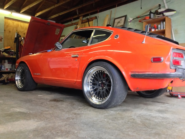

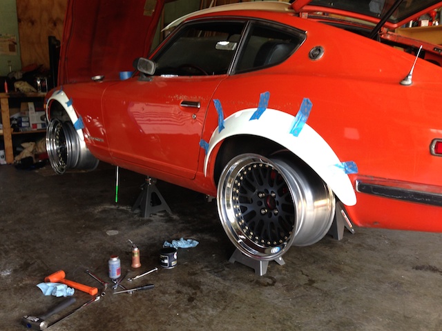

Ryan Merrill Posted March 5, 2014 Share Posted March 5, 2014 Looking great! Those are the wide flares by the look of it. What rims offset did you go with? The flares fit perfect? Quote Link to comment Share on other sites More sharing options...
Kirkster Posted March 5, 2014 Author Share Posted March 5, 2014 Looking great! Those are the wide flares by the look of it. What rims offset did you go with? The flares fit perfect? Yes, they are the wide flares. I also have the normal flares but don't know which ones I will finally put on. The wheels are a little tucked in with the wide flares. I went with 18X10s all the way around with a 5.5 inch backspacing... Though for sure I would need a spacer up front but even with the 285/30 Hoosier A6 the tire is not rubbing the springs or suspension. Quote Link to comment Share on other sites More sharing options...

RebekahsZ Posted July 25, 2014 Share Posted July 25, 2014 Consider having your tank cut open (a big hole) to clean it out. I NEVER could get all those flakes of resin out of mine and it was a pita and stranded me regularly. Not only did the filter get plugged, but the line was usually plugged too. I pulled tank on four separate occasions for cleaning by a radiator shop with a variety of chemicals but the vertical wall in the tank made it impossible to w rinse all the crap out. Cutting a huge hole in it let me get it clean after I had access to both sides of the vertical wall. Quote Link to comment Share on other sites More sharing options...
