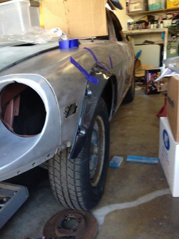

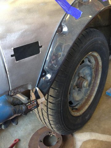

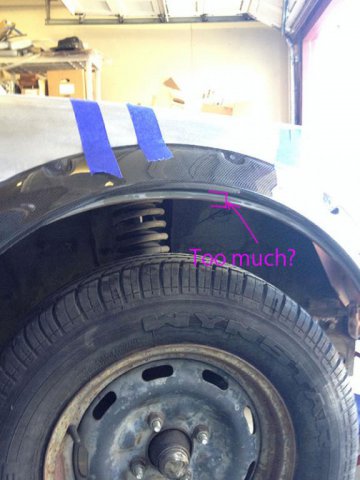

tamo3 Posted October 17, 2013 Share Posted October 17, 2013 I'm about install ZG flare. I bought my flare from www.restored.jp When I test fit the flare, it looks like it way high and I can see the top part of the original fender arche under the ZG flare from the side. front part and rear part fitment is in the perfect location, I guess. I know I should have install coilover and right wheel to find out fitment, but I haven't decide which wheel I should get. I want to paint body before install front coilover kit. I'd like to get your advice based on your ZG flare installation! Thanks, tamo3 Quote Link to comment Share on other sites More sharing options...

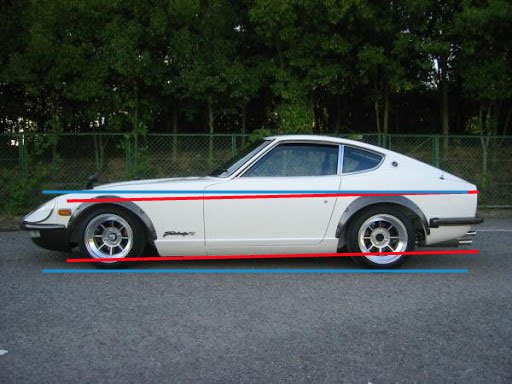

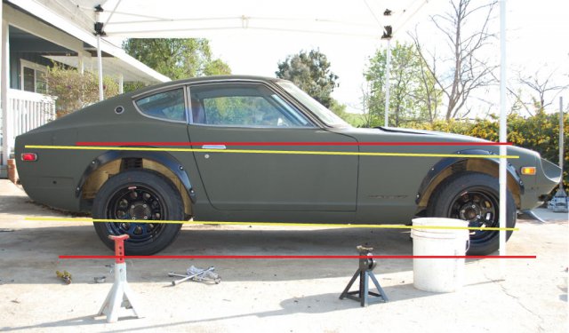

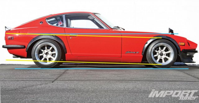

JMortensen Posted October 17, 2013 Share Posted October 17, 2013 Be careful on the rears. I'd say 90% of people with these flares have them mounted too low in the back. Read the linked threads, particularly Austin's thread here on hybrid z. He had to redo the rears because he mounted the flares where they "look right", which is too low.. Quote Link to comment Share on other sites More sharing options...

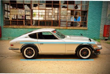

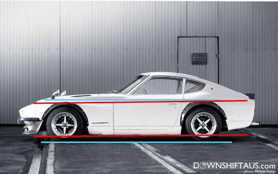

tamo3 Posted October 18, 2013 Author Share Posted October 18, 2013 Not all the flare is the same shape. But after researching internet to find several photos of the side view of ZG flare mount, most people mount same way. Looks like rear flare is mounting higher than front. However, looking at middle of the body line, i can determine what is the right position of mounting fender flare. Thanks, tamo3 Quote Link to comment Share on other sites More sharing options...
JMortensen Posted October 18, 2013 Share Posted October 18, 2013 The right way to do it is to take the spring off and bottom the suspension with the wheel and tire installed to make sure there is clearance. Most people have them mounted too low. Quote Link to comment Share on other sites More sharing options...
Domzs Posted October 18, 2013 Share Posted October 18, 2013 The middle photo looks more right . The rest are too low on the rear . Quote Link to comment Share on other sites More sharing options...

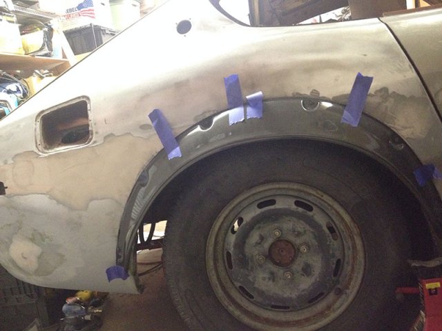

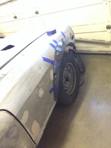

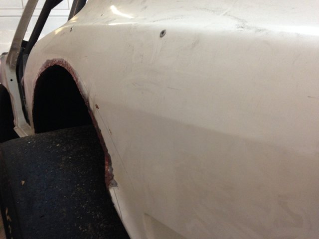

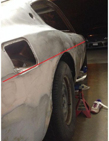

tamo3 Posted October 19, 2013 Author Share Posted October 19, 2013 (edited) I cut rear fender just hitting the body line. Edited October 19, 2013 by tamo3 Quote Link to comment Share on other sites More sharing options...

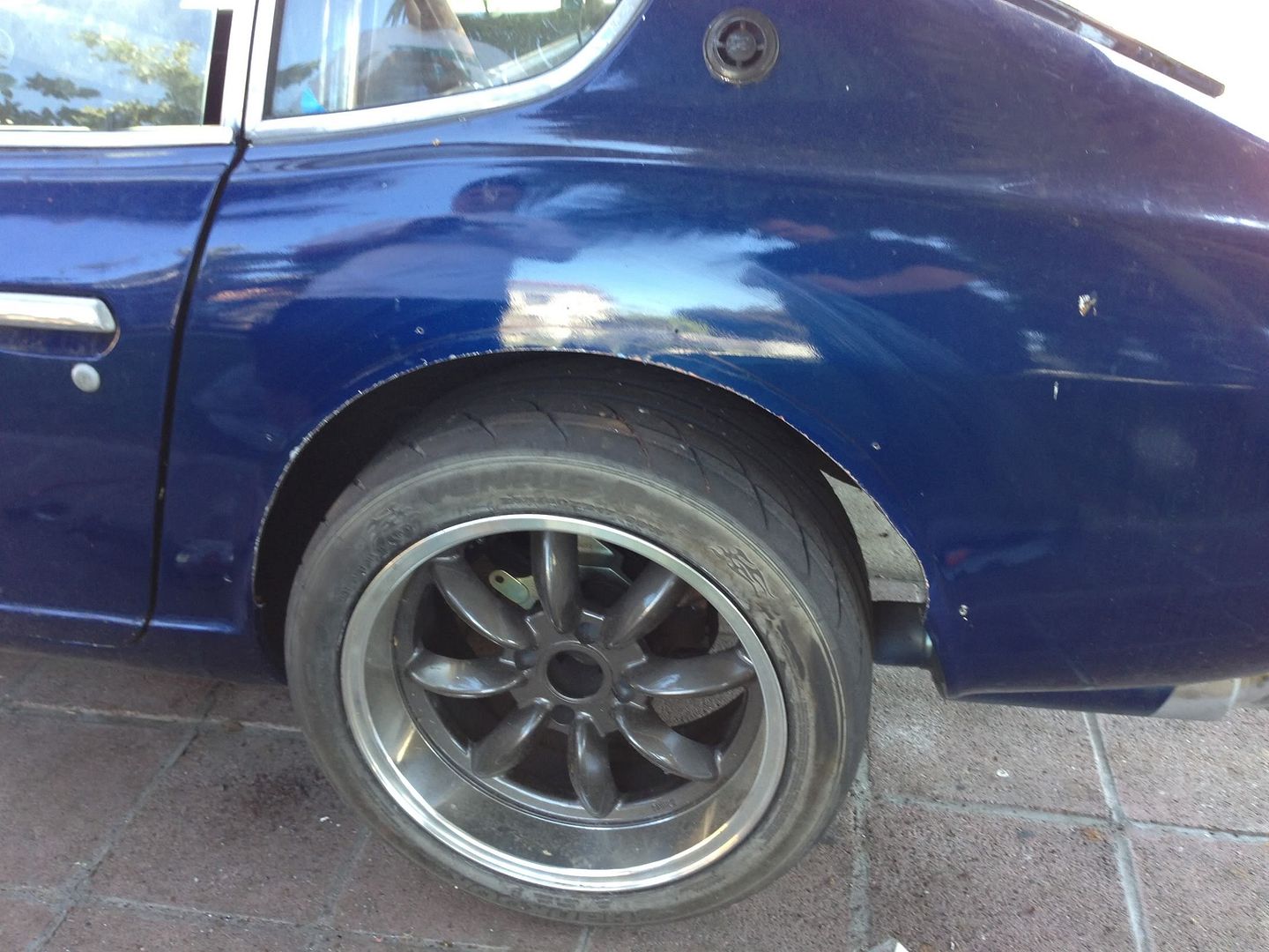

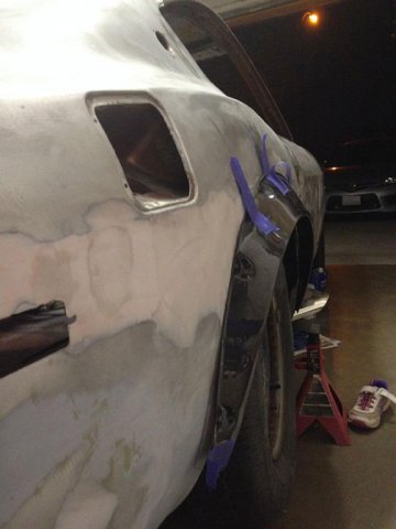

JMortensen Posted October 19, 2013 Share Posted October 19, 2013 Here's how much I had to cut to get clearance for the tire with 23.5" tires and sectioned rear struts and camber plates. Quote Link to comment Share on other sites More sharing options...
tamo3 Posted October 19, 2013 Author Share Posted October 19, 2013 Wow, it looks way so high! I can't tell from your photo where is the body line. Do you have different angle photo? Quote Link to comment Share on other sites More sharing options...
