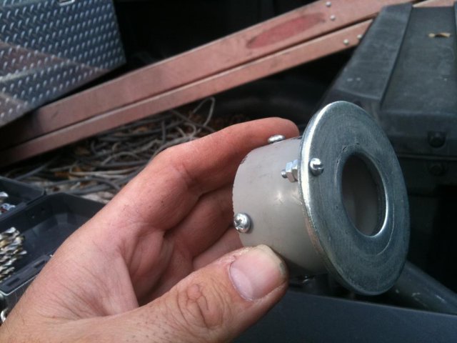

socorob Posted October 18, 2013 Share Posted October 18, 2013 This is what I had to do on an old British car once. There was no adapter kit made for it for the wheel I had. I went to oreillys and opened up all the grant adapter boxes until I found the one that looked like it was the closest to fit my wheel. I only was able to use the half that goes onto the steering wheel with the spring part that usually goes onto the clock spring. I had a piece of plastic conduit that happened to slide over my steering tube very tightly. I actually had to tap it on with a hammer. I got a big washer and drilled it out so the steering rod would fit through it without touching it. I put a screw through it where the conductor spring didn't slide around it so it wouldn't interfere. I connected the wire going into the car on the backside of that with a connector. Sort of a home made clock spring. That was for only 1 button though. You will just need to be creative. Quote Link to comment Share on other sites More sharing options...
Atozone Tonine Posted October 18, 2013 Author Share Posted October 18, 2013 This is what I had to do on an old British car once. There was no adapter kit made for it for the wheel I had. I went to oreillys and opened up all the grant adapter boxes until I found the one that looked like it was the closest to fit my wheel. I only was able to use the half that goes onto the steering wheel with the spring part that usually goes onto the clock spring. I had a piece of plastic conduit that happened to slide over my steering tube very tightly. I actually had to tap it on with a hammer. I got a big washer and drilled it out so the steering rod would fit through it without touching it. I put a screw through it where the conductor spring didn't slide around it so it wouldn't interfere. I connected the wire going into the car on the backside of that with a connector. Sort of a home made clock spring. That was for only 1 button though. You will just need to be creative. Nice work. I wish someone made a generic clock spring with several wires, that would fit a momo. I will probably have to use the coiled cable. Quote Link to comment Share on other sites More sharing options...
