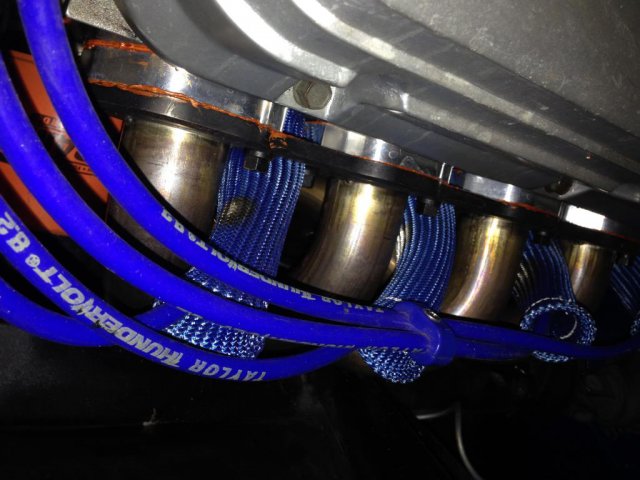

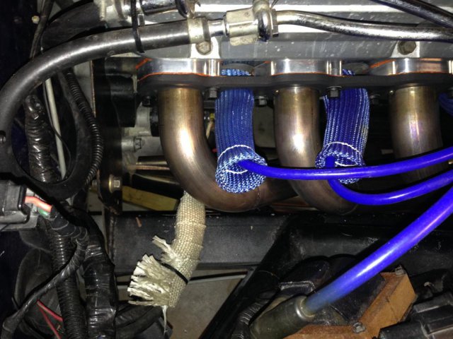

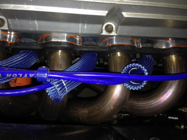

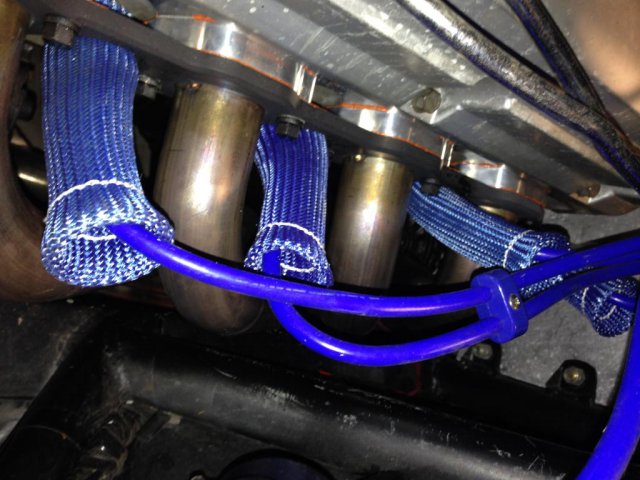

74_5.0L_Z Posted November 18, 2013 Share Posted November 18, 2013 (edited) How about a set of these? http://www.ebay.com/itm/8-Cyl-set-Blue-Heat-Protector-Sleeve-Spark-Plug-Wire-Boots-/271289069398?pt=Race_Car_Parts&hash=item3f2a16af56&vxp=mtr I put them on my car after I made my long tube headers. I only have about 100 miles on the car since installing the long tube headers, but I have not yet burned any wires. My car has a stroked 5.0L Ford engine, but has the same kind of issues. They are not the prettiest things, and you can see where some are scorched. The wires underneath are fine. Edited November 18, 2013 by 74_5.0L_Z Quote Link to comment Share on other sites More sharing options...
