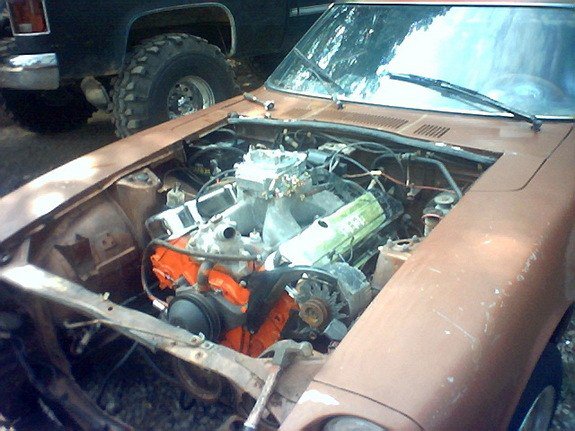

David Morgan Posted April 12, 2014 Share Posted April 12, 2014 I set a 454 down into mine at one point using a copy of the scarab mounts. It had the stock intake with a quadrajet. With the stock air cleaner it all fit under the stock hood. With those mounts the headers that came with the big block also fit with a small dent for the steering shaft. I have no idea what brand they were but the set up was in a 1973 Chevy two wheel drive truck. Decided it would handle like crap so went with an aluminum headed 388 small block that with an Edelbrock Performer RPM intake will not fit under my cowl induction hood with the air cleaner on. I have since got the JTR mounts. Engine fits but know I cant use my full length Hooker Headers. I have not searched lately but last I looked only some small tube shorty headers fit with the JTR mounts which will seriously choke the performance of my engine. I am seriously considering widening the frame rail area centering the engine and then building headers. Quote Link to comment Share on other sites More sharing options...

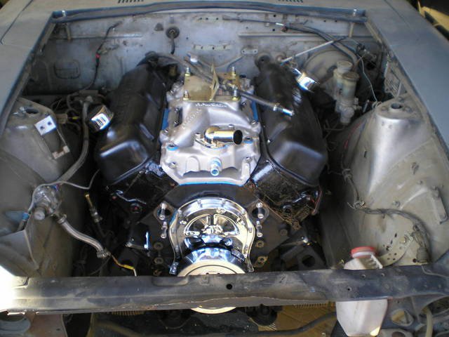

Michael Posted May 26, 2016 Share Posted May 26, 2016 On 11/19/2013 at 4:32 PM, Mike kZ said: PM Michael, he has a big block Z - http://forums.hybridz.org/user/11-michael/ Chiming in - albeit some 2-3 years too late. Has yamahondarider pursued this swap? It seems that with every passing year, the "classic" Chevy V8, whether small-block or big-block, recedes into obsolescence, ceding ground to the LS-series. It would be - how shall I phrase it? - nostalgic, to see another big block swap into an S30. Mine sort-of runs... it receives an occasional engine-start in anger, and jog up and down my driveway. But it's in more or less permanent state of hibernation. My recommendation to yamahondarider - and to others considering this swap - is to pursue it if and only if you're intimately familiar with the big block Chevy. If it's your engine of choice, then use it. If it's one competing option among many, well, today there are more appealing alternatives. In my case, the firewall is set back, and the engine mounts to reinforcements of the frame rails. I use a Hamburger low-profile oil pan, which terminates just above the lowest point of the transmission bellhousing. With an Edelbrock Performer - RPM intake manifold and a 4" air cleaner, conventional hood clearance is not possible. I built a fiberglass hood with an indentation around the perimeter of the air-cleaner, which is crude but effective. Hooker block-hugger headers fit, with some cutting and welding. Diagonals between the front strut towers and the dash-bar (so, penetrating the firewall) make engine removal interesting; it requires removing the starter and oil-filter, and dexterously using a leveling-bar on the engine hoist. The distributor is about 3" ahead of the windshield, and the driveshaft is about 14" long... that's how much engine setback there is. Good luck to all, and here's hoping to see more traditional V8s in our Zs! Quote Link to comment Share on other sites More sharing options...
