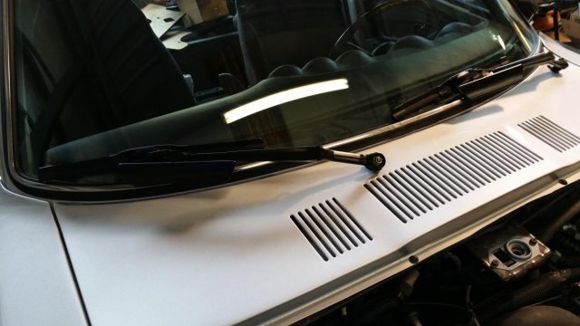

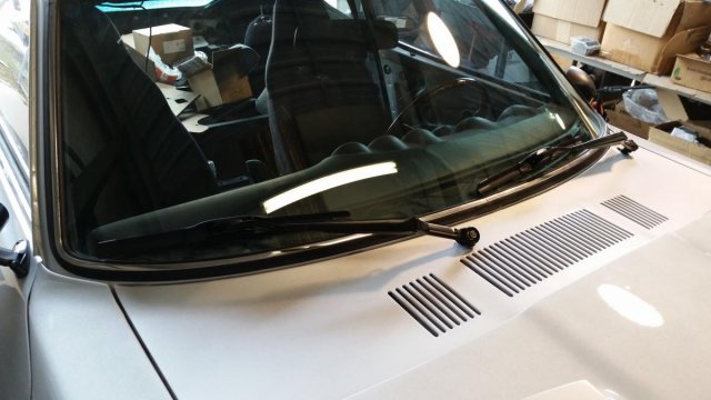

socorob Posted February 11, 2015 Share Posted February 11, 2015 I installed them finally. Here are the pics with and without the spoilers. Quote Link to comment Share on other sites More sharing options...
socorob Posted February 11, 2015 Share Posted February 11, 2015 Hit the send button too doom but here they are. These are 2 driver side wiper arms. They sit a little high at the hinge setting. Gonna keep trying to find something that fits a little better but will probably use these until then dice they're already on. Quote Link to comment Share on other sites More sharing options...

socorob Posted April 21, 2015 Share Posted April 21, 2015 The drivers side works great, but the passenger side has light contact with the window. I'm not sure if its because of the angle it sits or if the arm I got has a bad spring. I haven't got around to swapping them to see if it makes a difference. Quote Link to comment Share on other sites More sharing options...
idiot280 Posted March 27, 2024 Share Posted March 27, 2024 I've just completed this conversion. I was in the market for wiper arms and stumbled on this thread. Seemed like a good idea. The Mazda Miata NA arms do fit, and include the more modern "J hook" attachment system. This is nice since most wiper blades use this attachment. I found a driver and passenger set on Ebay for $45. The driver side has the odd aero foil. Note that with this conversion, you must use different size blades (at least I did). I used the Bosch blades for both sides. Driver side = 16" blade Passenger side = 15" blade Quote Link to comment Share on other sites More sharing options...
