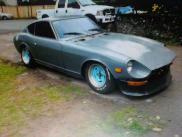

So to start, my fuel pump went out a day after I picked up the car (go figure). Now she's been sitting for almost a week and a half because I cant figure out what is wrong with her. I bought a new fuel pump from work, put it in, just to find out the wires to the pump are bad. So instead of running new wires all the way back I just ran the pump through a switch that I hid for security reasons. Long story short, I hit the switch, fuel pump fires up, I can hear it inside the car, but she wont stay running. The Z will start for a second or two and then die again. Am I not getting enough pressure? Or do the original wires that go to the pump have to be plugged in because of a sensor or something? Please help and thank you in advance.
P.S.  I miss my Fairlady... :(
