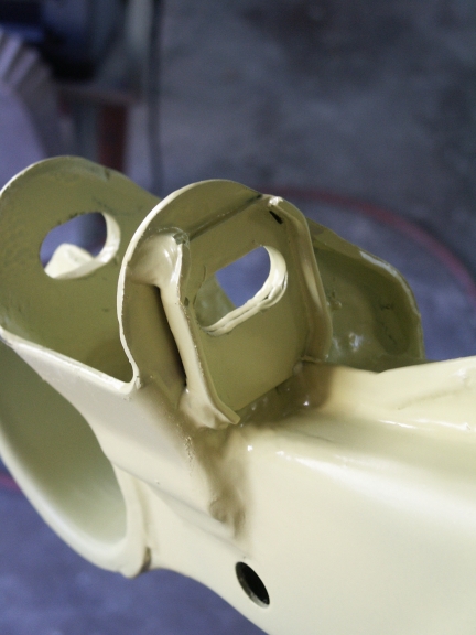

HowlerMonkey Posted December 26, 2013 Share Posted December 26, 2013 I would slot it for adjustability of toe. The M30 has a near identical setup and it has adjustability so I would think some slotting wouldn't hurt. Quote Link to comment Share on other sites More sharing options...
BluDestiny Posted December 26, 2013 Share Posted December 26, 2013 (edited) Howler, do the m30 mounting points have a ridge to use with eccentric bolts? Or just a slot? That clunking if probably you diff. When is the last time you changed the diff oil? If you haven't you can easily drain it, pop the cover off and check the gears for any wear, but I'm guessing its just excess lash from being 30+ yrs old. The car hasn't been in any fender bender right? Clean title, po never said it was hit etc? Edited December 26, 2013 by BluDestiny Quote Link to comment Share on other sites More sharing options...

HowlerMonkey Posted December 26, 2013 Share Posted December 26, 2013 Here is a thread where someone replaced the rubber bushings with harder ones and it shows some pretty harsh labor. http://forums.f31club.com/phpBB3/viewtopic.php?f=6&t=2916&start=165 http://www.garymolitor.com/300zx/cambermod/Camber_mod-20.jpg Here is a picture of the "shoulders" that act to keep the eccentric washer centered but in this picture, they have simply cut them off of inner z31 pickup point and rewelded them on the outer pickup points 90 degrees so they can adjust camber. The shoulders themselves aren't really responsible for keeping it located when tightened down but rather for adjustment but there is something to be said for using them for peace of mind. Quote Link to comment Share on other sites More sharing options...
Connor280ZX Posted December 26, 2013 Author Share Posted December 26, 2013 On 12/26/2013 at 6:40 PM, HowlerMonkey said: Here is a thread where someone replaced the rubber bushings with harder ones and it shows some pretty harsh labor. http://forums.f31club.com/phpBB3/viewtopic.php?f=6&t=2916&start=165 http://www.garymolitor.com/300zx/cambermod/Camber_mod-20.jpg Here is a picture of the "shoulders" that act to keep the eccentric washer centered but in this picture, they have simply cut them off of inner z31 pickup point and rewelded them on the outer pickup points 90 degrees so they can adjust camber. That's some really good info, but this is my daily driver and I'm not quite comfortable getting fab work done on the suspension to improve performance. But I will remember this once I get a track Z car. Quote Link to comment Share on other sites More sharing options...
