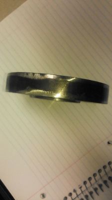

hwvigo Posted January 16, 2014 Share Posted January 16, 2014 Hello I was wondering if anyone knows were i can get a replacment adaptor plate for my drive shaft i have done much digging around im the fourms and on google with no luck any help would be nice thank you . Here are a few pics of the item i am refering to . Quote Link to comment Share on other sites More sharing options...
skirkland1980 Posted January 16, 2014 Share Posted January 16, 2014 I'm interested to know what this part does specifically...On another note it looks somewhat similar to a part I had custom made. Would cost around $300. Quote Link to comment Share on other sites More sharing options...
hwvigo Posted January 16, 2014 Author Share Posted January 16, 2014 On 1/16/2014 at 8:43 PM, skirkland1980 said: I'm interested to know what this part does specifically...On another note it looks somewhat similar to a part I had custom made. Would cost aroundI 300 It bolts to the diff flange and then the chevy driveshaft with stock chevy ujoint bolts in to the threaded holes here is a pic of ot mounted to the diff flange and you can see the mark were it mated up in this one Quote Link to comment Share on other sites More sharing options...
EastTnZ Posted January 22, 2014 Share Posted January 22, 2014 -R200 Neapco Adapter 2-2-899-1 with a 1310 Size U-Joint (M8-1.25x35mm) Look that neapco part number up and it should give you an adapter that goes from r200 to 1310 spicer u-joint Hope this helps. Used it on my 5.3 tr6060 build Quote Link to comment Share on other sites More sharing options...
hwvigo Posted January 22, 2014 Author Share Posted January 22, 2014 On 1/22/2014 at 5:30 AM, EastTnZ said: -R200 Neapco Adapter 2-2-899-1 with a 1310 Size U-Joint (M8-1.25x35mm) Look that neapco part number up and it should give you an adapter that goes from r200 to 1310 spicer u-joint Hope this helps. Used it on my 5.3 tr6060 build Thank you i have been looking at this as a back up . I am worried my shaft would be to short if I went this route . Quote Link to comment Share on other sites More sharing options...
