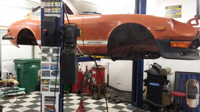

Mikey303LSZ Posted February 6, 2014 Share Posted February 6, 2014 Guys, The build is getting closer. Bad Dog sub-frame connectors are burned in, just waiting for warmer weather so I can seal everything up w/ POR15 on the inside/outside of the floor pans and install the suspension/interior. What's a good location for the speedo box? I'm considering mounting the box under the driver's seat. Thought I would jump ahead with the speedo box wiring/mounting plans while I wait for warm weather. Is the Cable X unit quiet? I've never used one before. Quote Link to comment Share on other sites More sharing options...
Mikey303LSZ Posted February 6, 2014 Author Share Posted February 6, 2014 Just noticed the picture I posted has a few photos of Datsuns stuck to the side of the lift. You may recognize some of the pictures - inspiration when "The Man" has got me down... Quote Link to comment Share on other sites More sharing options...
