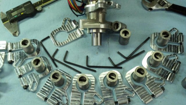

123ignitionusa Posted February 6, 2014 Share Posted February 6, 2014 (edited) A while back, around Dec 25 2013 a number of forum members were asking about the L6 and using a 123ignition. It has been accomplished and is available here in the US. Costs were kept lower than originally estimated by having the parts made here in the US. See here at 123ignitionusa http://www.123ignitionusa.com/datsun-conversion.html Edited February 6, 2014 by 123ignitionusa Quote Link to comment Share on other sites More sharing options...
