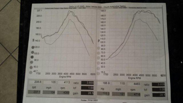

laxz6 Posted February 7, 2014 Share Posted February 7, 2014 Hey guys so I have a 280z l28et with ms2 v3.0 Running the turbo distributor. I have a 24x12x2.3 intercooler and running 440cc supra injectors with a tial bov and a boost controller set at 12psi. I have a 3in downpipe all the way out with a bigger compressor wheel on the stock turbo. So I just got my car dynoed 2 days ago and I'm unhappy with the result. I made 195hp and 237ft tq. I'm wondering if there's something wrong with the tune because I've seen Similar setup hitting 300hp and around 358tq. Does anyone have a map that has been proven to hit 300hp. I've spent too much time on Megasquirt and the wiring to just not see a lot of hp gain. Any help is appreciated, thanks. Quote Link to comment Share on other sites More sharing options...

Xnke Posted February 7, 2014 Share Posted February 7, 2014 Looking at the shape of the graph, you're not revving high enough and I would bet you're runnning a very conservitive timing map. The undulations around peak torque show a either a spark issue or a lean-rich-lean-rich issue...you're close, but it's all in the tuning. Quote Link to comment Share on other sites More sharing options...

Gollum Posted February 17, 2014 Share Posted February 17, 2014 http://www.amazon.com/Engine-Management-Advanced-Greg-Banish/dp/1932494421/ref=sr_1_1?s=books&ie=UTF8&qid=1392596002&sr=1-1&keywords=advanced+engine+management+tuning Worth every penny. Covers not just how to tune your tables, but explains a rough overview of the science behind what's going on and WHY you tune WHAT, HOW, and in WHAT ORDER. These are all VERY key in tuning anything to it's limits to get the most power possible and also maintain good driveability and economy. Oh, and don't beat yourself up too much. Just under 200 to the wheels on a lightly modded stock turbo running 12psi on a stock head isn't THAT far off. The people making 300hp are usually running more like 20+psi on a lightly modded head, or 25+ on a stock head, and almost guaranteed on a MUCH larger compressor than I bet you're running. Quote Link to comment Share on other sites More sharing options...
