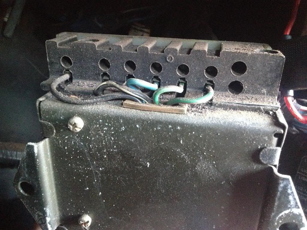

Does the tachometer move when you spin the engine?  It may be that your guy just left the blue wire off of the ballast resistor.  The blue wire controls the ECU, the tach and the ignition module.  It's circuit runs to the negative post of the coil.
Edit - actually the tachometer may not move if the ignition module is bad.  No spark, no pulse.  But, a minute with a multimeter under the dash at the ignition module or at Pin 1 at the ECU connector will tell if it's connected correctly.  No blue wire, no run.  Easy to overlook after an engine swap, especially if the ballast resistor was messed with.

Progress.  Don't forget to check the blue wire.  It needs to be connected to the coil negative at one end and the ignition module at the other.  The wiring diagram in the Engine Electrical chapter would help.  Other wires that need to be connected to the module are the red and green wires from the distributor.  That's where they go after the terminal on the fender well.

You should be measuring resistance at red and green.  Page EE-31.  The weird thing about transistors is that they can show voltage, but won't have significant current flow.  I don't know if 12 volts at red is normal or not.  But the resistance through the pickup coil circuit is important.
The flow path would be red wire from pickup in distributor to terminal on fender well through ignition module in cabin then back to terminal on fender well and back to distributor's green wire (some reman's use two blue wires from the distributor, green and red on the inside though).  That's the trigger for the module.  Then The blue wire connected to the coil negative and the module makes and breaks the circuit based on the signal in those two wires.

Actually, back to #10 and #11, you should never have 12 volts on the red, if it's disconnected from the module.  Are you measuring with the wires disconnected as shown in the FSM?  If they're connected to the module when you measure you'll get funky results because you'll also be measuring components inside the module.
