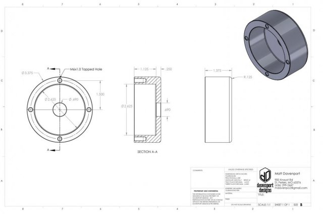

str8pipez Posted May 21, 2014 Share Posted May 21, 2014 Finally getting around to having my trigger wheel mount made. Keeping the factory air as well. This will attached via the crank bolt and the trigger wheel will bolt on through the 4 threaded holes. Still need to switch to electric fans, that's next. Also the outside diameter of 4" will be changed to 3.625". Quote Link to comment Share on other sites More sharing options...

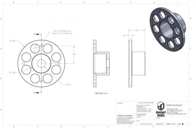

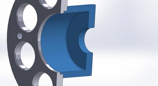

str8pipez Posted May 21, 2014 Author Share Posted May 21, 2014 Revised. KISS. Aluminum one piece now. Quote Link to comment Share on other sites More sharing options...
seattlejester Posted May 21, 2014 Share Posted May 21, 2014 That looks really nice and simple. May I ask how you plan to keep the mount from rotating? Quote Link to comment Share on other sites More sharing options...
