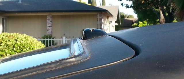

I started by measuring out to place the light in the center, and marking mounting hole and wire pass through locations.
I then drilled the three holes, two for the screws and one for the wires.

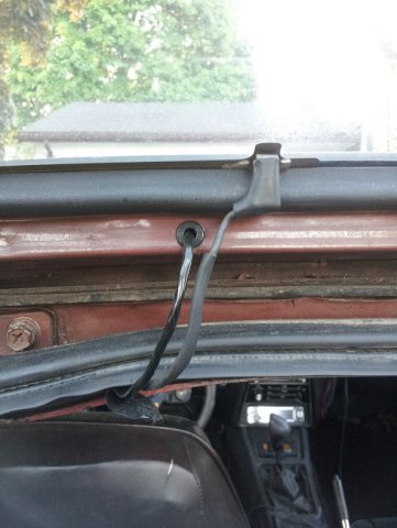

I then moved to the inside where I drilled a hole to pass the wire into the interior, but there was a problem, there was a re-enforcement plate between the two holes. So since I was at the point of no return, I decided to forge on and drill a hole through this plate from the outside. Then through some creative use of wire, string and pick tools passed a fish wire through from the outside of the hatch to the inside. I had to remove the connector that is on the 3rd brake light in order to pass the wires through. I also had to add some extra tape around the wire where it passes through the inside re-enforcement plate to act like a grommet. I tried to get it so that the wire was actually secure and not able to move around to reduce the chance of chafing. The other holes can use a grommet.

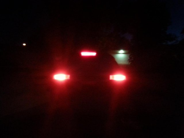

After that it's just a matter of running a wire to the brake switch. Something to note here is that on my '73 with the 3rd brake light attached to the brake switch the 3rd brake light will also flash with the hazzards (4 ways) on, which is something that I wanted so this was a bonus for me. If you want it to work more conventionally, where the hazzards will not turn on the 3rd brake lights you will have to add a diode to remove the feedback from the hazard switch.

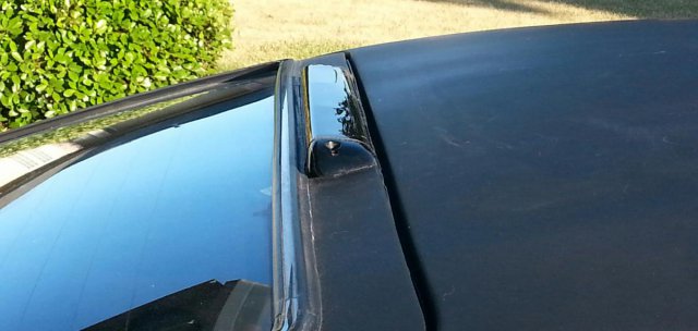

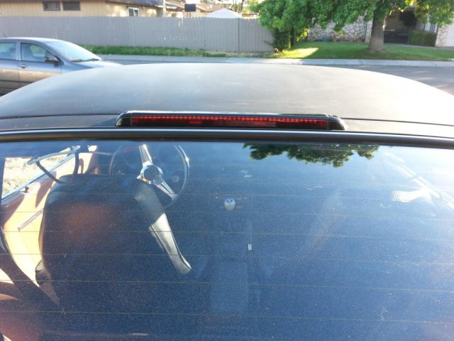

Fits that space like it was meant to be:
Wire as it passes to the interior:

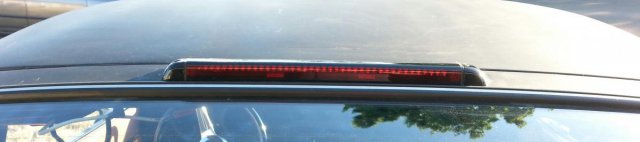

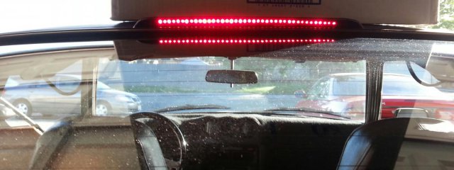

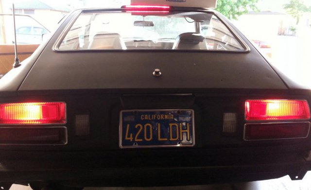

Lit up:

I had thought about getting an inside 3rd brake light, but since I couldn't find one that I liked, that wouldn't block even a little bit of the view through my mirror and I had this one, I decided to forge ahead with it. I even looked at making a bracket and shield to mount this one inside but couldn't come up with anything I liked. Once I mounted this on the outside I thought it was a great decision.

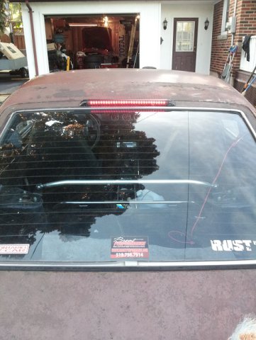

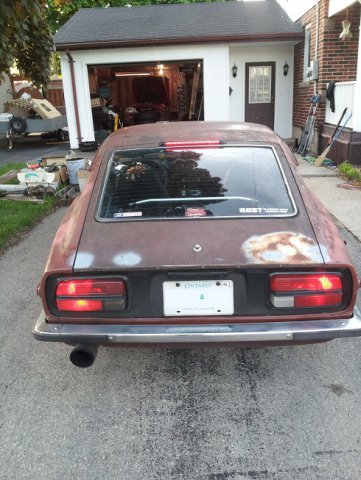

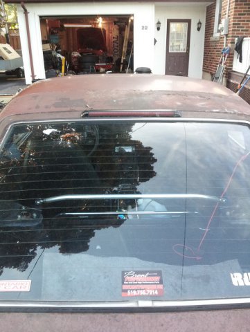

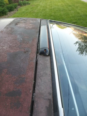

First off,
I would like to thank socorob for putting the idea in my head. Here is my 3rd brake light addition. It's off of a Chevy Tahoe ( $10 @ pick-n-pull ).
1 drilled hole
2 self tapping screws
small bead of permaflex all the way around before attaching
ran wires inside top panel (where dome light is) down around passenger side and spliced into brake light harness.
I think it came out pretty damn good if I do say so myself :-)post-44346-0-98346200-1401246220_thumb.jpgpost-44346-0-80310600-1401246245_thumb.jpgpost-44346-0-62115100-1401246271_thumb.jpgpost-44346-0-45799300-1401246295_thumb.jpgpost-44346-0-98346200-1401246220_thumb.jpgpost-44346-0-82933400-1401246375_thumb.jpgpost-44346-0-47244600-1401246325_thumb.jpg
