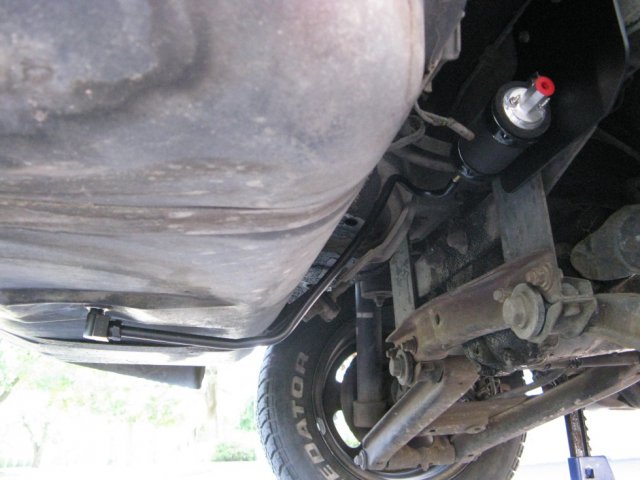

Six_Shooter Posted June 6, 2014 Share Posted June 6, 2014 Your problem doesn't sound fuel tank related, or at least not directly.I have a '73 that I have turbo'd and injected using the stock fuel tank. I am not using the stock feed though, well at least not as a feed, I have my return plumbed to the original feed line. I instead removed the drain plug and threaded it for 3/8" NPT and installed a 90* fitting there to feed my Walbro fuel pump. The only time I have an "issue" is when the tank is REALLY low (as in needle touching the empty mark) and only when driving spirited, I notice that my engine runs a tad leaner than when I have more fuel, but still has not missed a beat. I am not using a surge tank either. It's not an ideal set-up but it seems to work flawlessly, contrary to what people will tell you. For your problem you need to find out why the engine ceases to run, is it fuel related? Is it spark related? Is there an obstruction in the exhaust? Once you identify what goes away when the car stops running then you can look at that system to find the problem. Quote Link to comment Share on other sites More sharing options...
