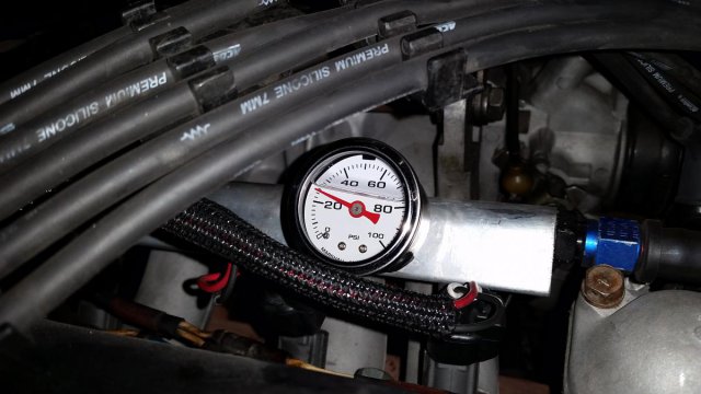

Serban Posted June 23, 2014 Author Share Posted June 23, 2014 (edited) I put a new gauge on and here's what I got at idle. Revving it I'll get around 30-33 or so but if I hold the throttle, it drops back down. Edited June 24, 2014 by Serban Quote Link to comment Share on other sites More sharing options...

NewZed Posted June 24, 2014 Share Posted June 24, 2014 Your 25 psi at idle implies 22 inches of intake vacuum, which is very high for the 280Z, I believe. And you should have seen 36-37 psi when blipping the throttle. Disconnect the starter solenoid wire and turn the key to Start. The fuel pump will run but the engine won't turn over. Or disconnect the vacuum hose to the FPR while the engine is running. You'll get full pressure on the gauge, it should be 36-37 psi for a stock regulator. Why not use the FSM or the Electronic Fuel Injection Guide to know that the TPS is right? The early one was written for your car. Test at the ECU connector. http://www.xenons130.com/reference.html Those Ford injectors are one lb/hr higher rate than stock. You should be running rich. Are they low or high impedance? If they're high, did you bypass the stock resistors in the power circuit? Maybe the injectors aren't opening correctly. Just some possibilities. Quote Link to comment Share on other sites More sharing options...

NewZed Posted June 24, 2014 Share Posted June 24, 2014 (edited) Where is this Aeromotive filter? Before the pump or after? The stock Nissan pump is huge so that it can pass enough fuel to support the engine while still filtering. You might have the wrong filter. The high impedance injectors won't hurt anything but if you left the resistors in place you're running less current through the system, including the ECU, than designed. Your pressure and intake vacuum numbers don't add up but 38 psi would be sufficient pressure to make things work right. 19 inches of vacuum is 9.3 psi. 38 - 9.3 = 28.7. Your picture of the gauge at idle shows 25. Probably just two bad gauges, combined, or the camera caught a bounce. Who knows. If the lean-out happens even when you work up to 4000 at part-throttle then the TPS probably isn't a factor. Edited June 24, 2014 by NewZed Quote Link to comment Share on other sites More sharing options...
Serban Posted June 24, 2014 Author Share Posted June 24, 2014 (edited) Filter is located near the factory location, I can't remember what micron size the element is, I'll take it apart and check. I used the same filter on a couple previous cars I've owned, and never had any issues with it. I'm not getting any bounce on the new gauge, it's liquid filled and very steady. Old one was a dry gauge and it only lasted about 4 months before it failed. Here's a few pictures I took this morning at idle, and with the vacuum hose off the regulator, and my intake manifold vacuum. Fuel pressure at idle this morning was slightly higher, looks to be about 28. Manifold vacuum was also very steady, it held at 19 until I blipped the throttle, then came back down to 19. ::Ninja edit:: The wideband gauge is a dual purpose gauge, wideband, and boost/vacuum. I changed the settings to show vacuum in the center. Another thing I left out, I'm using an Odyssey PC680 battery, and if you know that battery, it's small compared to a full size car battery. Could the small battery be causing my problem? I'll try a full size battery and see if anything changes. Edited June 24, 2014 by Serban Quote Link to comment Share on other sites More sharing options...
