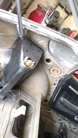

Akira Posted August 2, 2014 Share Posted August 2, 2014 I can't tell from your pictures, but are your knock sensors on top? I didn't like the look of my knock sensor wiring being pinched by the ribs of the intake. Quote Link to comment Share on other sites More sharing options...
Meatwad Posted August 2, 2014 Author Share Posted August 2, 2014 I can't tell from your pictures, but are your knock sensors on top? I didn't like the look of my knock sensor wiring being pinched by the ribs of the intake.Yep they are on top Quote Link to comment Share on other sites More sharing options...

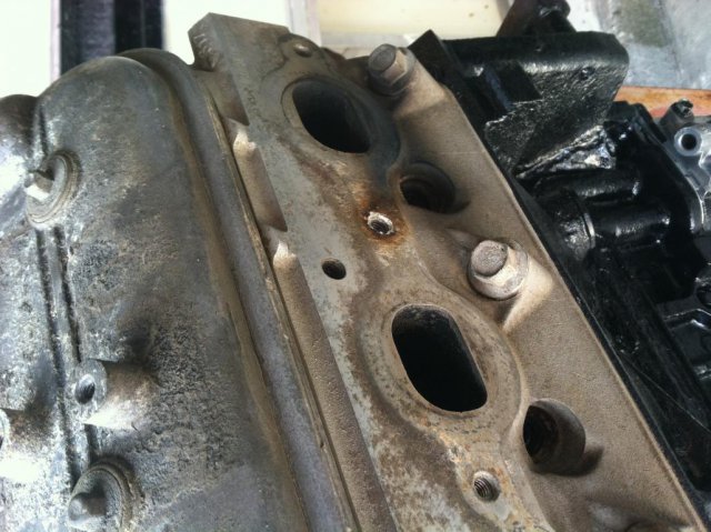

Meatwad Posted August 3, 2014 Author Share Posted August 3, 2014 Small little update, but I'm happy! I only had one broken exhaust manifold bolt stuck in the head. Since the temperature was down in the 80's today and since I was bored, I figured i would attempt to get it out. After some heat with a torch it came out! Hooray for no broken exhaust manifold bolts! Quote Link to comment Share on other sites More sharing options...

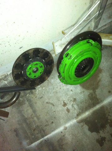

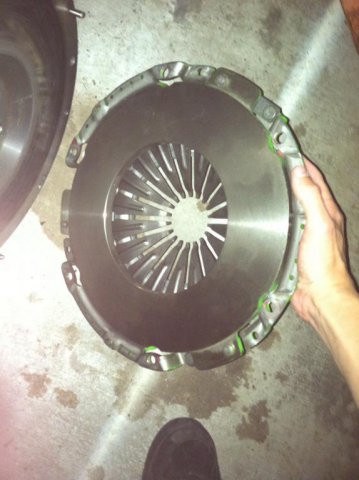

Meatwad Posted October 21, 2014 Author Share Posted October 21, 2014 Had to pick this up while the chance was there. Picked up a monster stage 2 clutch for $300. Barely used, 200 miles on it, but the pressure plate doesn't even look used. Quote Link to comment Share on other sites More sharing options...

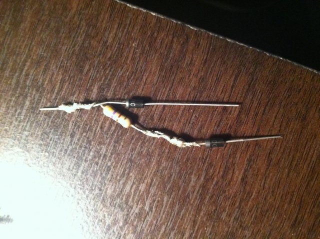

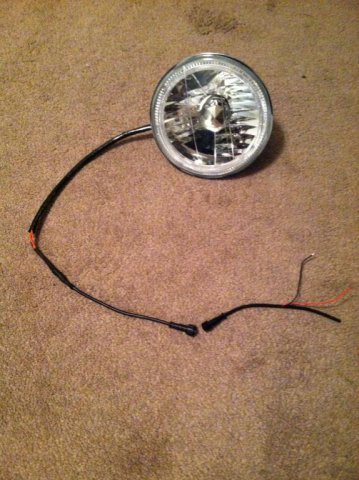

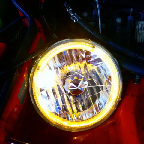

Meatwad Posted January 22, 2015 Author Share Posted January 22, 2015 While I'm still looking for a t56 (I have one guy looking to 4l80e swap his car and sell me his t56, but I'm not holding my breathe). My custom grind cam with the proper valvespring and hydraulic roller lifters finally shipped today. On the side, i wanted to actually do something to the car instead of working on the engine. I have decided to attempt to delete the turn signals in the grille. I found these 7" housings on eBay with Amber halos. They use h4 bulbs. The halo will only light up when the turn signal blinks, but when the headlights are on, they will act as running on a dimmer setting. I have picked up some diodes and resistors to make the led halos dual intensity so I can run them as running likes an turn signals. Quote Link to comment Share on other sites More sharing options...
Meatwad Posted January 25, 2015 Author Share Posted January 25, 2015 Finally got my load resistors Thursday and my waterproof plugs came in this evening. I did as much as I could do since it's dark. I soldered and heat shrinks one side of the plugs to the halos Also made the set up for the dual intensity lights. The running lights wire will be soldered to the side with the resistor and diode, while the turn signal wire will be soldered to the side with just the diode. Quote Link to comment Share on other sites More sharing options...
