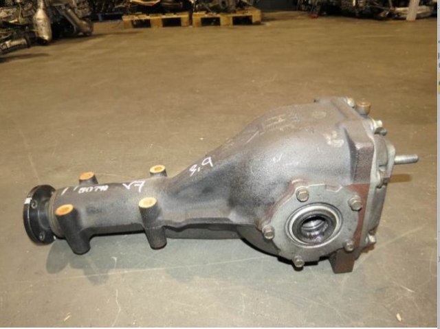

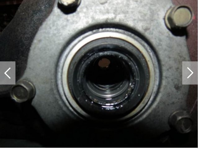

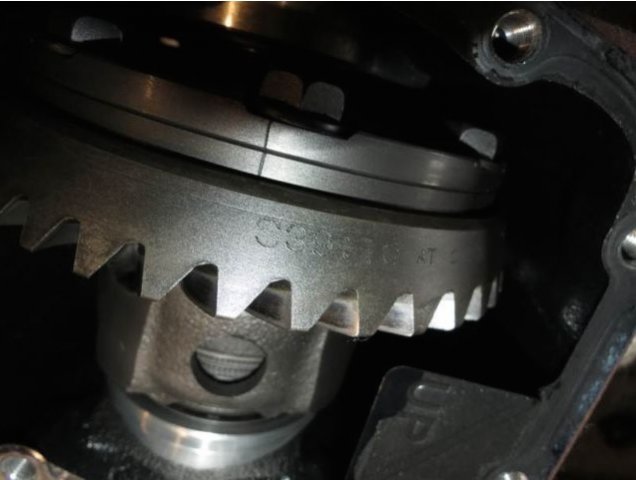

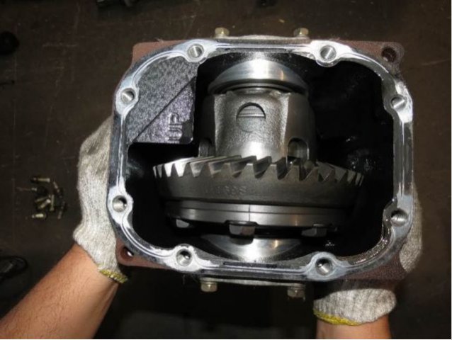

VitaminZ Posted July 8, 2014 Share Posted July 8, 2014 (edited) Hey guys , looking to swap my diff to the Subaru R180 3.9 , I currently have one available to purchase but Im not sure if its the right year and model . I know the diff should off a US 04-05 STI , but the diff I am getting is off a 02 JDM STI 3.9 , I'm just trying to ensure this diff is not a Viscous LSD and IS a Clutch type or Torsen . Or if there are specific number stamps on the ring gear I should be looking for ? I cant really tell the difference hence why I am seeking your knowledge on this . There are a few pictures attached , not sure if this helps . Any help is greatly appreciated , thanks . Edited July 8, 2014 by OldschoolZ Quote Link to comment Share on other sites More sharing options...
johnc Posted July 8, 2014 Share Posted July 8, 2014 That's a viscous diff. Quote Link to comment Share on other sites More sharing options...

VitaminZ Posted July 9, 2014 Author Share Posted July 9, 2014 how about this one is this a clutch type , also can someone give me some insight as to how I may easily spot the differences , thanks. Quote Link to comment Share on other sites More sharing options...

VitaminZ Posted July 10, 2014 Author Share Posted July 10, 2014 (edited) These may help: http://thefactoryfiveforum.com/showthread.php?13240-A-spotters-guide-to-Subaru-differentials http://legacycentral.org/library/literature/differential.htm#Which Subarus do I look at to find an LSD http://forums.nasioc.com/forums/showthread.php?t=1969700 thanks a lot for this really helped , seems like the first diff I posted here which is kinda hard to tell from the photos is a clutch type lsd , looking through the hole shows the clutch packs , going through the first link you posted even the cover compared to the CLSD cover in the link looks the same . The viscous type looks much different as well as the cover . But John did say it was a viscous , not sure where im going wrong here . Edited July 10, 2014 by VitaminZ Quote Link to comment Share on other sites More sharing options...
VitaminZ Posted July 10, 2014 Author Share Posted July 10, 2014 well I have confirmed it is a clutch type lsd in the first set of photos , not sure why John thought it was a viscous Quote Link to comment Share on other sites More sharing options...

johnc Posted July 10, 2014 Share Posted July 10, 2014 My mistake. The 2002 STi used a viscous rear and I only saw one break line in the pic above through the side opening. Quote Link to comment Share on other sites More sharing options...
