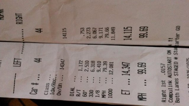

Well just got back from the drag strip and did two passes. The third pass my drive shaft u joint grenaded :(
I was really shooting for 13s and I am close. My second pass was 14.115 at 99.69.
First pass is on the left. I got a horrible R/T because I didn't know how the lights worked.

Also, could someone give me an idea on my times on the slip? I've never really understood what to compare it to. Basically, what did I do bad in, and where was I doing ok?

Well, you're having the same problem I am, getting off the line.
The 14.1 pass has a much better 60', which is an indication of a better launch than the other pass.
If you can get the 60' down, that's where you'll find your 13 second pass. If you compare the two passes you'll see that the same .2 of a second difference from the 60' is pretty much carried through the entire pass. Because of this it seems that your car is working well, once you're past the 60', so get the launch down and you'll be there. I say that it's working well, because there was no additional drop in E.T. after the 60' from one run to the next. Usually if there's anything to be gained throughout the entire run, you'll see approximately 2 tenths dropped off the 1/4 mile E.T. for every 1 tenth dropped off the 60' time (general rule of thumb). This is not shown in your case, so, just work on those launches.
Reaction Time (RT) has zero effect on actual E.T. This is only an indication of how quickly you reacted to the light going green. I usually wait until the last yellow is just turning off and let out the clutch, usually with in the .500 to .600 range when I do this (.500 is a perfect light on a sportsman tree). Reaction time only really counts when you're trying to actually race and beat someone. Some races are won on reaction time alone, when two cars that are so evenly matched make the exact same pass, teh one with a quicker reaction time will win. ;)
What type of 60ft should I be expecting on street tires?
I think I was just launching at too low of an RPM (around 3k). The 3rd pass where my driveshaft exploded is when I tried launching around 4k.
Thanks for the info on the RT. I didn't know that wasn't factored in.
I need to figure out my shifts points too. I haven't dyno'd the car and I don't even know where my powerband falls off. I'm reviewing my AFR logs and I was running too rich. Around 10.5 at full boost. So that's definately sappin' some power. I need to dial back my afpr a few turns.

The 60' time is about what I was able to achieve, but I never did get my launch tuning sorted out, I got it close, but not as dialed in as I would have liked. I would launch around 2500 RPM, for best results in my case, I was running a 3.90 diff and ZX 5-speed. I was shifting at 6000 RPM, and would sometimes short shift 1st to 2nd at about 5600 RPM.

Tough issue is boost and lag. I was able to get under 2.0 doing this. 1.94 being the best. But that would put you in the 13.6 to 13.8.

E.T. and MPH are not tied together. Most of the time my quickest passes are some of my slowest, meaning the E.T is low, but the MPH is also low, compared to some of my slower passes (E.T wise). Usually this is an indication of one run dead hooking and applying all of the power, while another is slipping at least a little bit, or slipping more than another run.
