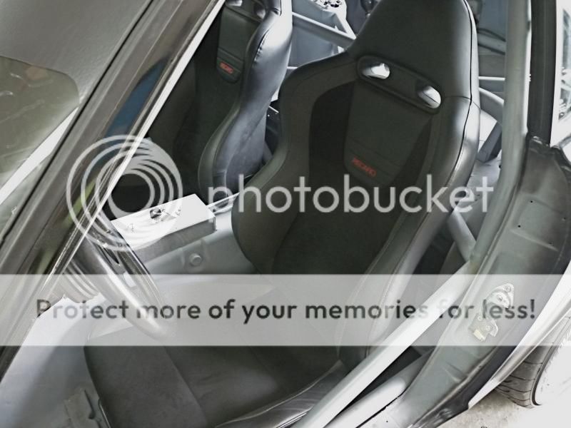

These are Recaro's out of an '05 Evo. They're "9"'s, I dunno about "8"'s.
They fit just about perfectly, and we mounted them smack on the floor for lots of noggin' clearance.

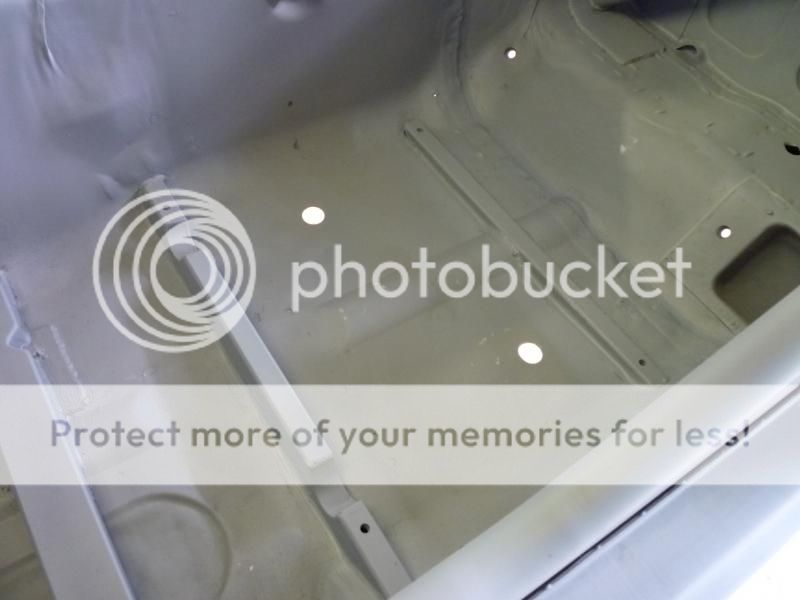

The mounts have 10mm nuts incorporated into them. They align with the seat mounting points. The front mount recesses are needed to provide room for the fore/aft release handle.
They are NOT easy to bolt in!
