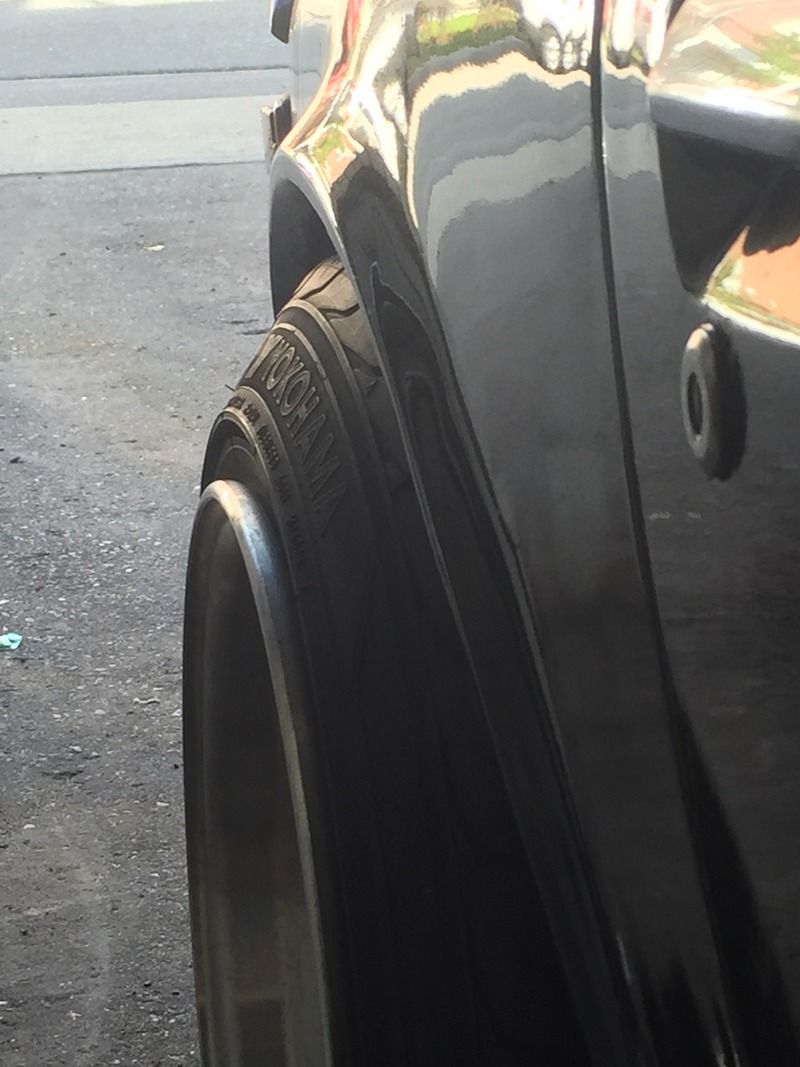

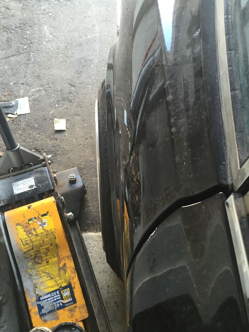

I don't know if I'm too late but I am currently running 15x10 -44 all around with the Wide ZG flares sold by silver mine motorsports (Quality was much less than I expected, hoping to get a replacement flare once I get the brakes fixed.. anyways)  I put on 225/50r15s and the stretch isn't honestly too bad.  Much less than I was expecting.  There is less than a fingers gap between all flares yet it can go lock to lock.  Only has the cheap emusa coil over conversion done.  Needs some control arms to adjust camber a little and an alignment but so far they fit great
