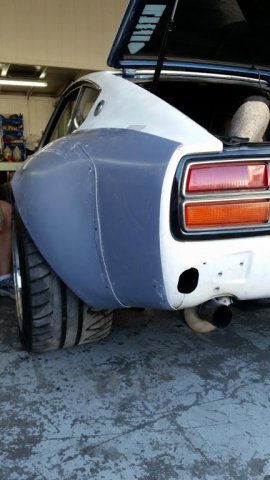

AZGhost623 Posted March 27, 2015 Author Share Posted March 27, 2015 Here they be! Installing on Saturday quarter panels, front fenders and gnose. Quote Link to comment Share on other sites More sharing options...
RebekahsZ Posted March 27, 2015 Share Posted March 27, 2015 That is absolutely amazing that you have the skills to create panels like that. I bet you could line up some guys to buy those from you. Looking forward to seeing the fronts. Make sure you plan the opening for the front while turning the wheel back and forth to allow an adequate opening for caster changes. Make them have more clearance in the front than you really think you need. Great stuff! Quote Link to comment Share on other sites More sharing options...

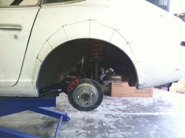

AZGhost623 Posted March 30, 2015 Author Share Posted March 30, 2015 (edited) Saturday work: Lots of prep work on the rear quarter fenders. Cut the top fender away showing the inner fender. Sawzall'd the inner fender into 1" widths and cleaned up the metal for welding. Interior removed/opened up to ensure nothing caught on fire and could be watched with a water bottle just in case to put out any flare ups. The driver side has an antenna line that runs over the hump. I deleted it out. The passenger side has a cable harness. Disconnected it under the passenger seat, and pulled it out through the body to the rear of the car. We tied a string onto is, so it could be easily pulled/fished back into the car after everything was welded up. The interior of my car is trashed, but it gives some good access to the inner fender to do some body sealer and/or some insulation. John at Ztrix.com did the welding, looking good for someone who claims to be an amateur welder! John rounded down the metal pieces because it was pretty sharp after we wiggled the tabs and they broke off. This way anyone working under the fender might not accidentally cut themselves. Traced the outline of the new quarter panel with a marker, and then used some wicked SEM epoxy on it to seal it to the car (30$ per 7oz bottle). It has a 90 minute cure time, so it gives time to work with the part for fitment. Used dry wall screws to screw into the panel and into the car to hold it into place while it cured. When it cures, its hard as a rock... serious industrial grade stuff! Fitted the tires, and trimmed as necessary. Took it for a short drive around the block, making it squat to see if anything rubbed, and trimmed as necessary again. That was pretty much the day which seems like simple tasks, but the prep work takes forever! I drove home on surface streets, hitting potholes and other things on purpose just to make sure if it was going to rub somewhere it could be trimmed. That was Saturdays work... 7 am until about 5-ish. Had to be home before dark, because I have no headlights! ============================ Sunday Work: Sunday was getting the front fenders rough fitted, and the imsa nose fitted. Lots of trimming work. This was the first time John ever cast this mold, so we were learning a lot of of these as to what needed to get done. Lots more measuring drilling holes, and trimming. The hardest part was lining up the fender headlight buckets to the gnose buckets and getting the headlight centered. That took A LOT of time figuring out how that was going to work. The front tires didnt work. With the adpater on it, it didnt fit and hit the corners. We felt it best to not trim the fenders as it would ruin the look. So I went back to my 16x8 tires as a temp solution. Ill get the front hubs converted to 5 lug hubs so that will remove the 2" adapter I have up under there and will suck the wheel in. It will then be right where it needs to be. Ill get some better pictures where the body doesnt blend into the floor so much later this week. Its a 20ft beauty queen right now. Lots of work still needs to be done. Im going to start getting pricing from a body/paint shop to see what its going run as well as getting a wrap done inlieu of paint. If anyone has any good suggestions for paint/body shop in greater phoenix area, please let me know! Big thanks to John Washington at Ztrix.com for all the help and assistance. This entire kit will be for sale up on his website once he gets it updated. Im sure it will include a lot pictures from this build as well as more that I didnt include up here. Edited March 30, 2015 by AZGhost623 Quote Link to comment Share on other sites More sharing options...
