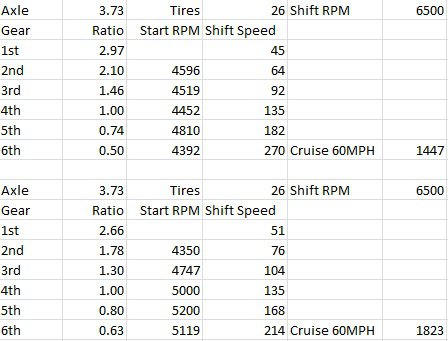

jpndave Posted December 24, 2014 Author Share Posted December 24, 2014 So this looks like a T56 Magnum (which is all T6060 internals) and additional upgrades depending on what options you selected with a Camaro T56 tail for fit. It looks like they all get upgraded bronze shift pads and carbon blocker rings 1-4. The level 5 gets a cryo treatment and REM polish. Does that sound about right? On 12/23/2014 at 11:25 PM, alainburon said: yes sir, that's it. On 12/23/2014 at 11:04 PM, jpndave said: Is this what you have here? http://www.tickperformance.com/t56-magnum-tr-6060-conversions/ Quote Link to comment Share on other sites More sharing options...
alainburon Posted December 24, 2014 Share Posted December 24, 2014 Yes sir, that sounds right. Quote Link to comment Share on other sites More sharing options...

jpndave Posted January 13, 2015 Author Share Posted January 13, 2015 (edited) I'm leaning toward the wide ratio because 1-4 are more evenly spaced and I would like a low RPM cruise for economy and comfort on the highway. I hate to admit this but I am seriously considering using a Ford engine in this project. I know it's like heresy to speak here, especially on this part of the forum, but that new Voodoo engine is really cool. It has both the sound and high RPM capability that I dearly love about the Z now. I may put a Coyote in it for now and in a couple of years when I can get a 5.2L Voodoo go that route. I haven't decided for sure. Already have a LS3 mock-up block and know that engine inside and out which makes the decision that much harder. I just can't get the sound and RPM I really want with the LS. Plus the way the engines deliver the power, the DOHC with VVT would work much better at having the high RPM with low cruise speed and hit better down low so the car isn't all over the place in the lower gears. Edited January 13, 2015 by jpndave Quote Link to comment Share on other sites More sharing options...
